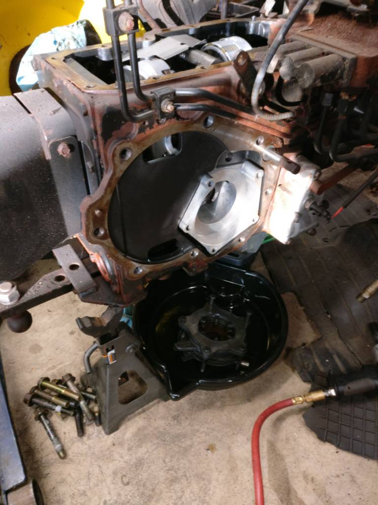

I have a 4300 and 4400 which should be similar. The brake packs are wet and housed in the left and right final drives. Does the brake linkage move freely? IMG_20170916_175947.jpg
