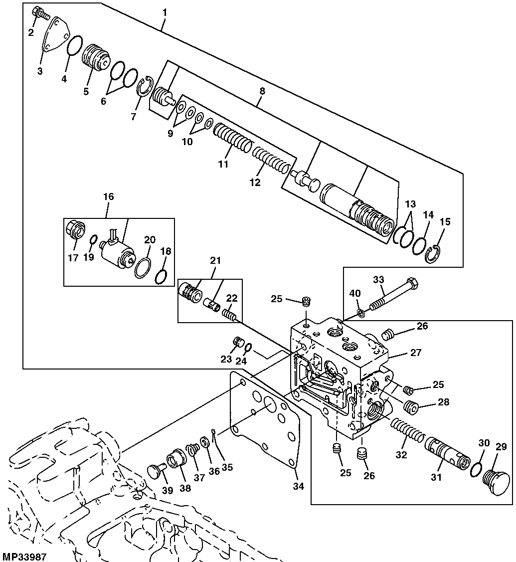

I had been shredding for a couple hours and then it quit. Pto on was in the status window.
2008 cab e-hydro.
Guess I be ec to break out the service manual.

Also both the rear and mid pto lights were on solid.
I don't even have a mid mount pto.
Any ideas?
D.

I suspect you have a wiring issue. possibly a loose ground. I suspect it is trying to ground out thru the mid pto indicator light. Check your wiring to the pto for damage.

An idea where the grounds are located?

I suppose you could check wiring on the pto control valve solenoid.

Wiring down there looks good. Didn't snag it on anything.
