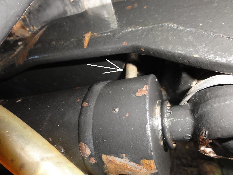

My new cylinder did come with new ball joints.
See the pin sticking out the side into the axle?
Be sure to measure this to confirm 8mm or whatever the diameter is when selecting.

What does the 8MM distance do ?
It's the diameter of that pin. Did you click to enlarge the photo?
It's a pin that is maybe 2" long and sticks thru a hole in the axle.
All I see is that it keeps the cylinder from rotating.
