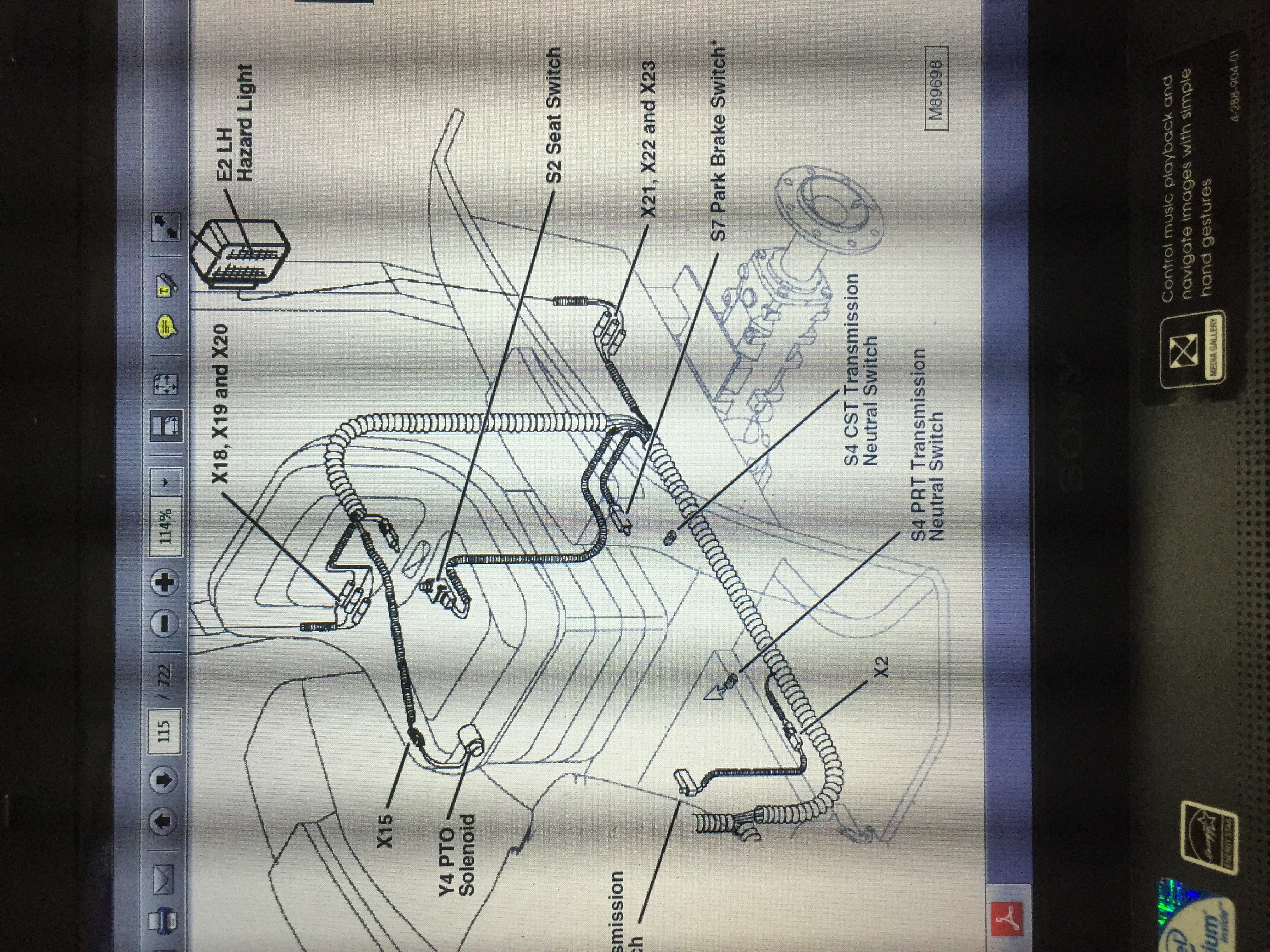

I have a 2000 JD 4600 that the squirrels chewed the pto wires where the harness travels over the rear end and drops into the pto solenoid. There are two wires that go to the solenoid connector and two that tee off to somewhere else.The problem is that it appears that they completely took the wire that goes to "somewhere else" and I can't seem to find where they should go. Ive tried searching for diagrams but I need someone to tell me the physical location to where the wires go. Any body have any ideas on how to remedy this? Thanks.

I have a PDF of the technical manual, it has all the wiring in it, shoot me your email if wanted

Two wires go to the seat switch. two are jumped together and the other two go to the pto solenoid.
   / John Deere 4600 PTO Wires! #4
image of wiring on tractor
