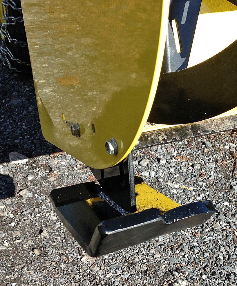

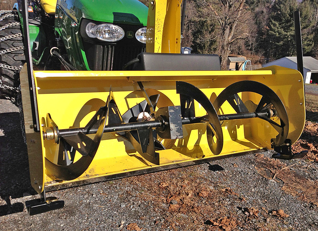

Hmmm... you have me puzzled. I have the 54" blower and I see those same instructions in my manual. Never noticed that before. I modified my shoes to make them wider so they didn't dig in as much on my gravel driveway. Mine are bolted in position-C and mounted on the inside. I see no reason why they cannot be bolted to any of the settings inside or out. Below is what my modified shoe looks like.
View attachment 349603 View attachment 349604
I was able to finally try the new skid shoes this weekend and I am not real happy with the way they worked. The ground still isn't quite frozen and they seemed to dig in. I'm going to look into something different.
