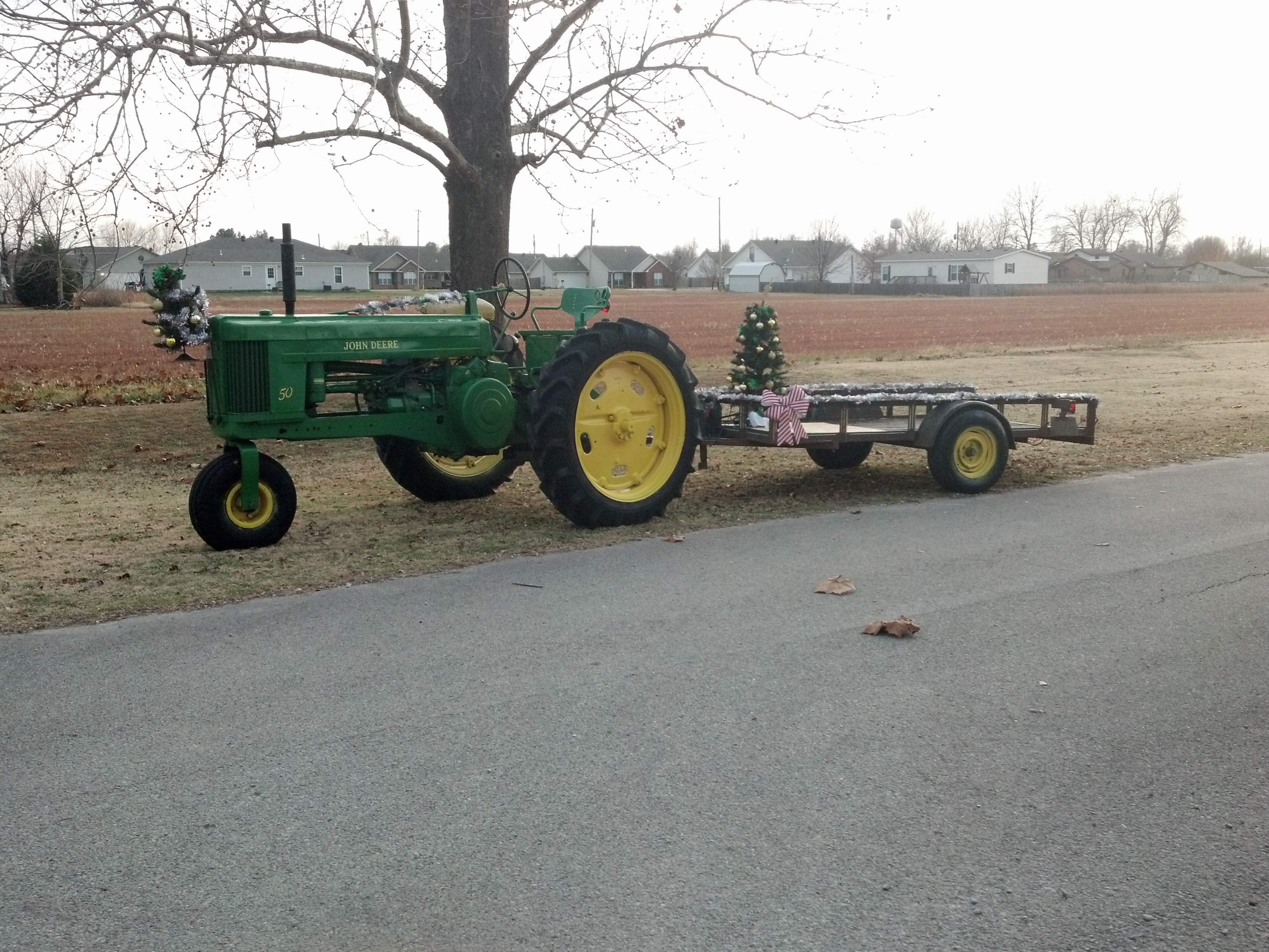

Here is our parade setup every thing went great. Thank for everyones help.
