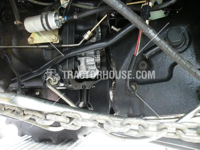

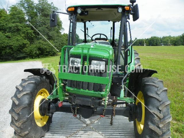

Ok, so I found this 5083e a while back and have been pondering on it quite a bit lately. They say that the housing is broken as shown in the picture and the windshield is broken, other than that the tractor looks fine to me. I realize there can be problems with the "guts" of it. What I'm wondering is if you could just weld the housing back and add some structural support around it. I tried to find out how much a new housing would cost, as I could get one and use it as a summer project learning curve. I would not be doing this by myself, I have a mechanic down the road that knows what he is doing beyond belief and I would try and get his help and do it in his shop and of course pay him. If I could do this at a reasonable price I may get it, fix it, and either sell it or keep it just as a secondary big tractor. You can never have to many tractors. If there are any thoughts or if you find out what part number the housing is, it would be a great help.
/ John Deere 5083e #2
I can't tell for sure which direction the picture was taken from. Is this the clutch housing($3,100) we are seeing broke or the transmission case ($2,300)? Prices is for Deere powered versions.

I think it is from the left side looking from the front towards the back right of the tractor if you were looking at it from the front of the machine. It says the housing under the cab is broken and if you look closely there are a couple of gears that aren't connect, so looks likes thats some more money too. The bottom one is just under halfway up the picture on the right break and the other is about a third of the way down on the left break. Thanks for the prices.
/ John Deere 5083e #4
I would say it's a big gamble, but if you can get it at a very good price may be worth it. What is the cause of the damage?

The tires look like it's got well over a 1000 hrs on it. Later

I just had to add some more comments. They got the chain holding it together. There is a return tube that is split in two. Other items are ripped apart there. This thing was way apart and I mean way apart and twisted and they come-a-longed it back together as best they could. Parts are jammed in there now. I wonder if some of the misc. parts gears etc. fell out when it split apart. Next they made a hospital move back to home maybe on a trailer but I doubt it. They probably did more damage internally getting back together and back home than the accident caused. There are some major gears and shafts plus the cracked housing that will needed replaced. Then you have the cab work, windshield, doors fit up etc. If this tractor has been setting outside getting wet then all of those pricey electronics in the dash are suspect. This looks like a money pit. It would be one of those things that you would keep fixing forever. Later

If I was to buy it I would offer some where around 5 to 7k. But I would put together a real parts list using the JD web site and get their pricing. In this estimate include all new hardware, shims, fluids, there maybe a harness involved, gears shafts bearing, housing, windshield glue for windshield etc. Do a rough estimate of the labor hours. Then you will have some info to bargain with. Some other info. You will need to pull the cab off to do the repairs. There is a lot of labor involved in this repair. To me that 20k number is way out of line. He is fishing. That is the reason it has been sitting. He may have already got the insurance money and he is seeing if he can better his deal by not fixing it and selling it out right. Last question, does the engine run? That's it no more. Later.
