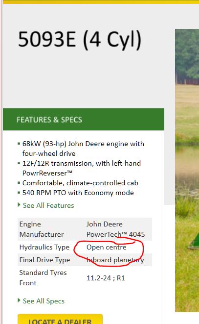

The aluminum hydraulic lines at the dual SCV's in the back of the tractor will get so hot I cannot hold them firmly for more than a couple of seconds after I've been mowing the pasture..He said that was normal and that the hydraulic system is a closed system and that the hydraulic fluid will get as hot as the transmission which is around 180 degrees F..
Your dealers service manager needs to do a little research(studying) as your tractor hydraulics is OPEN center not CLOSED center. If SM doesn't know which type hyd's your tractor has I wonder what else he doesn't know. I would like for this SM to explain if he thinks your hyd system is closed center what causes your tractor's hyd gear pump to stop pumping oil while engine is running PS: I'm a former JD dealer service manager myself and understand how both open & closed hyd systems operate.
