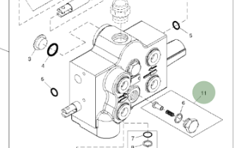

Remove plug #11 and check the poppet valve behind it. This is the load check valve. I ave found that a couple of these valves have gotten stuck in the bore. Be sure loader is on the ground before you remove the plug. The valve seems to tend to swell and get stuck. You can remover the valve and spring and then reinstall the threaded plug to test if it works then. Without the valve installed, loader will tend to leak down faster than normal most likely, but can be operated this way without a problem.

Thanks jd110. I think that may have been my problem. I removed the plug and the small spring and found what looks like hard rubber or plastic. I was expecting to see a poppet that was smaller in diameter that would allow me to pry on it to get it free for removal. What I see is black plug that looks like it is snug fit to the bore. It is not metal and I could not get to move at all. So it must be stuck and wondering what method to use to get it free and removed. I was thinking of drilling and tapping a hole where the spring went in the poppet and use a screw to pull it out. You have any suggestions?

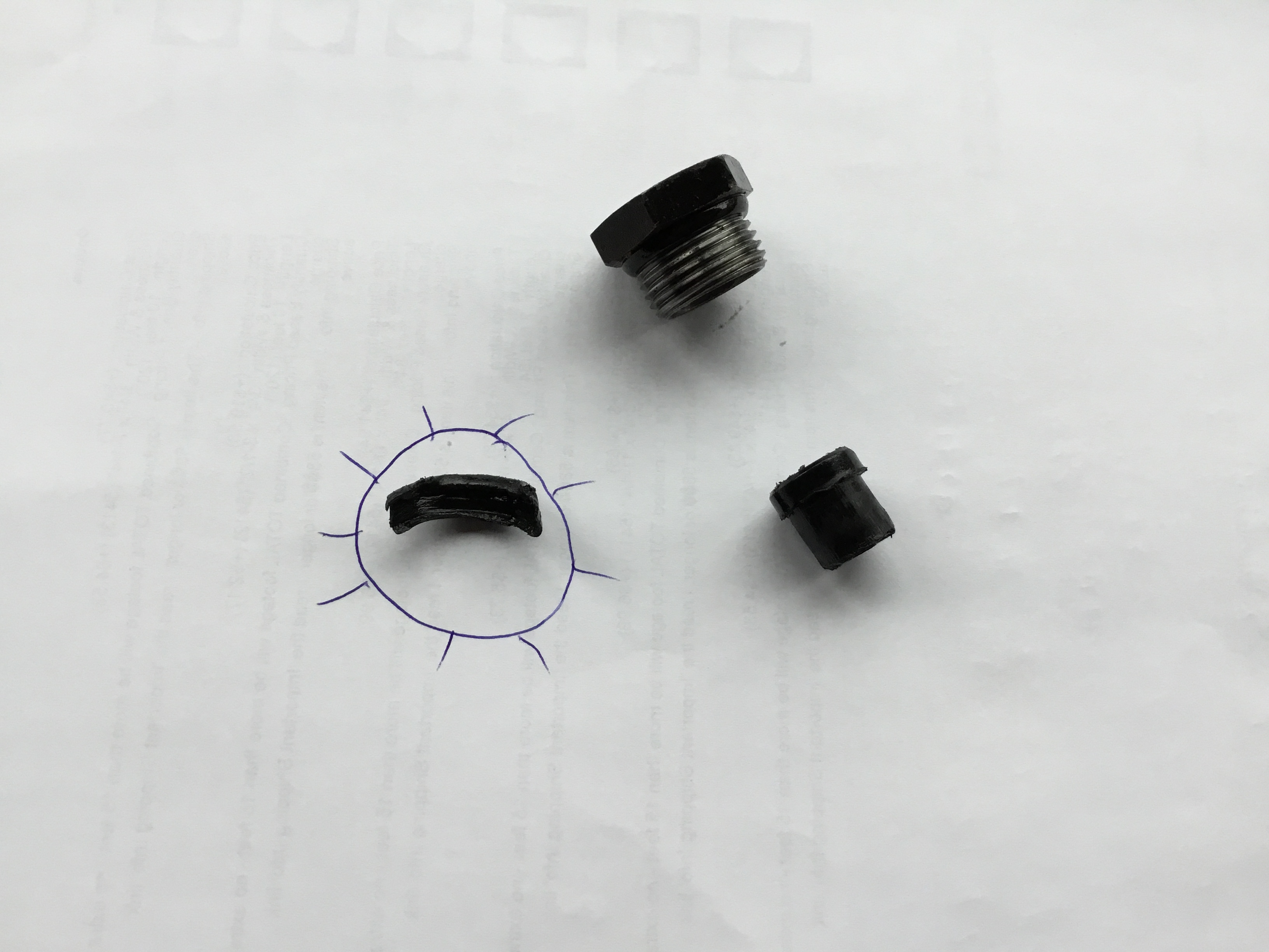

I plan on replacing the other one as well. One other question. The attached photo shows the damaged poppet and the threaded plug. The other piece was in a groove just behind the threaded portion in the DSCV. Once the poppet was removed I found what looks like 1/2 of a seal or guide for the poppet to slide in. The poppet was in pretty bad shape, but have not figured out if the piece that was in the groove is needed any longer. The new poppet seems to work.
Thanks again for all your help.
Larry
   / John Deere 5320 mid DSCV loader problem #8
There are no other parts shown in any diagrams in parts book or service manual. It may be a part of a seal from a cylinder packing of even a piece of the other poppet valve that has broken off.
