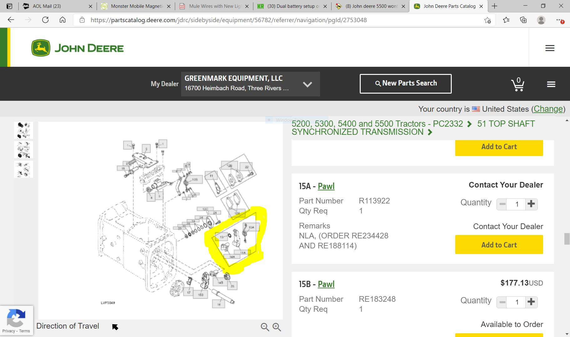

Park pawl could also be broken. This can happen if operator put the tractor in park when it is still moving/rolling.
   / John deere 5500 wont go in park
How would this be fixed?

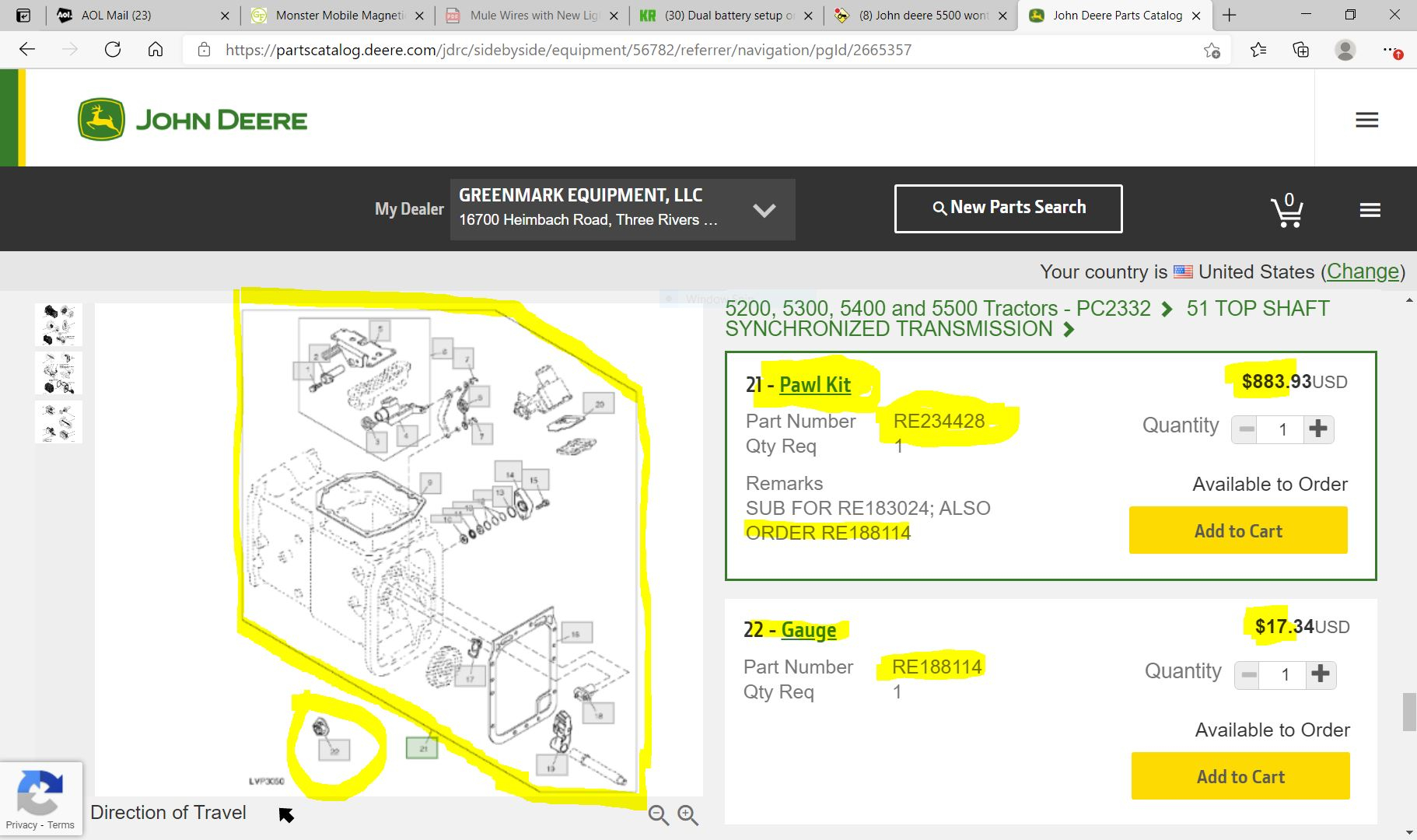

   / John deere 5500 wont go in park #8
Tractor split.
If you have older parts NLA
There is newer kit $900
#9
Tractor split.
If you have older parts NLA View attachment 692643There is newer kit $900View attachment 692644
Think we found problem today. So my lever won't go over to park. It's like something is stopping it. Took shifter out checked pins than took top off and found the long rod that shift in is locking the rod so it won't mover all the way over to park. A little ball popped out what is that piece called. When I moved the rod it felt like it was stuck so I rolled the rod felt a click and it released it to extend fully. Could someone messed it it and that little piece is backwards.
