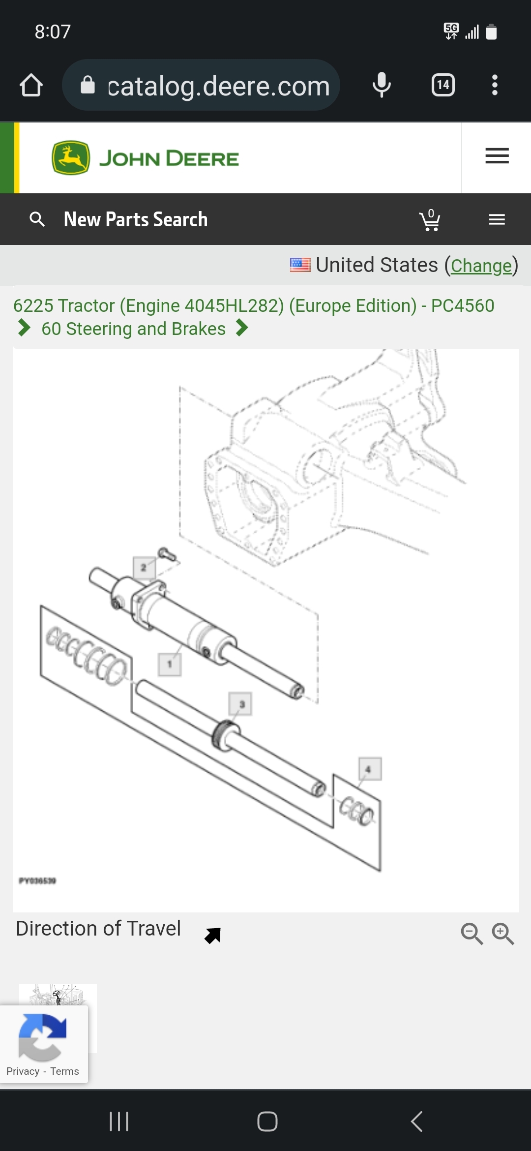

How to remove it the STEERING CYLINDER FRONT AXLE .... I want to replace the cylinder since i Have a spare and put it on the tractor . I Dont know how to remove it
   / JOHN DEERE 6225 MFWD POWER STEERING CYLINDER removal #4
Unbolt the 4 bolts and pull out of the axle. That is the cylinder.

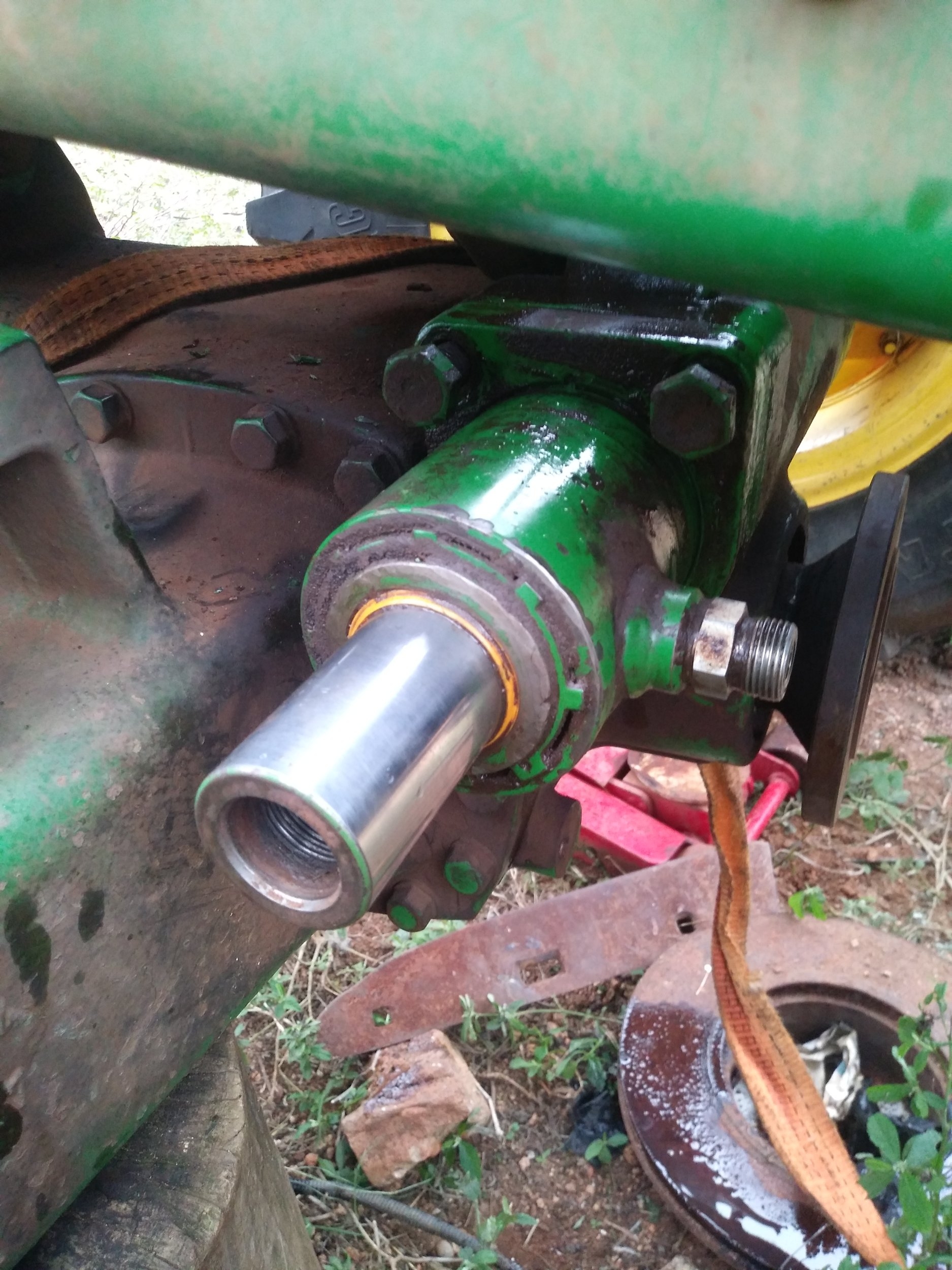

Yes i removed the bolts its supposed to come up on the left side. It is not coming out. I tried pulling out and pressing it on the right side to the left side.
It is just stucked in side the axle sleeve
   / JOHN DEERE 6225 MFWD POWER STEERING CYLINDER removal #7
Pretty much all it could be. Glad it came loose

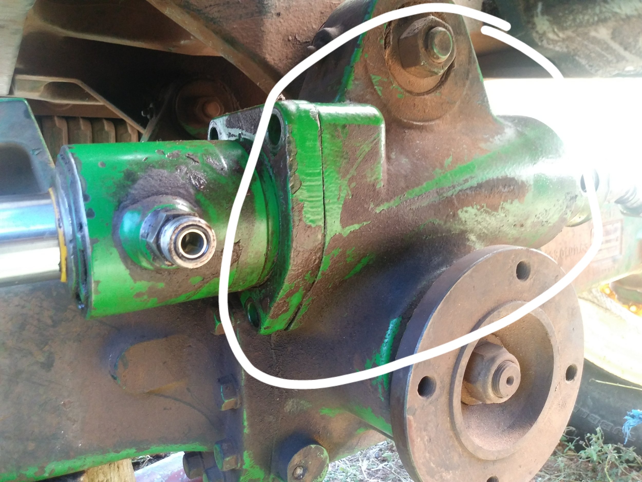

Please help it is stucked in there
   / JOHN DEERE 6225 MFWD POWER STEERING CYLINDER removal #9
Nothing but dirt and grit is holding it in there.
