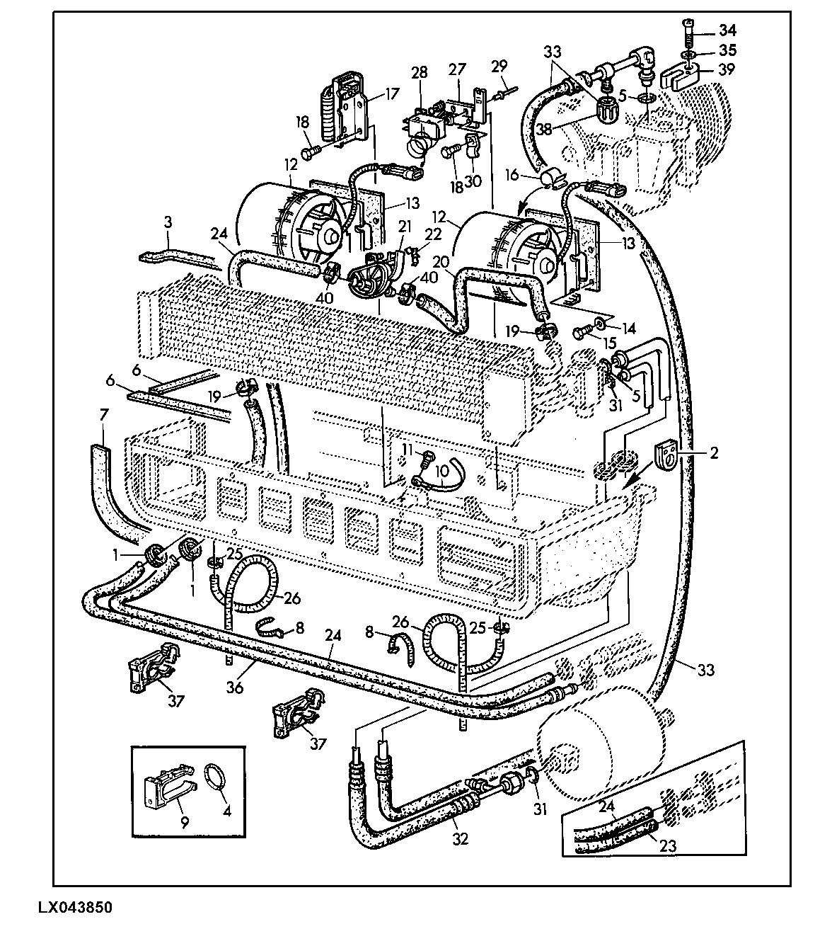

I need to connect a new heater hose back into the cab but dont know where it should end up, any ideas.
   / john deere 6300 heater hose #2
The heater hoses go into the bottom of the cab and into the heater box. You need to remove the seat and seat suspension assembly and then remove the plate under the seat to access it.
