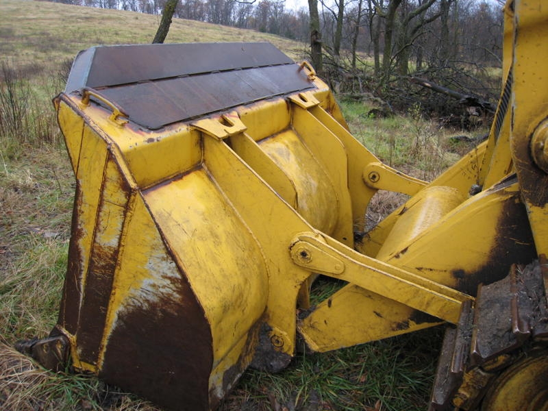

What size truck would you recommend? I don稚 have a CDL. How hard is it to get one? I would probably want a truck that I could move heavy equipment with. How large of a dump truck does it take to move a 40,000lb machine? What type of trailer hitch does a dump truck use for this task? I see them on the road all the time but never really thought about a dump trucks towing capacity.
The owner told me that it was used in construction. He has owned it the last 10 years and paid $30K for it. He has used it for farm use and has only had to do minor maintenance on it. He fixed a track tensioned and put a new oil cooler on it. According to him, this is all he has done to it in 10 years.
I don't want to get my hopes up too much, but I have talked to 3 people (all farmer types) about their long term dozer/loader maintenance costs and have been unbelievably amazed that none of them have had to do much of anything for maintenance.

for the relativly small amount of work you have outlined, you'd be better off renting a modern, known-reliable machine for a month or however long it may take. They will be glad to deliver it for you.
For the amount of work you are going to be doing, the last thing on my mind is going to be pin/bushing movement on boom and buucket linkages. a 7000 hour machine, especially an older one, in general, can be a constant money pit. little things here and there that go wrong can get really expensive when it comes to repairing heavy machinery.
I may be wrong, but it doesnt seem (by the tone and questions in your OP), that you are set up tool and equipment-wise to deal some repairs that may be associated with owning a mchine this large. machines that large almost require a 1-inch drive impact wrench, large sockets, torches, etc. taking off large heavy parts gets old if you are doing it by hand. The last thing you want to be doing it paying someone road-service rate to come out and fix your machine everytime something happens. I work in the heavy equipment repair industry, and know what costs what.
I think your best bet is rent a dozer for a month-$3000 or so. if it breaks, they fix it, or bring you a new one. Or rent the biggest tracaked skid steer you can. It will push like a dozer, lift like a loader, and carry any attachment you can imagine. crawler-loaders are an odd-duck in the equipment world-they're undercarriages are lighter duty than a dozer, but not quite as light as an excavator. they cant quite lift as much as a conventional loader, becuse of the way they steer and move. certainly a jack of all trades, but ceretainly a master of none.

My father owns an excavating company and over the years I helped him with many repairs of his equipment. One thing I can tell you is: find a good reputable mechanic who will help you with the machine that you choose with his help. The best guys to know are former machinsts who have retired and are always looking for a new challenge. We've had a couple and we've trade work or cash for their services.
Not all construction equipment will need major work and cost tons of money, but the reality is that some will. Design, operation and maintenance of the equiment decides that, and some things are just not apparent until they break. Seems like you have a good ceiling to the amount of money spent on maintenance, but a major failure will cost much more $$$.
BTW - most joints on construction equipment contain bushings that can be replaced. If not, the holes can be bored and new pins and bushings can be installed. Much cheaper than replacing the bucket or loader arms.
