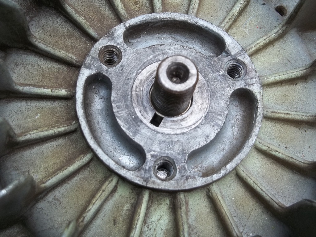

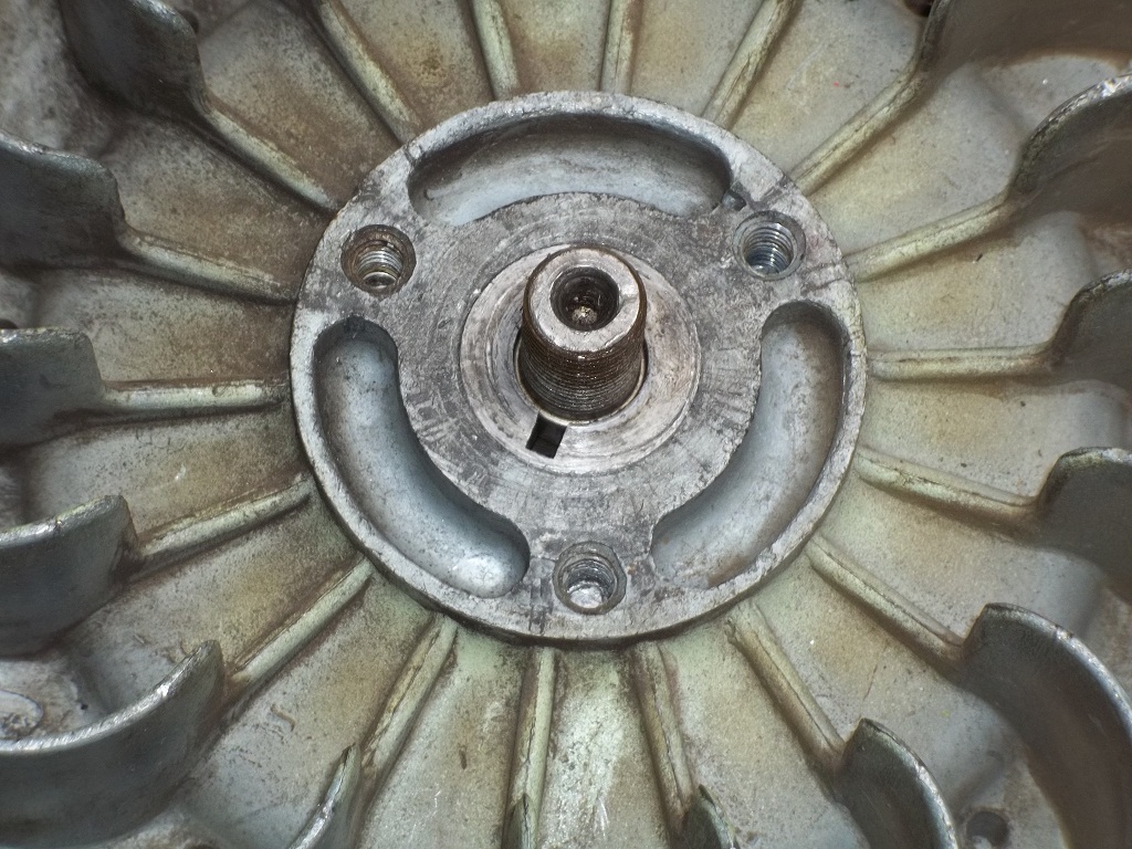

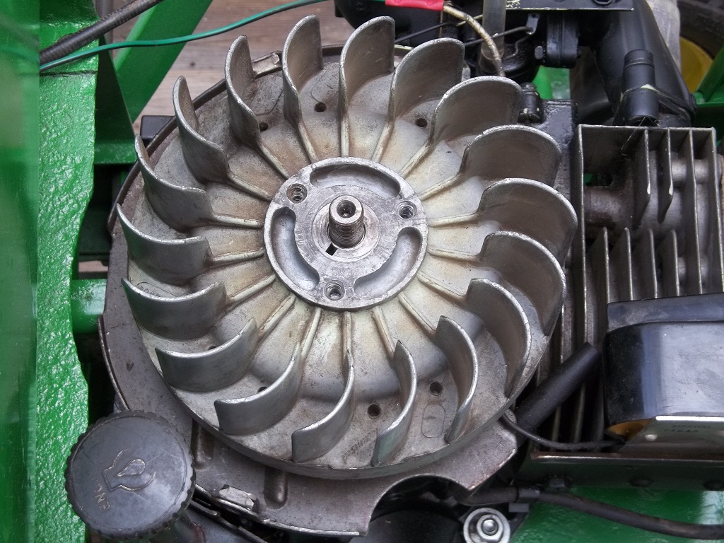

Hi guys....
I don't know what this parts' name is... Although I know what it does....
I'm very good with Engines... Although I'm NEW to it all since I never got to play with them when I was young. I'm always interested in them but since I was Poor growing up, I NEVER got a chance to play with them... Anyway, now I'm older... I get to play with them LOL...
The reason I said that I'm good with Engines is because all I have to take a look at Engines or Parts and BAM.... My brain goes miles a minute to understand what it does... Luckily I don't need a Manual or anything like that... I don't know how I do it sometimes... But it makes sense to me everytime I see something... Like I said maybe cause i'm Lucky or a gift I don't know about!
Well, there are Tricks and Tips that I DO NOT know about since that is NOT my specialty, and I'm sure you guys will come up with something...
Anyway, I want to take this part out to Clean it and Refurbished it. Also, i'm trying to Clean out the Magneto ( this one I know, LOL)... So my Lawn Tractor will start quickly... That's what my main goal, refurbished to get bigger Jolt / Alignment...
1. There is a Pin in there... I think it Broke half way... I think the Pin suppose to pull up but the previous owner my have Broke it, I dunno? I have taken some pix so maybe you guys can help me out, taking it out.
2. I think it's the best way to do is Drill it ( The PIN ), lift it up, clean it and then replace it... That's the plan... Maybe there is another way to take it out so I don't have to replace it. I hate going to the Store just for 1 part, LOL
3. What is this parts' name? = Flywheel, LOL
thank you for your help!

NEVERMIND !!! I got it off :D
   / John Deere 70 - Part Name and Help? #3
If that pin broke half way the engine is out of timing. Usually this happens when someone hits an object and the engine comes to an abrupt stop but the flywheel continues to turn. Replace the shear key if it is damaged and you are good to go. They make pullers for these of you may be able to carefully tap the shaft to loosen it.
   / John Deere 70 - Part Name and Help? #4
yup,the threaded holes are for use with a puller.
i have always done without the puller, use a very large
flat screwdriver or small pry bar, wedge it in under the flywheel
where you feel there is a good amount of material there to
support an impact (on both the flywheel and block)
once you have some "up" pressure (on both sides is preferred)
give the end of the crankshaft a tap (brass hammer is best)
and usually that flywheel "pops" right off the tapered
crankshaft.
as others have said, replace a broken or damaged keystock
because that is important to the engine "timing".
have fun!
:D
