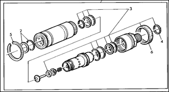

My knowledge of JD tractors built after '92 is limited. Have you checked stand-by pressure? According to Tractordata pressure should be 2900 psi. Does your tractor have breakaway similar to photo? If so I wonder if an internal o-ring could be leaking letting pressure leak by inside coupler? If tractor was mine I might be tempted to install older type breakaway coupler that one had to slide collar rearward to connect/disconnect hoses.

No I haven't checked the standby pressure. I don't have a gauge but if it's just a simple hydraulic pressure gauge with a quick disconnect, I could make one (steal the pressure gauge from my log splitter). Just plug it in to each port, bottom out the lever and read the gauge? The couplers are built into a housing and not screwed on like the one in your picture. I can buy a rebuild kit for them that contains all the internal parts.
One more hint I can give is that I can physically hold the hoses/connectors in while someone in the cab operates the levers and all is good. And no, I'm not superman. :)
