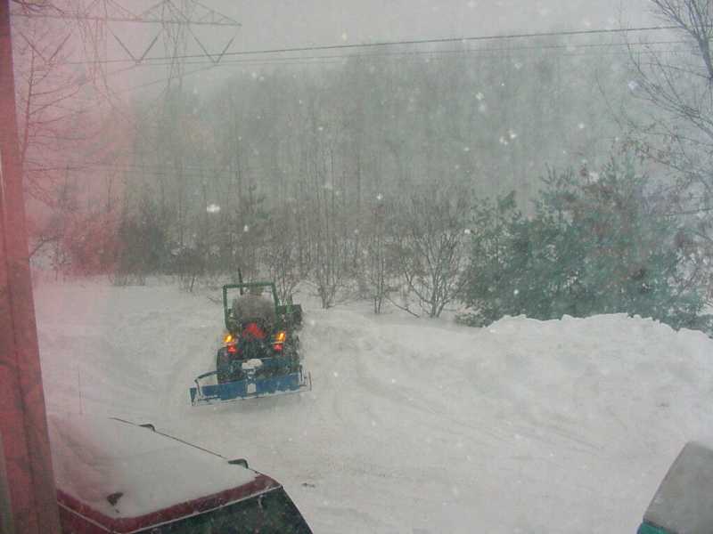

I think you'll be happy with that 770. I second what Rob said about using a rear blade for snow removal. Attached pic shows the 670 in action after a blizzard (30" of snow) a few years back. I do most of the snow plowing w/ the blade. The loader is used for pulling snow back from the garage doors and (as shown in the picture) moving snow to allow more plowing. BTW, I'm just south east of York, PA so we get close to the same accumulations unless you're in southern MD.
The transmission is a collarshift, and no...you really need to stop to shift. However, for snow removal, 1st and Reverse high range work good,. The gears are in line, so shifting is pretty quick. Quick as a hydro? No, but within a second or two.
So, what other tasks do you have planned for this tractor?
