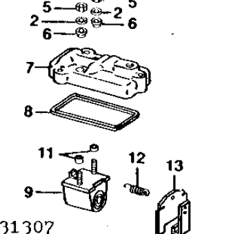

I tried hooking up a battery charger to the tractor to see if it was a voltage problem but it still does the same thing. Im not sure how the shut off works on these tractors there is no selonoid on the out side of the pump like on a piston pump this tractor has a rotary pump. The lift pump is leaking is leaking but it is pumping could this be the problem that it is not pumping enough fuel?
   / John Deere 820 wont run. #14
banditman
Which IP does our tractor have? Here's a parts photo of 1 the Roosamaster IP electric solenoids(parts key 9)

It has the roosamaster injection pump
   / John Deere 820 wont run. #16
If the lift pump is leaking I would change it out, about $40 from NAPA iirc. I would check for 12 volts to the terminal wire on the injector pump and ground. I would use a meter to determine whether the 12 volts is constant to the solenoid when the engine dies. A 12volt test lamp probe could be substituted if you don't have a meter and should glow when the ignition switch is turned on and should stay lit while in place.
