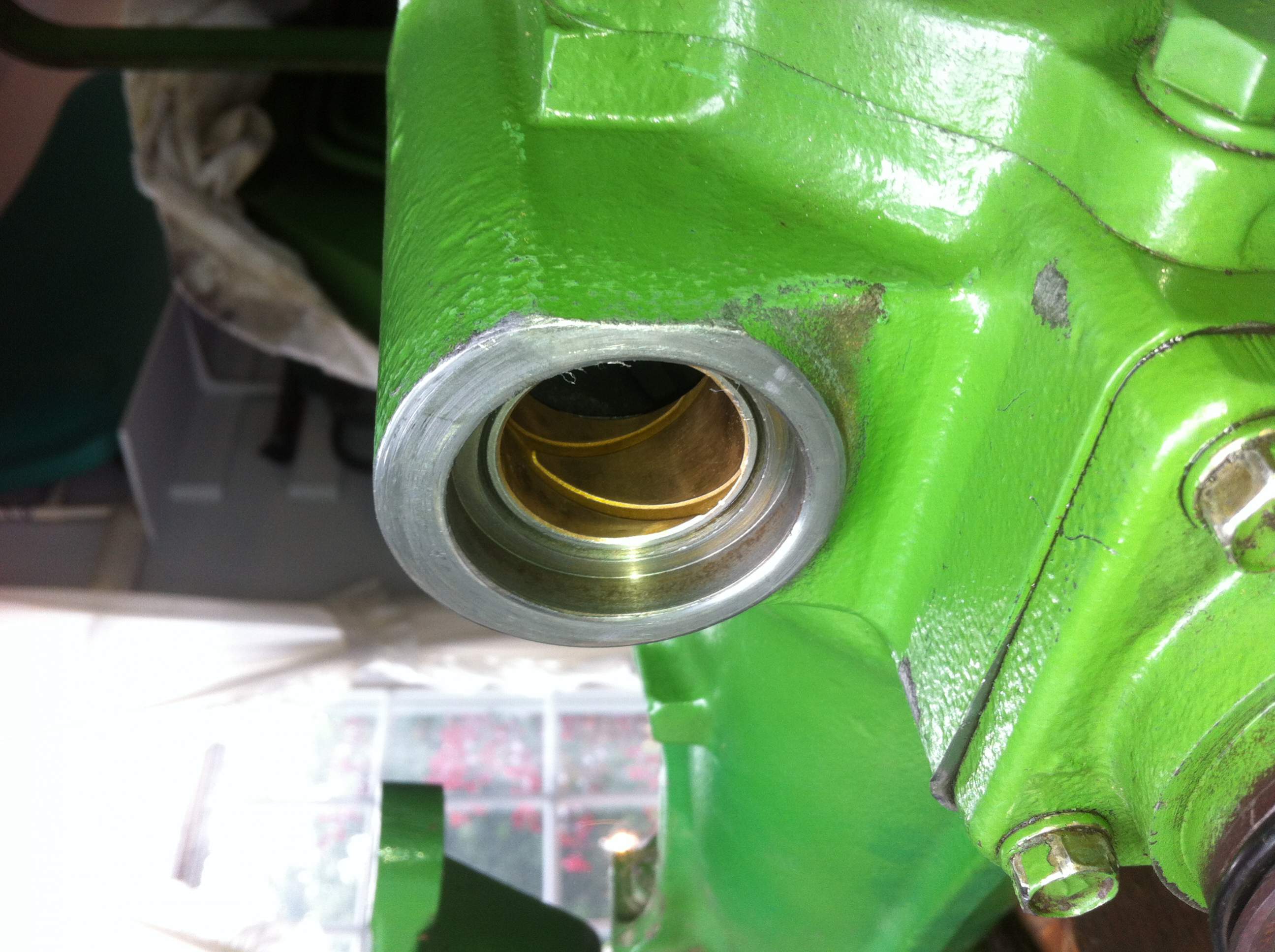

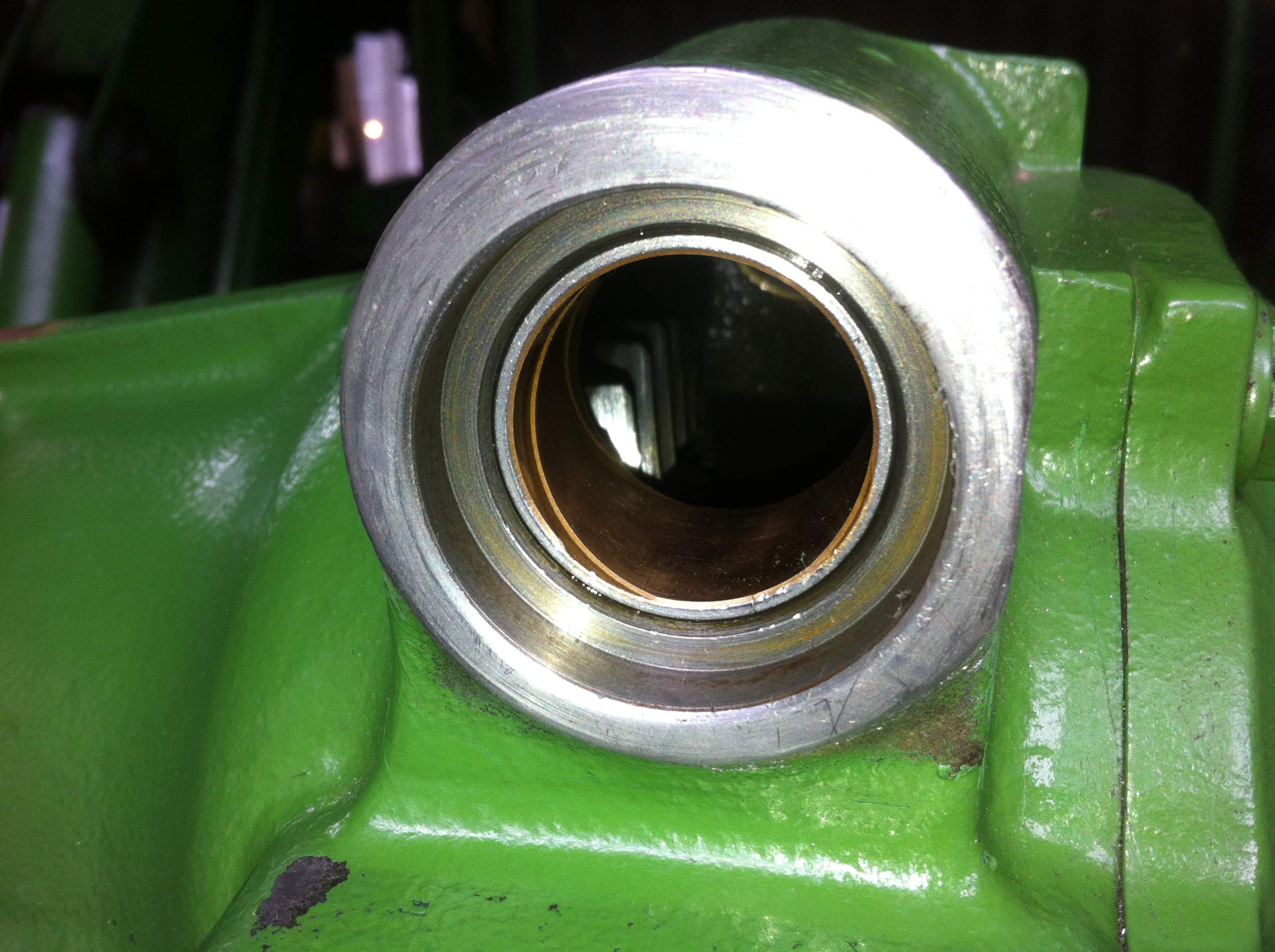

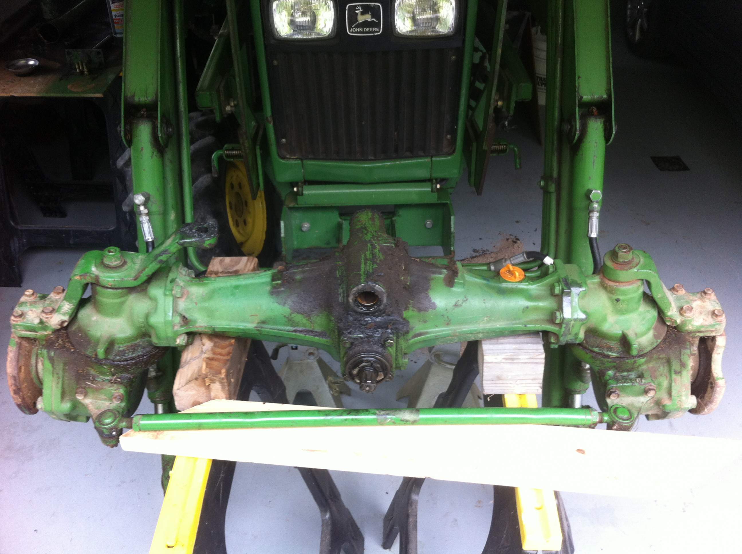

I'm having trouble locating the two bronze bushings that are pressed into the axle pivot. Has anyone done this repair yet or can recommend where to get the bushing because John Deere says NLA (go figure). Any help is always greatly appreciated.
   / John Deere 850 MFWD Axle repair #2
Try Hoyetractor.com or there is Jamieson tractor in Pa(570-253-4810) The tractor is 100% Yanmar . Just a guess,but it probably uses a APB-4312 bushing. You will probably have to measure it.
Awesome. Will try them in the morning. Thanks!
Just an fyi for anyone looking for John Deere part # CH14637. I found them at Schweissguth Bros. in Missouri. Phone # 636-433-2256. They were reasonable with price too and had 1 of them in-stock when I called.
