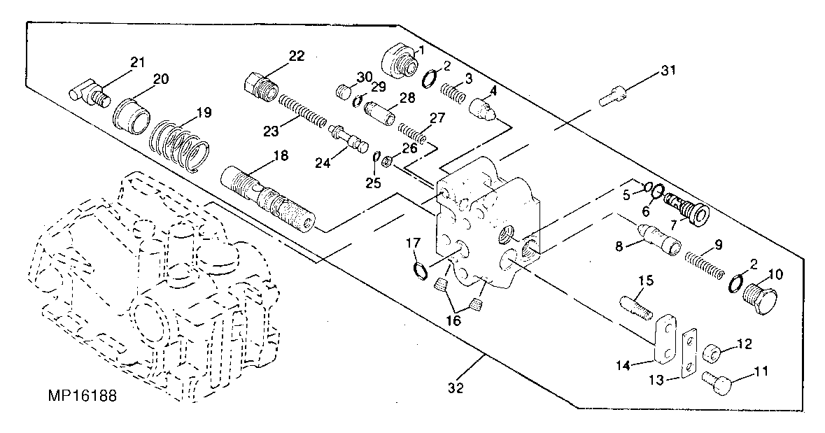

Hi, New member here.
I have a John Deere 955 that the rear lift arms will not raise, even with nothing on them. The rest of the hydraulic system seems to be working correctly, the front end loader works fine. Suction screen is clean and it is full of oil. The draft lever moves through the full range with no resistance. Where might I start to look to repair this.
Thank you

Walt,
When was the last time the 3 pt. was working ? I think, the 955 only has one pump located in the front right side, at least those with out a loader.
With the loader i don't believe there is anymore than the one pump. But as I sated, I'm not well versed in hydraulics. The way it sounds, it don't appear
you are getting flow to the 3 point. Is the fluid good, meaning no contamination, such as water giving it a whitish color.
It can't be air as the pump is self priming , and the screen is not clogged as you stated in your original post.

Walt,
This is what I have for you, hopefully someone will be of more help.
Here are some possible causes
Lift does not rise.
Insufficient engine speed
Insuficient transmission oil
Air leak through suction piping
Clogged suction filter
Maladjusted relief valve
Stuck sequential valve spool
Broken control valve
Broken slow-return check valve
Also, it could be the following:
You have one of two things wrong. A quick coupler isn't connected correctly. They can look like they are and not be. The other thing that it could be is one of your hydraulic levers. If one of the levers is not centering it can direct the flow so that the lift won't work. This can be the loader valve or the valve used for your T & T. Move these valves around and try the lift again. If this doesn't work, then take your quick couplers apart and reconnect them.

   / John Deere 955 rear lift arms will not raise #8
If other hyd function operate correctly then I would suspect loose control linkage or a stuck valve or maybe a broken spring.
#9
Finally got to dig into this problem and found that the flow control spool in the Rock shaft control valve was stuck. Cleaned out the valve and freed up the spool and everything works fine.
