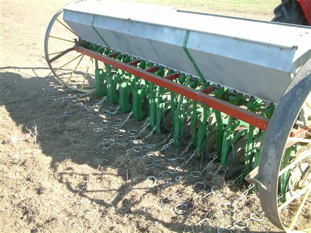

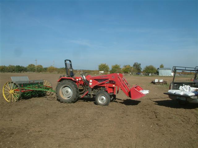

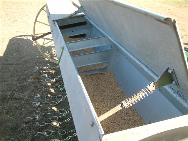

I restored an old Minneapolis Moline P3-6 grain drill (10 ft wide, 20 drops, single disc openers) a few years ago. Use it to plant oats.

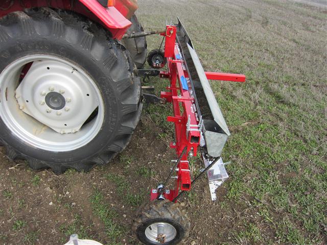

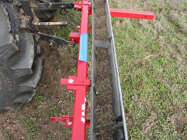

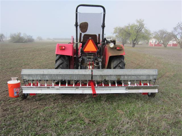

I used the two JD grass seeder boxes that came with the drill to make a drop seeder that I use to seed the hayfield with cover crop (lana vetch-ryegrass mix).
I welded up a frame to attach to the 3pt hitch on my 2008 Mahindra 5525. Added the grass boxes, drive wheels/chain/axles, and a pair of two-bounce seed chutes to spread the seed uniformly in a lateral line about 10-ft wide.

Flusher, nice job on both. How much did you spend on the drop seeder versus buying a 3 point spreader?
View attachment 249079View attachment 249080View attachment 249081View attachment 249082

How are you getting good ground to seed contact? Are you dragging after spreading the seed?

Use a 10 ft wide cultipacker to press the seed into the soil.
My old 10 ft wide Minneapolis Moline P3-6 drill has two large boxes (5 ft wide) for fertilizer, large size seed or a mix of both and two small 5 ft wide grass seed boxes. Modern grain drills come with more boxes and a more advanced design for spreading seed and fertilizer.

I have about $300 in parts for that drop seeder.
