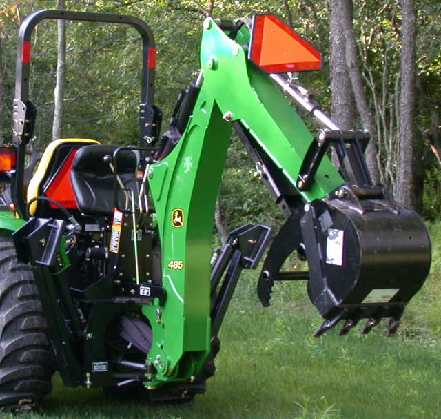

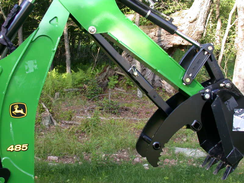

The 485 replaced the 48 hoe if I remember, check your specs, it seems to me they're the same hoe. The 375 weighs less maybe that's what you're seeing.
Anyway the 485 is a decent hoe, I have one on my 3320. If you get the 18" bucket you can also get the thumb which meshes with the 18" bucket.
For small plantings like fruit trees or digging trenches I like the 12" bucket although the 18" is a good all around bucket for the hardpan we have here. If you're in soft soil or sand and have to move a lot of material the larger buckets might be better for you. I wouldn't go with the 36" bucket unless I was working very soft soil, it's just too big. I can dig a 4 foot square hole pretty quickly in hardpan with the 18" bucket and I find it a good size for rocks too.
What do you plan on doing with it?
Rob

I really like my hydraulic thumb. It is about 3-4x as pricey as a mechanical thumb, but much more versatile.
You are right, it is for grasping objects, think rocks, logs, big stuff that it is hard for a man to lift or even move sometimes. With a little practice, it can place objects with some finesse.
My thumb stays on and the QA buckets are changed.
With an 18" bucket and a thumb, I have picked up objects ranging from a 1000 lb chunk of retaining wall to put into a dumpster down to half-basketball sized rocks. Of course it works best on things in between these size extremes.
   / John Deere backhoe model confusion #8
The thumb is an option (~900 bucks). It can only be ordered with the 2010 485 hoe or newer and is specified for the 18" bucket because it meshes with it. You can buy the bucket and add the thumb later if the cost is too high.
Sounds like the 18" bucket is a good choice for you, that's the type of stuff I do with it.
