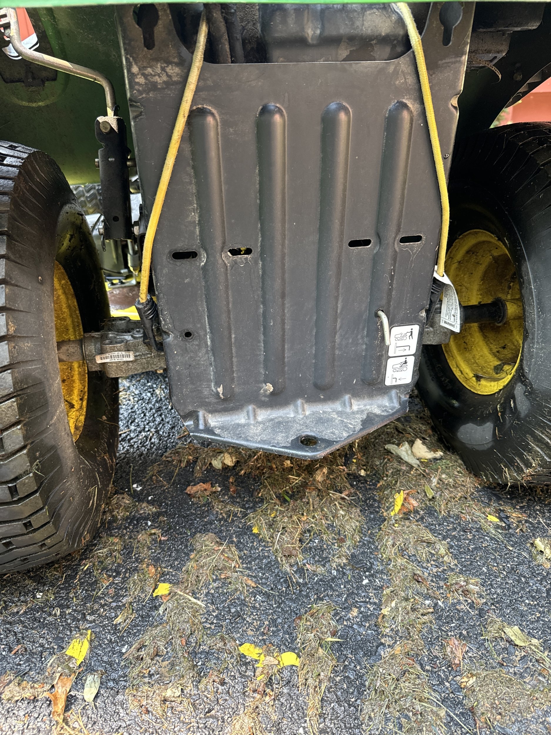

My D-130 started acting up about a year ago. Fuel gage would read full but engine would surge for a few minutes and eventually die. Lots of troubleshooting and thought it was clogs, filter or bad fuel line… which lead me to the screwed up tank design.
Wife drives like mario andretti on this thing to get the chores done. I kept noticing when the tank was almost half empty it would start sputtering. Looked under seat and saw the tank was cocked.. probably from all the bouncing she does whipping around. Re-seated the rear part of the tank(bottom outside corners) and she would run great for a few weeks. Oh by the way… gas indicator became accurate once more. Few weeks later same issue.
Finally got tired of hearing the: I DONT drive fast B.S. and knew i had to do something to fool proof. I took a bungi cord from the frame outer rear case on both sides and wrapped it around the hump on black hump that surrounds the gas cap. This keeps the tank seated on rear mounts.
Note: gas gage still works albeit a little slower due to the counter pressure of the bungi cord. If its a little sticky, lightly giggle to get it to work accurately. I fill the tank each time we mow, so not to worried about it. As you mow, the bouncing keeps it accurate anyway.
Bottom line: BAD - Cheap design by JD.
Note: route cord under fuel lines to prevent collapsing.
