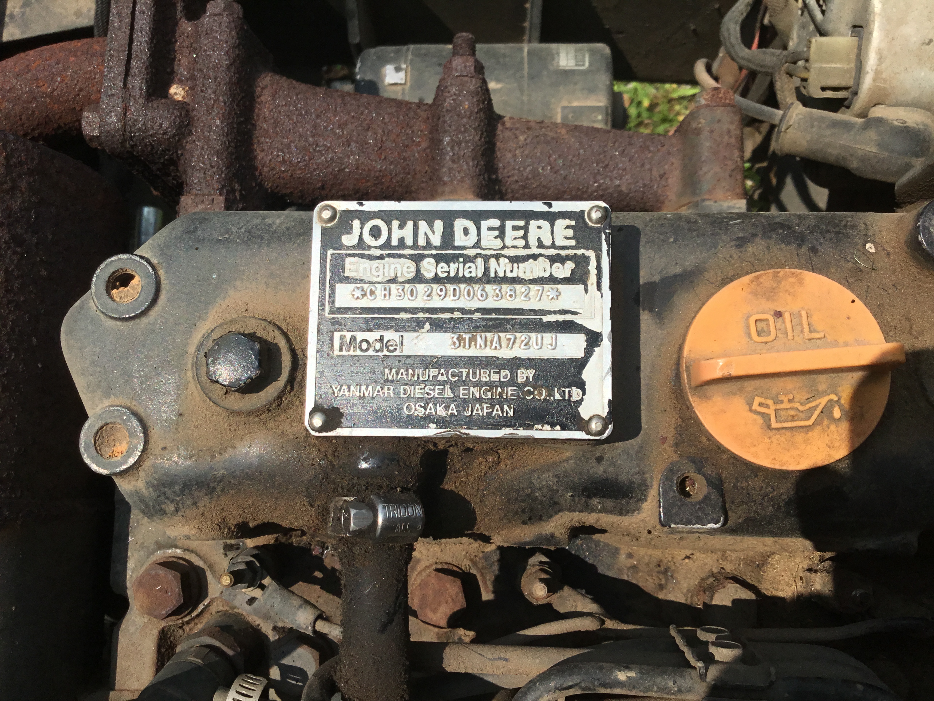

our family has a John Deere F935 that came with our house and has a bunch of problems. Park-Brake doesn’t work, Cruise Control Doesn’t work, The right wheel brakes Barely work, the external hydraulic quick connects don’t work, the steering pillar leaks Hydraulic fluid, the fuel meter only reads from one side of the tank, and a whole lot more. But the worst one is, The PTO doesn’t work. When you engage the PTO, the blades start to spin, and then the engine dies. We know the blades aren’t jammed, and we know the PTO brake isn’t stuck on. This is pretty important to get fixed again, as if we can’t get this working, our little 20HP husquvarna is going to have to take care of 5 1/2 acres. Plus, it’s the only thing with a snowplow. I don’t want to have to shovel a 1/4 mile driveway again this winter. Any help is appreciated. Wire diagrams, questions, “is X working” are all appreciated
If you need any serial numbers or anything, just ask. 371D2790-7870-43B6-9C05-33F47AFFF124.jpegFFB26DB0-4542-44BD-B2D6-560BB277A071.jpeg

Just a wild guess on the pto, one or more safety switches is setting shutting it down. ???
   / John Deere F935 And a whole list of problems. #4
sounds like a safety switch to me too, I have a PDF of the tech manual you're welcome to, if wanted

Parking brake telling the control module its set, even though its not. PTO band brake sensor out of position. Sounds like hour meter is over 1,000,000 ! Mine is pretty old but still a great machine. I the motor runs, it's not the seat switch.

Still not sure what it is. Park-brake sensor works, seat sensor works, and PTO switch works. What else could it be? I fixed the seat switch and now the PTO brake isnt engaged, but when I push in the PTO engage in, the fuel solenoid still kills the engine!
