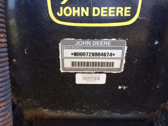

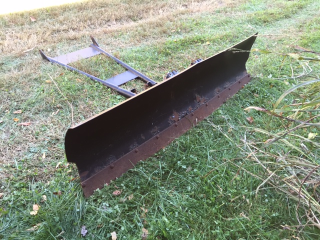

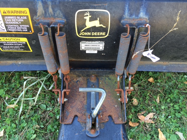

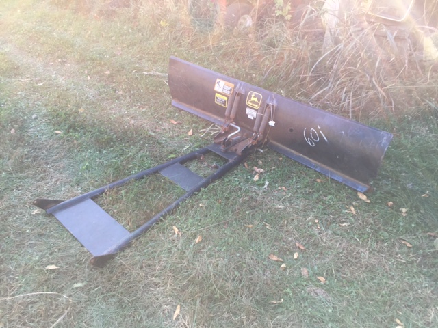

Can anyone give me some details on this snow plow? I picked it up at an auction because I thought I got a good price on it, but don't really know much about it. I figured it would fit a Gator since it's a six foot plow. What models would it fit and what is it worth? Thanks for the help.

The moldboards are all pretty much the same it was the lift frame that would be different. One for current xuv's, one for original xuv's, and one for the tx,tx 2wd gators. Probably a slight difference in ear width and overall length. So should be easy to make work on any gator but will still need the hyd lift kit if you want down pressure otherwise use a winch or an atv blade lift kit.
