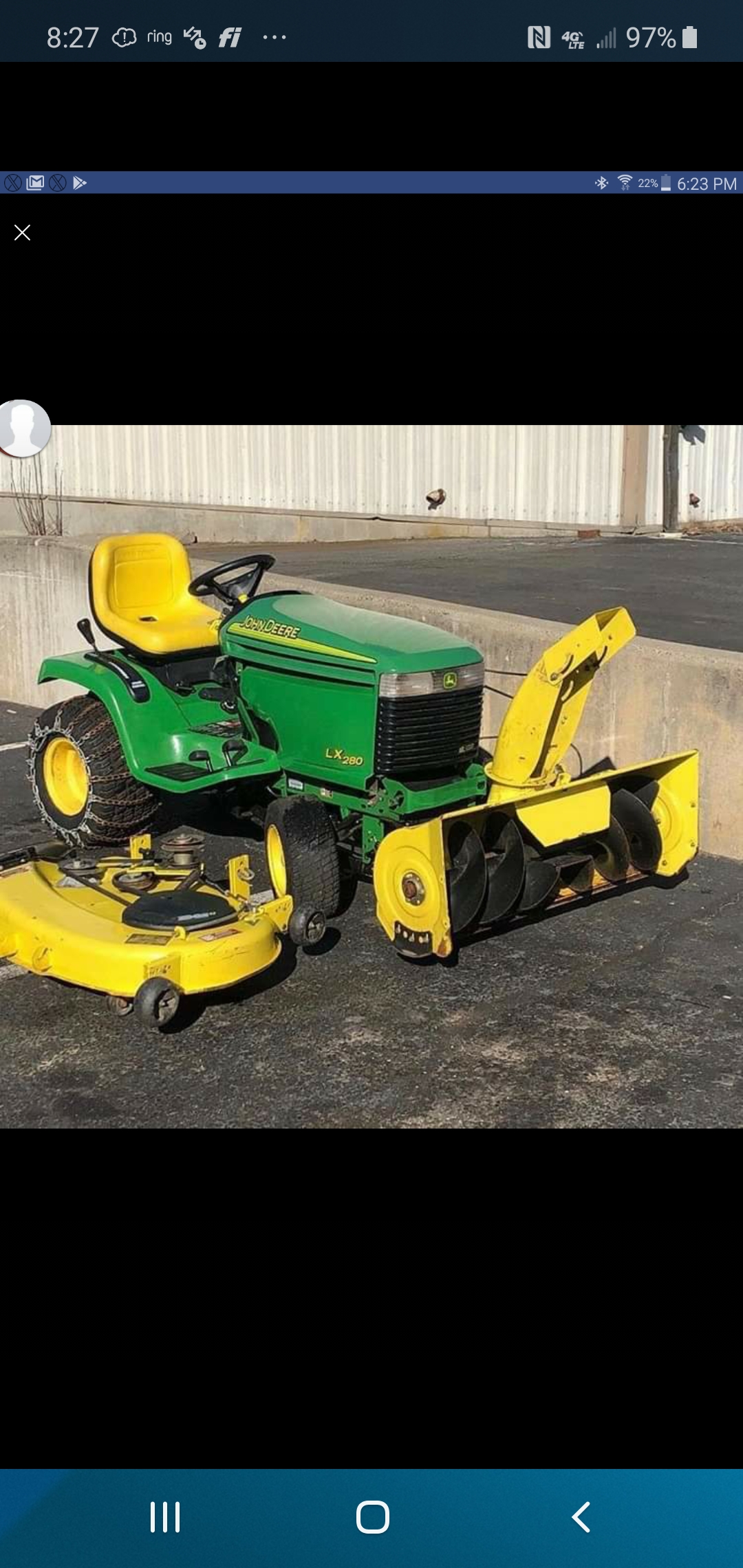

Hi All,
Long time lurker, first time poster.
I bought an 2005 LX-280 1.5 years ago from a commercial dealer who took it as a trade-in. The first picture is outside at the dealer. It had 243 hours and was pretty clean overall although the hood had a crack near the front lower left which I fixed with Loctite plastic bonder. It came with the mower deck, a 42" single stage blower that was pretty ratty, chains, and 4 suitcase weights. I paid $1,200 and spent considerable time sanding and repainting the blower. I bought it strictly for the snow blower as I have upwards of 2/10 of a mile worth of flat paved driveway. Over the summer, I did ALL of the maintenance, oil, grease, filters, fluids, etc.
So it sat for all of last season as we had no measurable snow and may an inch or 2 of slush which it refused to blow. I modified the blower by adding flexible rubber belting to the impellers to close the 1/4" gap between the impellers and the chute housing and that fixed the slush problem. I also swapped out the incandescent headlight bulbs for LED's, and added a 36 watt LED combo flood/spot to the front of the blower housing.

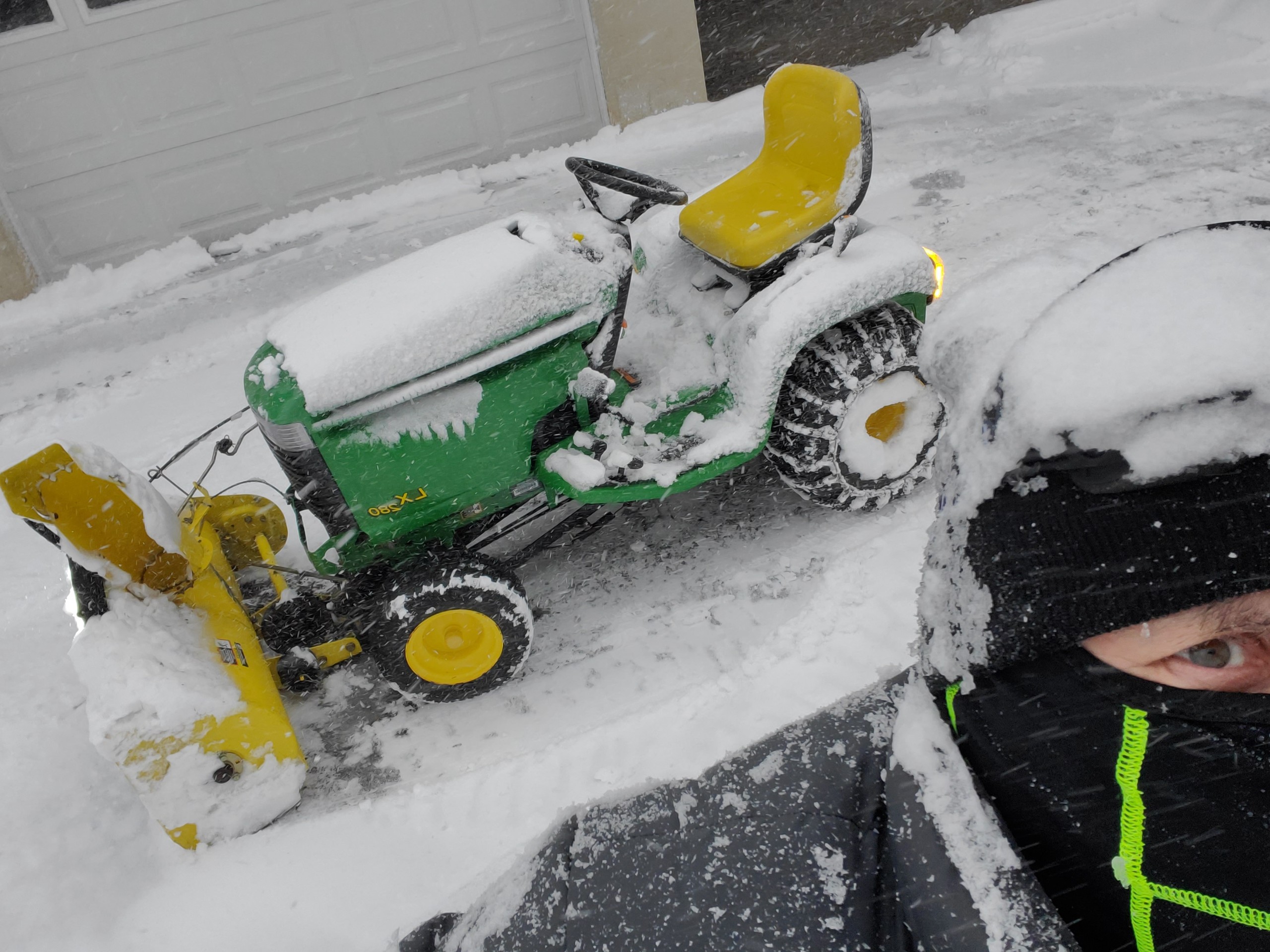

Yesterday we had 18+" of snow starting out as powder which became wet, heavy, and sticky after dark. The machine is a beast and I love it. I went out at around 10" of powder and it blasted through it with a 15' to 20' through. The second pass was 8+" of very wet snow and 2' tall piles of plow sh*t out by the street. Never an issue or a groan and it powered through it all using a very low speed forward motion.
So the question I have is as follows; when I engage the PTO I sometimes smell the belt which in my mind means there is some slip. Is this a normal occurrence or ??? I do keep spare belts for the blower and drive just in case but I'm wondering if this smell is normal or is there possibly an issue I need to address.
Also, how often does the electric PTO fail, just wondering if I should keep a spare along with the rest of the spares? Thoughts on any of this are appreciated.
Lyle

PTO clutches do get replaced from time to time, not to where you should stock an extra though. Most machines will die with the one it was born with. In regards to the rubber smell, you seem to notice it only after the PTO is engaged- then nothing? If it is real brief like that, I wouldn't call it abnormal. Remember that clutch doesn't have a soft start and basically goes from 0-60 quickly. Ideally a snow thrower or any other implement creates a sudden load. Things you can do is verify the belt and tension is good and that you start the blower before entering the snow. Use your PTO feature that allows you to operate the blower while reversing. That will cut down on constantly engaging the belt and the shock load that goes with. Welcome to the forum.

Thanks for your respone. Never knew there was an option to keep the PTO engaged in reverse. Any idea where I can find info on this?
Lyle
   / John Deere LX-280 #6
I think on yours you just slightly pull back on the PTO switch as you depress the reverse pedal. Either that or there is a yellow button to push on the dash. It is commonly referred to as MIR or a mow in reverse feature.
   / John Deere LX-280
Thanks for the ideas. No yellow button so I'll give the pull back a try.
