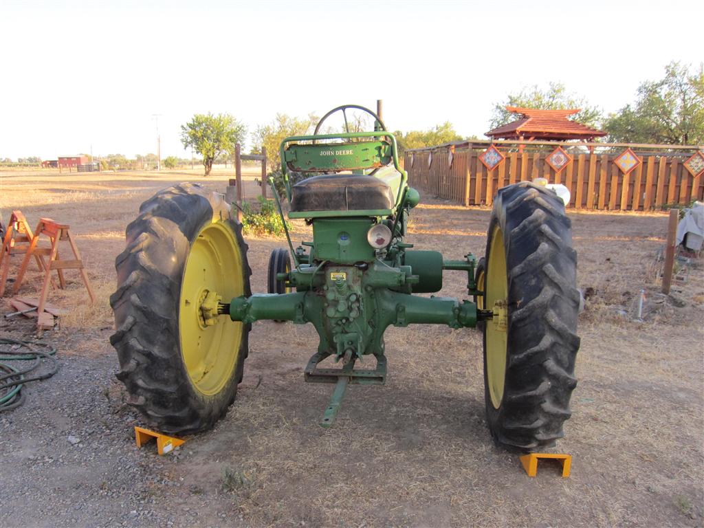

My 1948 JD B has a rockshaft that can be used to operate a true 3-pt hitch. YOu can find these on eBay for $500-700 or build your own hitch. Just be sure that the B you're eyeballing has a rockshaft. Some of the older B's (late 1930s, early 1940s) did not come with rockshafts.

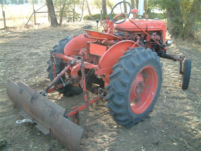

My 1951 Farmall Super A normally came with the Farmall two-point hitch. My Super A has been retrofitted with a true 3-point hitch by Caltrans, the former owner.
Good luck
