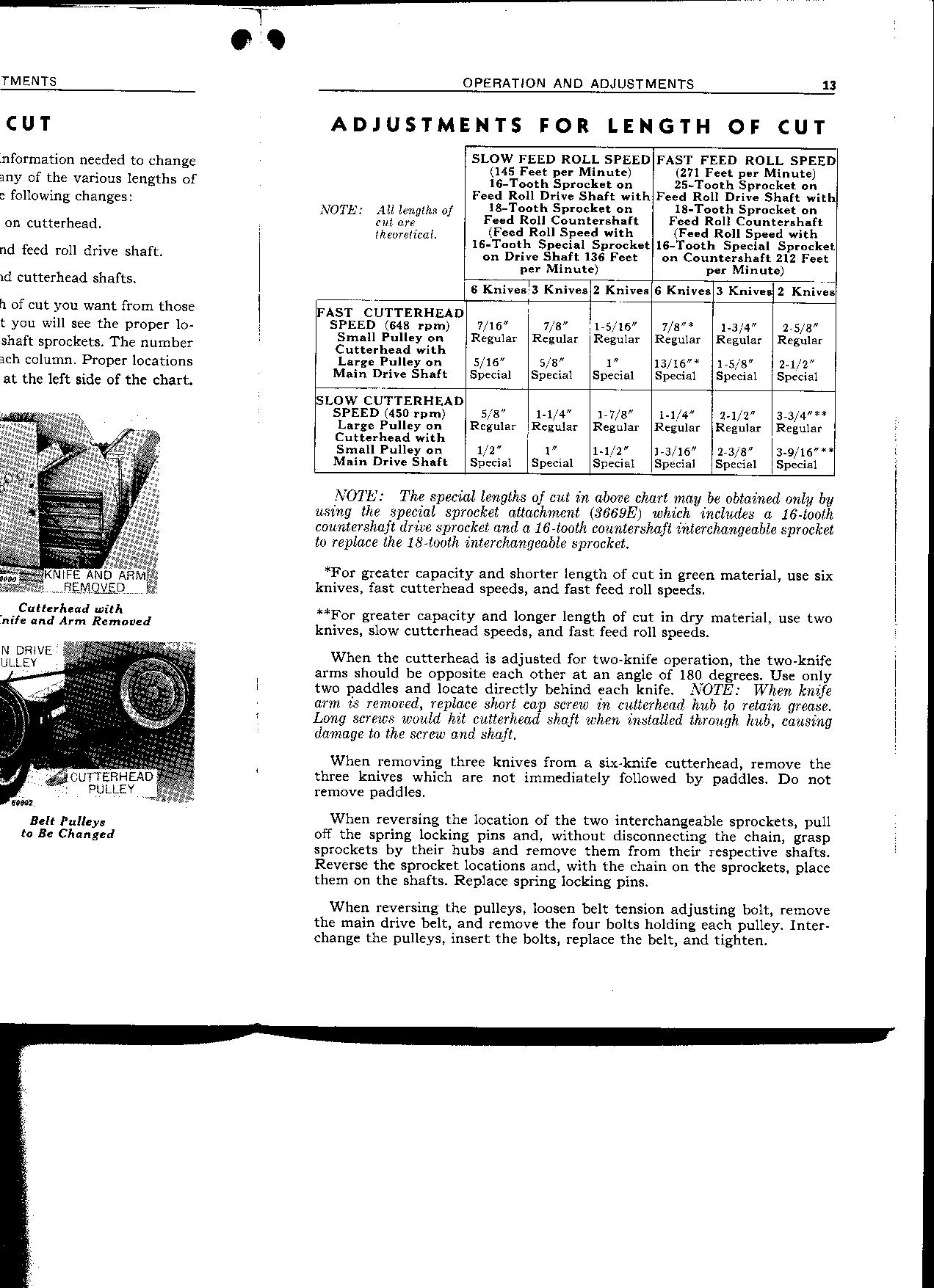

I have attached a scan from my JD No. 8 operator's manual which shows adjustments for length of cut. The 8 was an earlier model than the 6. John Deere replaced the 8 with the 6 and 12. The 6 was the lighter duty model while the 12 was the heavy duty model.
