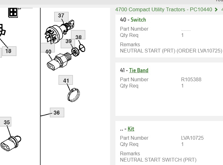

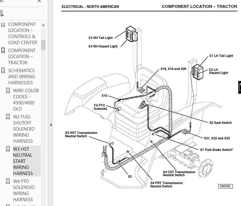

Service tech manual for 4700 has this page for location of the neutral safety switches, and maybe can help you locate yours.
From jd parts, shows the neutral switch kit and part no.

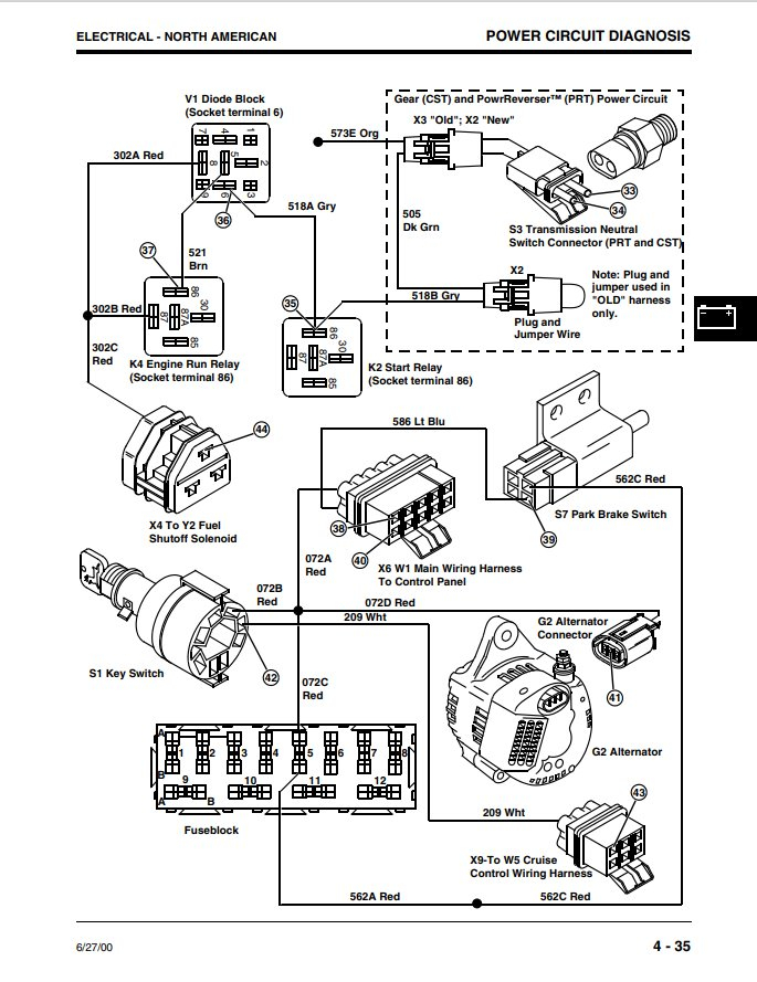

   / John Deere Power Reverser won't Start #5
I posted the schematic page here, in case that helps......
Does the Service/Tech Manual say if the neutral switch is adjustable? As in add or remove shims? If not, I would check the connection. If that's OK, replace the neutral start switch.
