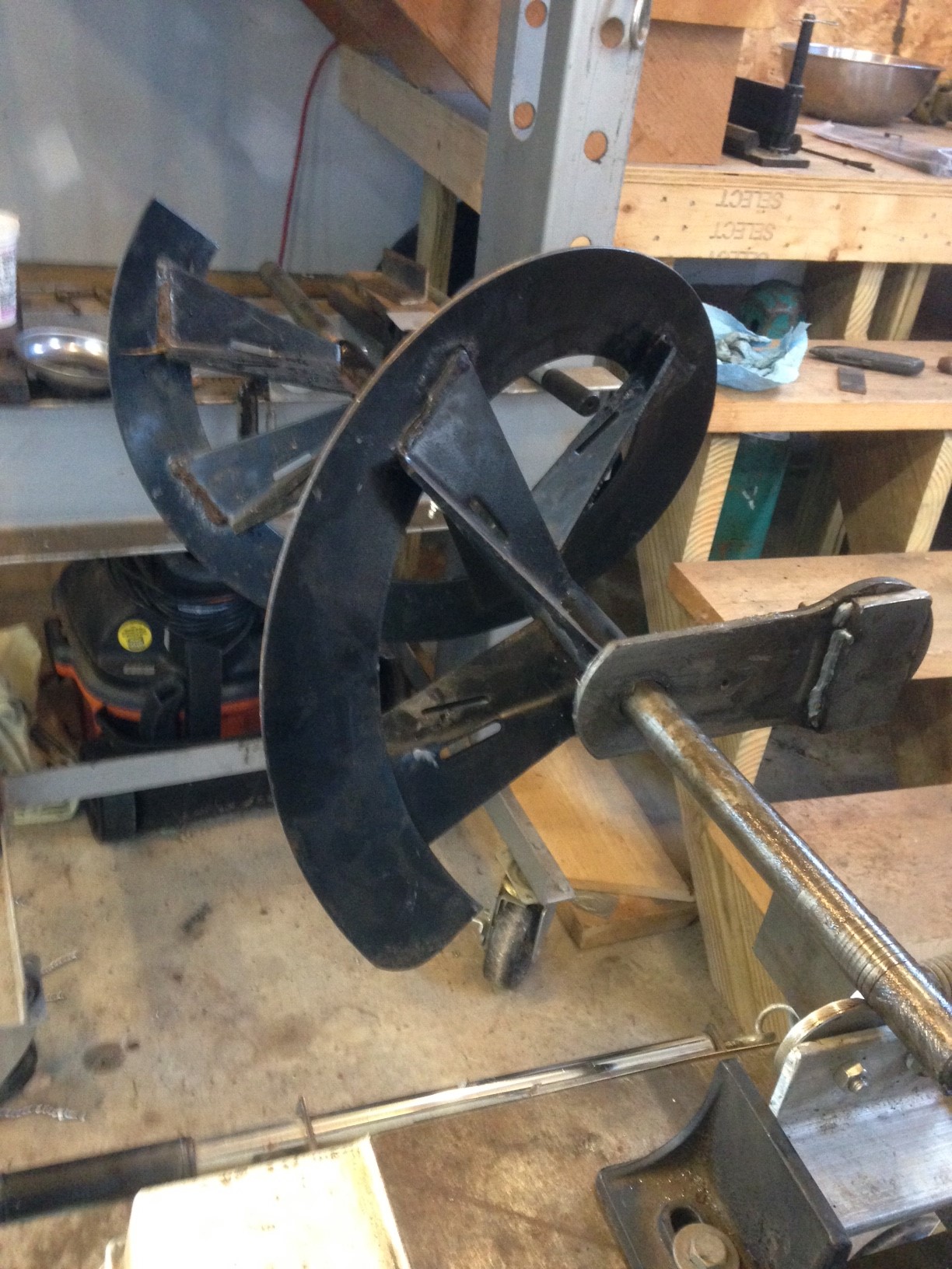

I recently did a custom front mount of the very common 47" John Deere quick-hitch snowblower on my Yanmar 186D. In doing some research on this snow blower I found a few references to vibration issues, some from the excessive u-joint angles that Deere corrected with a CV shaft and others clearly related to the augers, a side to side wobble most noticeable when the blower was raised. Given that, and my previous project balancing my rear mount blower, I decided it wouldn't be much work and would be worth while to take the blower apart and balance everything, change the gear oil, check on all the bearings and overall condition of the used blower.
It was a good thing I did. I found all the bearings were less than perfect and one on the end of the auger shaft was loose and the inner race had been spinning on the shaft and had worn it about a 32nd of an inch. I did a weld build up on the shaft and chucked it up in the lathe and turned it back down. It was my first time turning something 4' long, so I made a bushing for the far end of the headstock to keep the shaft from whipping around, worked great.
To get to the point, what I found on balancing the augers made perfect sense. Basically the impellers may have been designed to be statically balanced when combined but each is grossly imbalanced opposite of each other. When spinning the ends vibrate opposite of each other and the thus the wobble. The shaft spins slow so it's not really a big deal but the bearings have to go through the cyclic loading unnecessarily. I only took a pic of one of the augers, this one is the longer one (the impeller is off center). You can see in this pic about 3" of 2"x3/8" flat bar added onto the stock counterweight. There was roughly 2" more on the back side of the counterweight that you can't see.
The other impeller the counterweight was in the totally wrong place. I could've cut it off, but instead I just added some weight to a flighting support on the opposite side, about as much as the other.

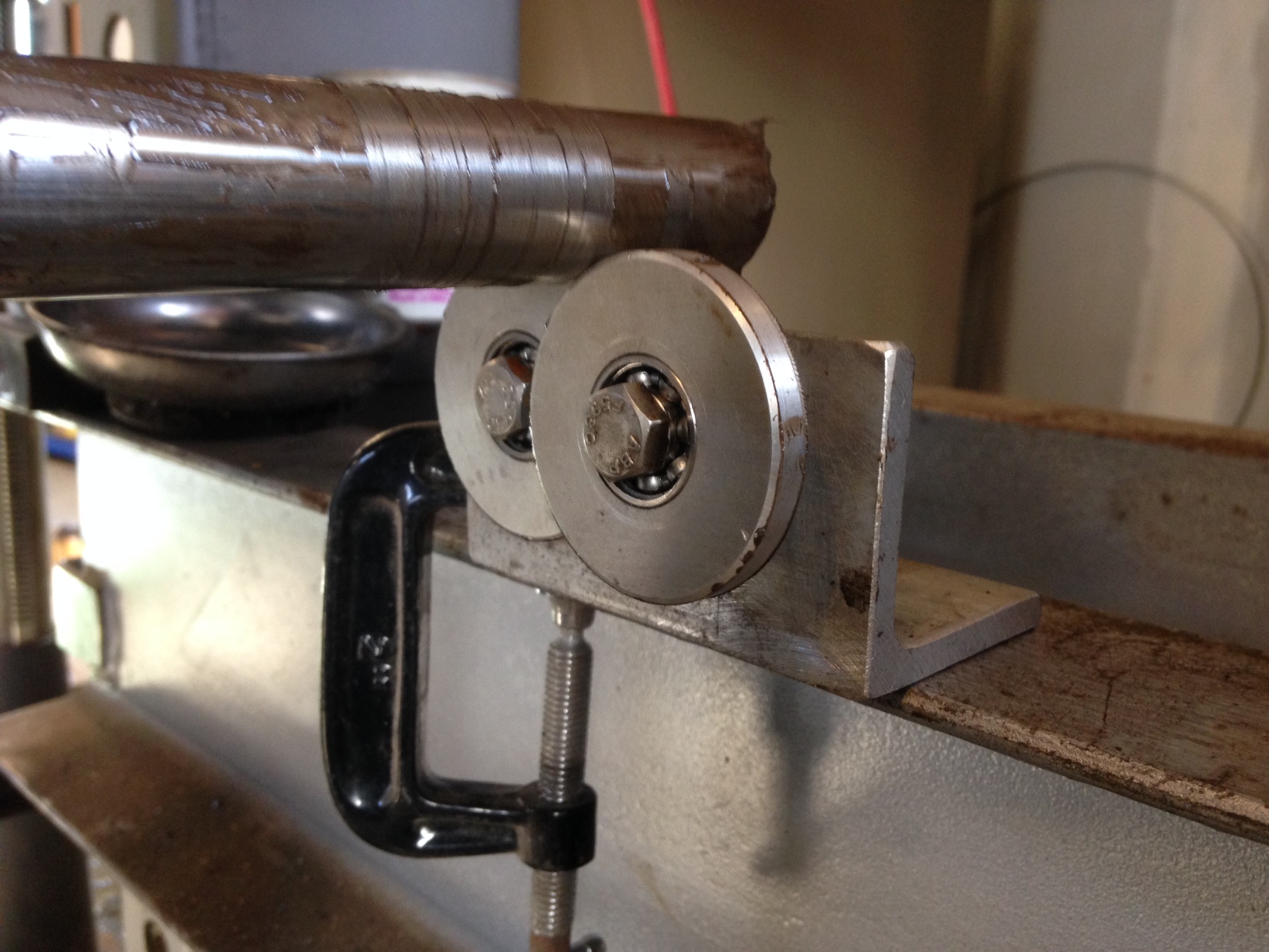

Here's a closeup of my balancing rig, well half of it. A couple of common small bearings pressed into larger aluminum discs to reduce friction. Seals and grease removed from bearings and replaced with a light oil. Needs a shaft to fit whatever you are balancing. All the Deere stuff is 1" so had it laying around. Could've used the Deere shaft itself but it was a little pitted and had keyways cut out of it. Ignore all the grease. Previous owner apparently loved grease fittings and anti-seize but didn't know how to take care of bearings.
This method on my impeller can pick up pretty small changes in weight. A 1/4" nut placed on one of the impeller blades after it was balanced would cause rotation. The impeller by the way had some vibration for sure but nothing too bad. The blades were just stitch welded to the hub plate so first I filled in between the welds on the light blade. That wasn't quite enough so I added a couple of inches of weld on the opposite side as well.

Dave, thanks for your interest and no offense taken. I think both I and JD would agree that this balance of the augers is not critical. Your guess was close, by spec the augers spin around 250 rpm IIRC. What has been a common compliant on the newer models is the side to side wobble, and as mentioned what I found is what you describe...that being, the augers appear have been designed to be somewhat statically balanced when combined, but each end individually was grossly out of balance in an opposing manner. I would concur with you that my static balance was not anywhere near the end result of a dynamic balance, but I expect when I get my bearings in the mail and reassemble I will have solved the side to side wobble as at the very least I have halved the error by balancing two individual sections of auger instead of 1 long assembly. In other words, I think I proved that my blower was already in the situation you described and my symptom of the side to side wobble will be reduced.
With regard to the impeller, this front mount blower by spec spins at 950 rpm, and I'm running it more like 1050 rpm so we are in 100% agreement that this is where things are really critical. As mentioned I had much less work to do in this area and only added 3" or so of weld bead. The impeller is much less shaft like then the auger, so I think the static balance will prove quite effective. It did on my rear snowblower, which while designed to run at 540 rpm I ran at 1000 rpm for a few seconds just to test the balance and it ran as smooth as silk. I think even 1000 rpm in small shafting is not considered high speed with regard to the need for precision balancing.
