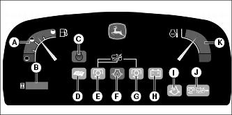

A warning came light on today and I have no idea what it means. It's right above the service light. The light is red and looks like a bulb of some sort with a squiggly line in it.
I checked the online owners manual but for some reason it doesn't label that light.
Any ideas? Let me know if you need me to attach an image of where the light is.

You can post a pic.
My X485 manual shows a light there, but no explanation what it is for.
Maybe someone has the tech manual and can pick that one off the wiring schematic.
   / John Deere x485 Riding Mower Warning Light #3

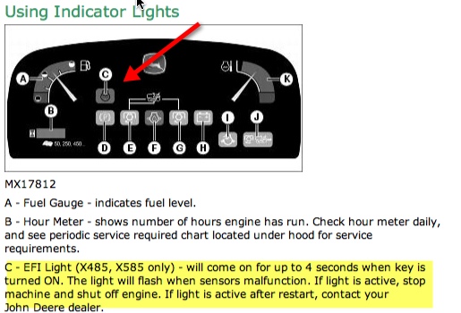

Is the light that is marked C ? If it is you have a sensor on the engine that is going out. Doesn't mean a particular sensor but I think it does pertain to the EFI system. Good Luck!
OK I found out its the EFI light.....I was mowing all day and was low on fuel when I noticed the light flashing. I filled her up, and hasn't come on since. We will have to see.
