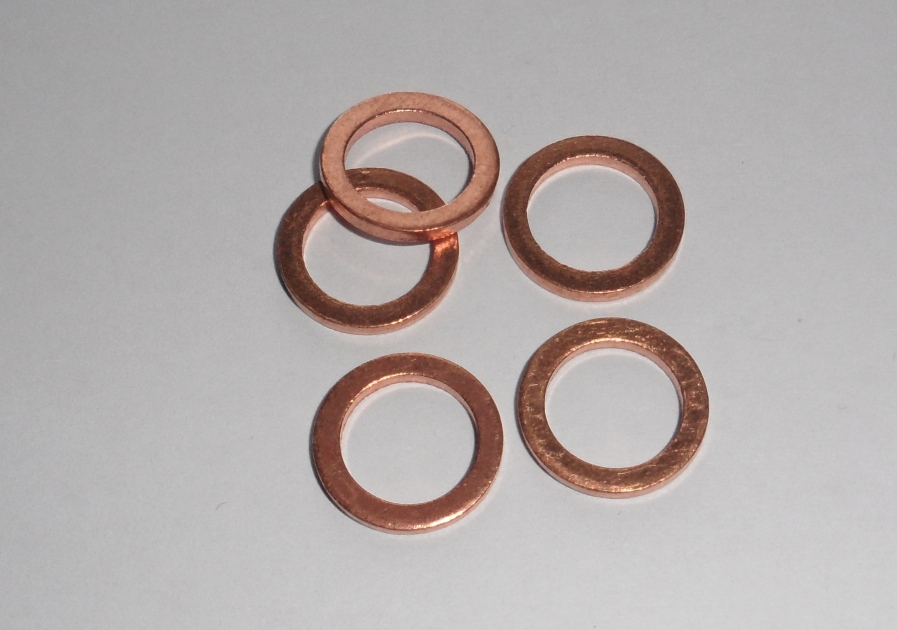

These BSP fittings don't use tape or paste as sealant.
All it's used is a copper washer or a steel washer with a rubber ring inside like this:
