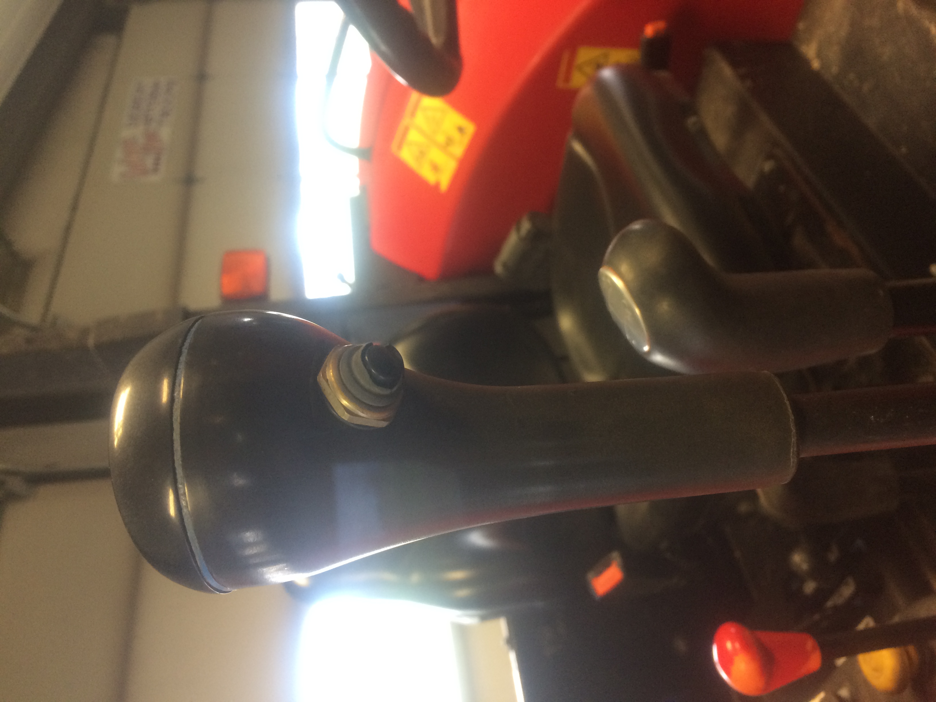

Finally broke down and bought a tractor. Massey Ferguson 3635, 2009 model with a DL260MSL loader on it. Got it home this afternoon and already widened it 10" by changing the wheels around. It has a button on the joystick for the loader, but I can't figure out what it is. Can anyone chime in if they would happen to know. I didn't get a manual for the tractor or the loader so I'm clueless. It doesn't have third function on it, and when I press it nothing happens. Any help would be greatly appreciated. I'll try to attach a pic along with the post. Thanks in advance!

Finally broke down and bought a tractor. Massey Ferguson 3635, 2009 model with a DL260MSL loader on it. Got it home this afternoon and already widened it 10" by changing the wheels around. It has a button on the joystick for the loader, but I can't figure out what it is. Can anyone chime in if they would happen to know. I didn't get a manual for the tractor or the loader so I'm clueless. It doesn't have third function on it, and when I press it nothing happens. Any help would be greatly appreciated. I'll try to attach a pic along with the post. Thanks in advance![/QUthat button is for grapples. hold button down while moving joystick to the right opens grapple.

for grapple. hold that button while moving joystick to the right opens grapple
