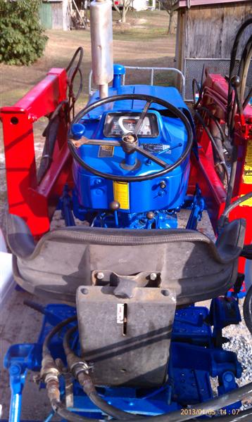

I didn't see a reason why either but figured I'd ask. I would like to add remotes to my Ford 2600 for a Top link and a second remote possibly for tilt or for hydraulics on an attachment. And I was thinking of using a joystick mounted inverted under the controls for the loader (Bush Hog 2400QT)

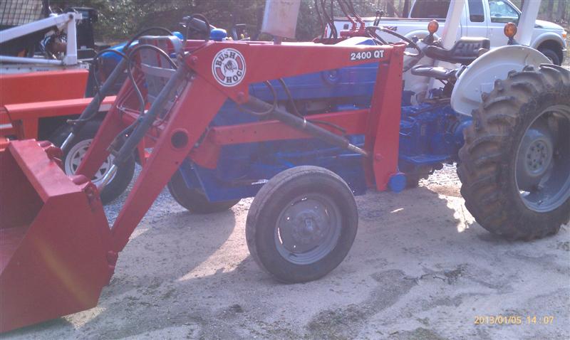

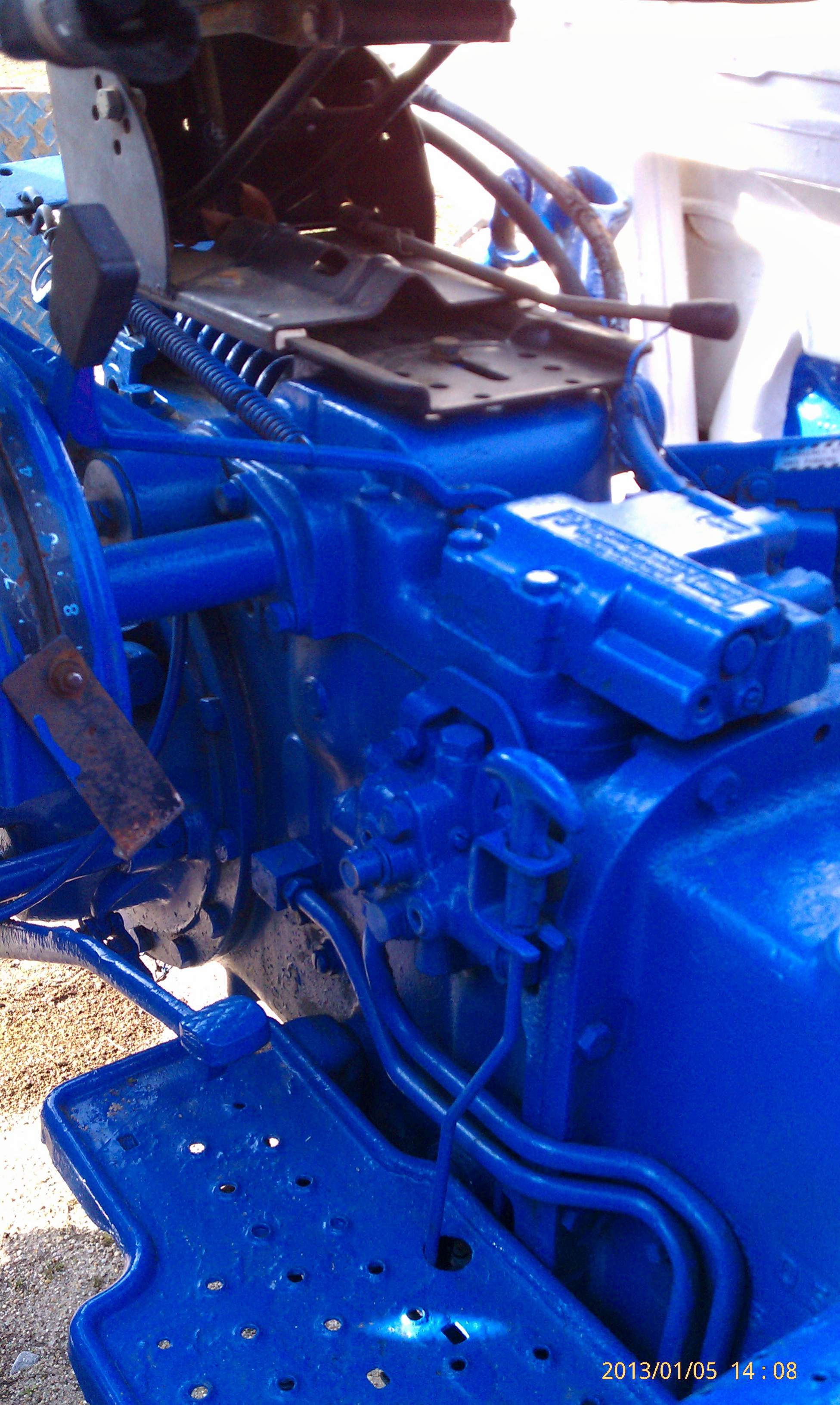

You can see the setup as it exists now in the photos above which were taken right after I bought it early this spring.
For the loader to work the lever has to be held back by a spring visible in the last photo. If I remove the spring the lever will want to return to the 3 pt. So as it works now if I have a BB or other attachment on the 3 pt and want to lift it I have to hold the lever forward to direct pressure to the rear. I want to do away with this mess mand add two remotes circuits.
So what do I need to be able to use the rear remotes without having to disconnect the loader and also eliminate the jury rig that powers the loader now?
I'd like to have a BB with hydraulic top link on the tractor at the same time as I would use the loader.
Trying to figure out how much of this I can get from FitRite and what else I will need to complete this.

You can use a joystick valve in whatever position you want.
However it is not ideal for remotes. Regen might cause some confusion.
A 2 to 4 spool valve with float, and other features would be better.
Does the FEL valve go with the loader? Iif so, connect the IN hose and the PB hose together, and cap the OUT hose.
If the FEL valve stays with the tractor, just remove the work port hoses and plug the work ports.

The FEL valves go with the loader when its disconnected from the tractor.
Then I am left with the two ports you see beneath the seat in the first photo.
There are only the two hoses at present.
