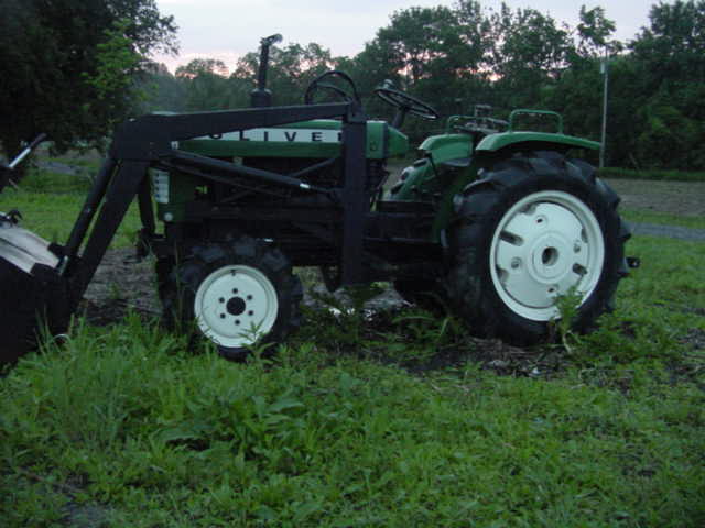

I realize that a diesel has much more compression than a gasoline engine, but should I be able to jump start it with my V-8 Suburban??? I had a loose negative cable...(which was my fault from not tightening it up after replacing the clutch) which I think led to a dead battery. When I turn the key, the starter bumps but will not turn motor over...the same thing happens when I jump it except that it will turn it over really slow. The old girl is stranded too far away from any electric for a charge...should I hook her up and pull her in with the old Allis Chalmers??? Also...any advice for making it easier to lift the hood with the grill guard on the front. What a hassle that has become. I attached a picture of the Yanmar?Oliver

Nice paint job! Which model of Yanmar is it really? I know about flat batteries, I had my share of them until I modified the Yanmar to use a better quality battery. Now it can sit for half a year and still start right up. The alternator doesn't have much output, but it doesn't need to do much either. All it does is run some tiny lights and top off the battery. I've never had an electrical problem that wasn't a bad ground or a bad battery.
