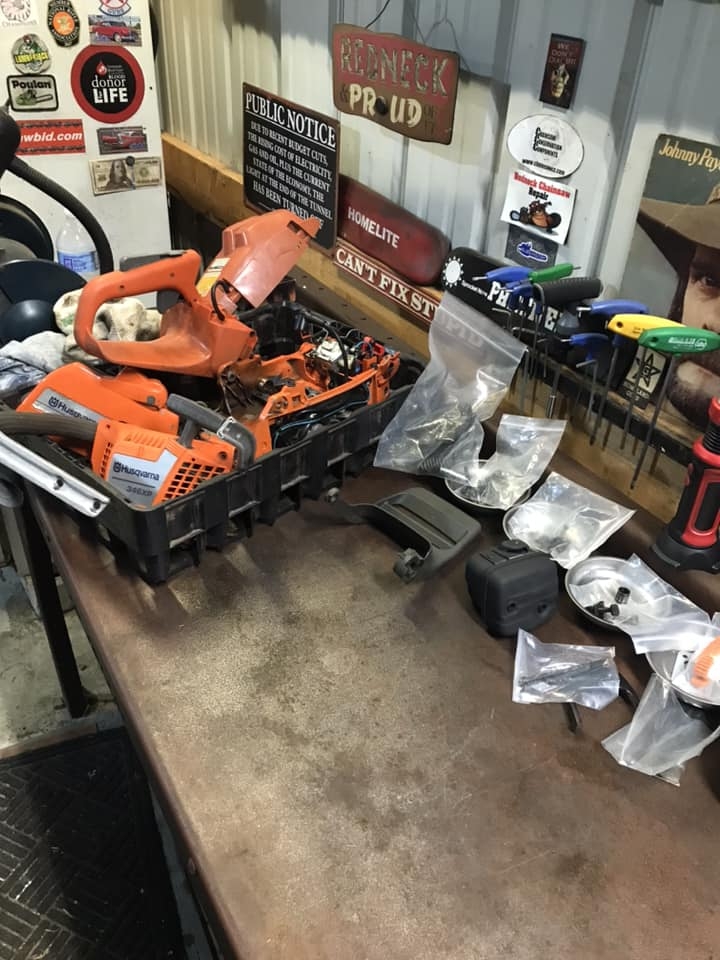

SIL bought a new piston, wristpin, circlip from a dealer, when he showed it to me it looked like Amazon packaging. When I put the ring on and went to put the piston over the con rod, it wouldn't fit....wonder why? Looks like someone forgot to finish machining the bosses. Even the casting is crappy looking, should have just bought it off Scamazon and be done with it.

Not a clue what you got going on or what a dealer sold you.
Your case I would take the piston back and ask him if oem piston. Does it have makers name inside it somewhere?
But you can redneck widen pin bosses pretty easily. Heck I do it to use 66 piston on a 505 many years back. Just try and keep both sides even and widen to to what oem piston was taken out.
Back in 2012-2013 time frame. 66 piston is not even close to fitting a husky style crank rod end. I widen it to use here.

Looking sure seems that would fit over. Flashing?
But I would check to see if a oem maker inside the piston. Then if dealer is close ask if not.
I cant recall which saw you working on?
New husky 262 piston made in China
I let the SIL pick up the parts. Don't think there's any chance it's OEM, plain white box, very rough casting, minimal flash removed, no make anywhere, i.e. Chinesium. Looking up the name Gripo, it looks as if its a Quebec company.
If it was mine and I had knowingly bought a knockoff I would have. He insisted on going to the dealer so it's on him.
Flashing just not milled to size, like it missed a step.
Husky 254
Question. I checked the end gap, was 0.005, seem tight? although at 2 thou. per inch diameter 5 thou is right for an 1-3/4 diameter. The old ring was almost 1/8" so that was
definitely too much lol.

Man that suks. Never heard of gripo.
If they was going to sell him a aftermarket should have sold him a meteor brand as first choice. Then a Hyway or Dukes for our choices. We have down here.

There is a formula for checking ring gaps as their not all the same depending on size. Just have to google it.
IMHO to tight.
Here is last saw I did checking in 2 different cylinders same ring.
50mm
Old cylinder a loose .010
New cylinder a tight .010
   / Just another junk chainsaw #2,713
IMHO to tight.
What I thought too. I'll check the next one he gets and see what it measures. I've got a thin diamond stone so it won't take much to trim it down if it's too tight.
