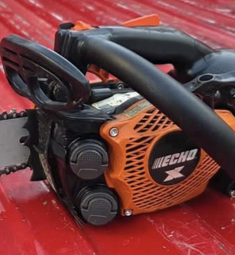

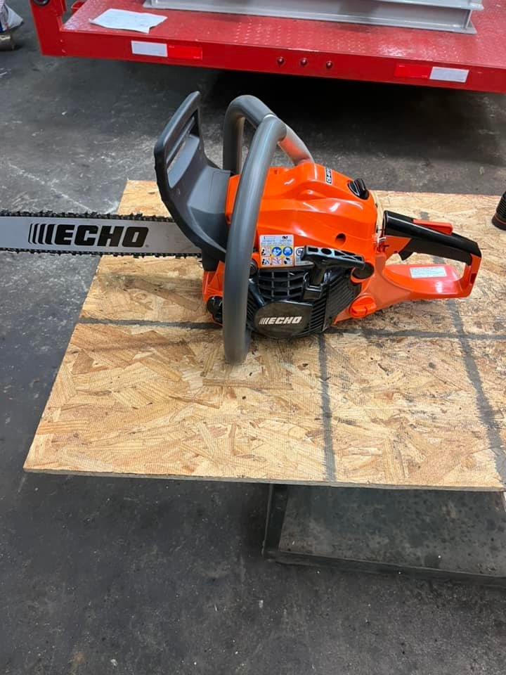

While picking up Christmas tree yesterday, got in a talk to the farm owner.
He just switched to an Echo battery saw, which he likes so far, does hundreds of cuts each day, with multiple people and skill levels using it.
His small gas saw gave up, so he bought the battery one, even though his last try at a battery saw a few years ago was a dismal failure as it would bog down and stop on most cuts.
The new Echo one looked pretty good and worked great on the softwoods.
He hasn't had a chance to try on any larger hardwoods yet.

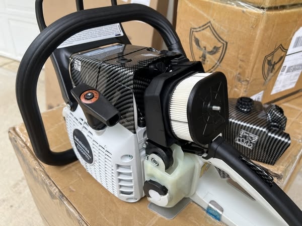

Little crazy with the bar length. The open port regular carb stihl 363 sold overseas.
Sort of like the 400.1 closed port Mtronic saw half brother, just for overseas markets.
Guy in my group ships them over to us for 850USD shipped.
Now plus tariff tax. Which isnt bad from where he lives. Like 40 a saw.
   / Just another junk chainsaw
#2,705
Sure seems to cut fine with the normal length bar.
Thread where we can get them shipped over for 850USD shipped.

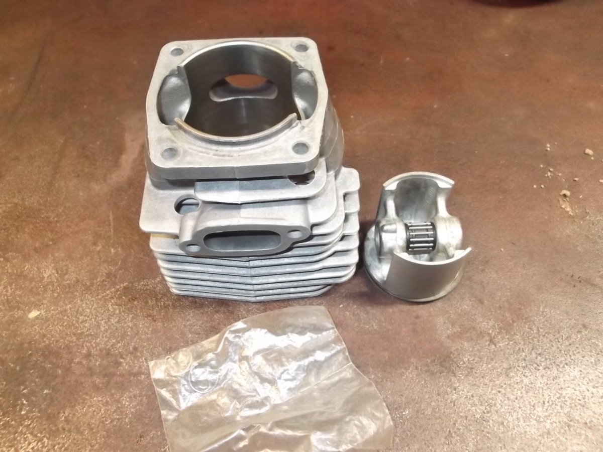

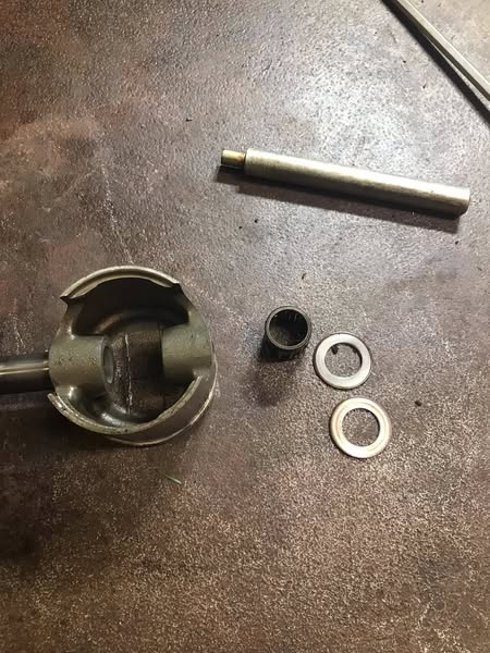

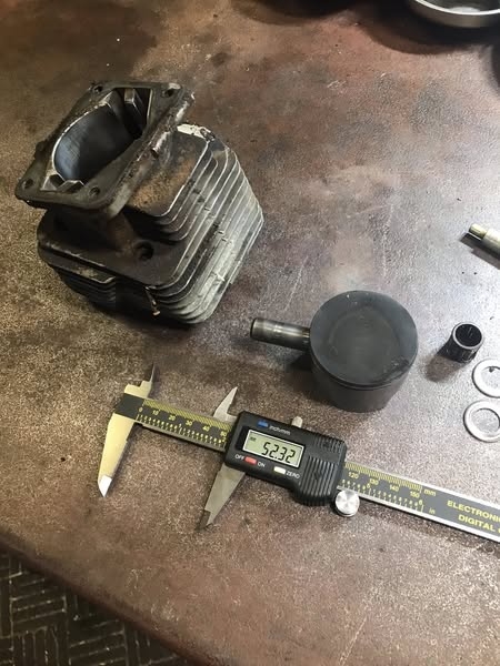

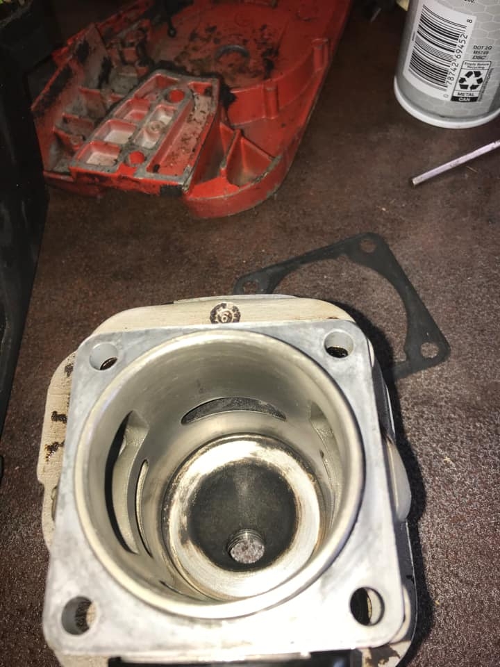

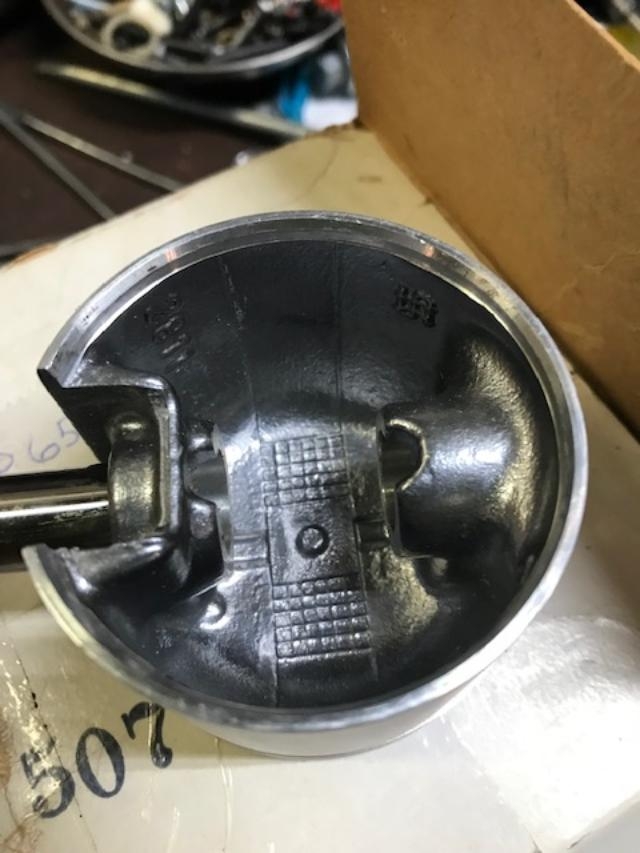

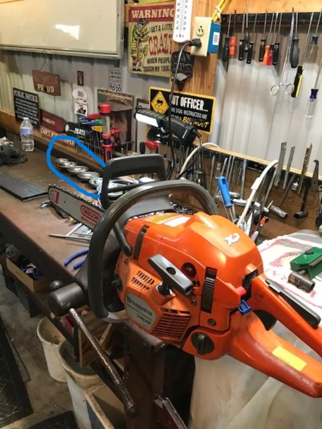

SIL bought a new piston, wristpin, circlip from a dealer, when he showed it to me it looked like Amazon packaging. When I put the ring on and went to put the piston over the con rod, it wouldn't fit....wonder why? Looks like someone forgot to finish machining the bosses. Even the casting is crappy looking, should have just bought it off Scamazon and be done with it.
#2,707
Not a clue what you got going on or what a dealer sold you.
Your case I would take the piston back and ask him if oem piston. Does it have makers name inside it somewhere?
But you can redneck widen pin bosses pretty easily. Heck I do it to use 66 piston on a 505 many years back. Just try and keep both sides even and widen to to what oem piston was taken out.
Back in 2012-2013 time frame. 66 piston is not even close to fitting a husky style crank rod end. I widen it to use here.
#2,708
Looking sure seems that would fit over. Flashing?
But I would check to see if a oem maker inside the piston. Then if dealer is close ask if not.
I cant recall which saw you working on?
New husky 262 piston made in China
   / Just another junk chainsaw #2,709
I think I've had my Kobalt 24v electric saw for 4 years now. I just cut another pile of wood with it a couple weeks ago. It's the best saw I've ever used for 90% of jobs. Still on the original batteries too. I finally caved in and bought a chain sharpening tool so now I can extend the life of my chains. I use Oregon chains and the Oregon electric sharpening tool.
   / Just another junk chainsaw #2,710
I let the SIL pick up the parts. Don't think there's any chance it's OEM, plain white box, very rough casting, minimal flash removed, no make anywhere, i.e. Chinesium. Looking up the name Gripo, it looks as if its a Quebec company.
If it was mine and I had knowingly bought a knockoff I would have. He insisted on going to the dealer so it's on him.
Flashing just not milled to size, like it missed a step.
Husky 254
Question. I checked the end gap, was 0.005, seem tight? although at 2 thou. per inch diameter 5 thou is right for an 1-3/4 diameter. The old ring was almost 1/8" so that was
definitely too much lol.
#2,711
Man that suks. Never heard of gripo.
If they was going to sell him a aftermarket should have sold him a meteor brand as first choice. Then a Hyway or Dukes for our choices. We have down here.
#2,712
There is a formula for checking ring gaps as their not all the same depending on size. Just have to google it.
IMHO to tight.
Here is last saw I did checking in 2 different cylinders same ring.
50mm
Old cylinder a loose .010
New cylinder a tight .010
   / Just another junk chainsaw #2,713
IMHO to tight.
What I thought too. I'll check the next one he gets and see what it measures. I've got a thin diamond stone so it won't take much to trim it down if it's too tight.

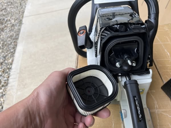

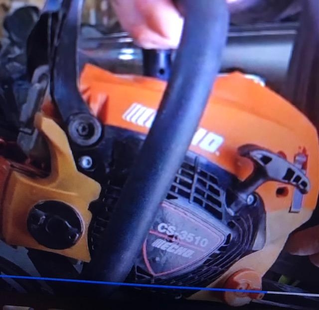

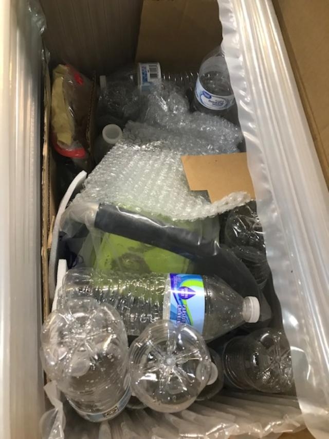

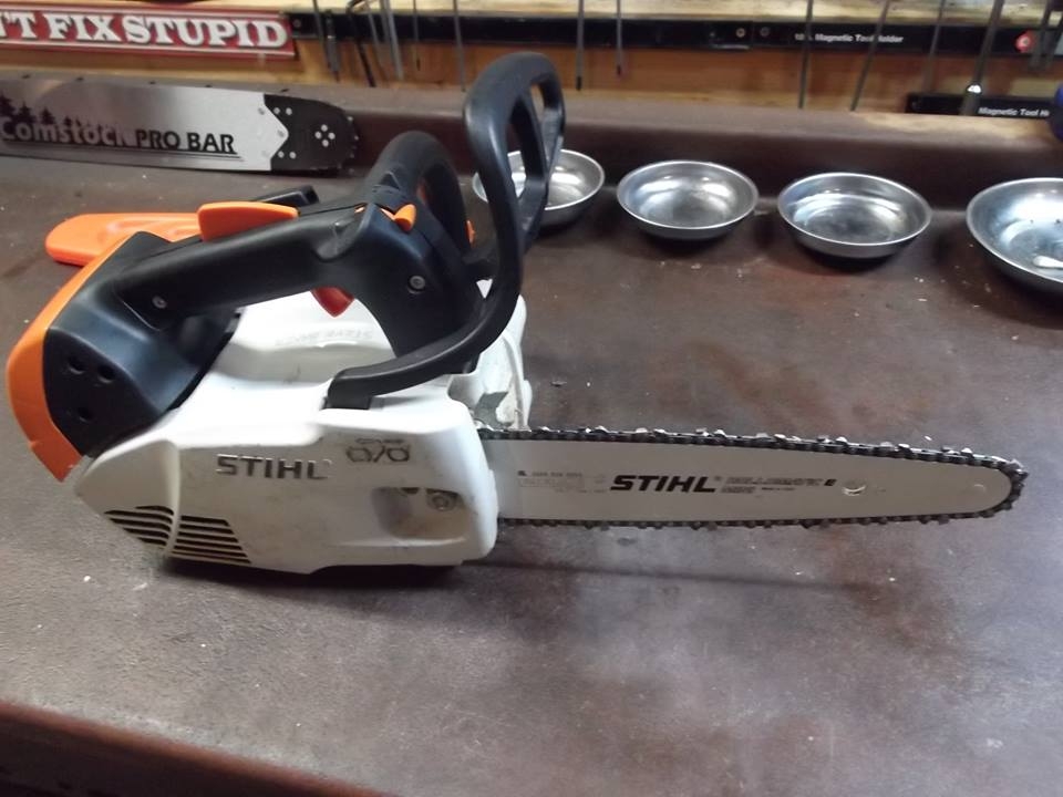

USPS finally found the box with stihl250C in it. I reported it lost or stolen to them on 18th after didnt show up for arrival date of 16th. It just sort of disappeared off tracking for awhile.
Ended up on other side of state just stalled there till 29th. Just glad it showed up.
It's the one I traded 3510 off on. It seems all there and no plastics seem broken. Just need to go through everything. Purge bulb was busted.
Before pic was before he wrapped on plastic cover and after pics of box.
