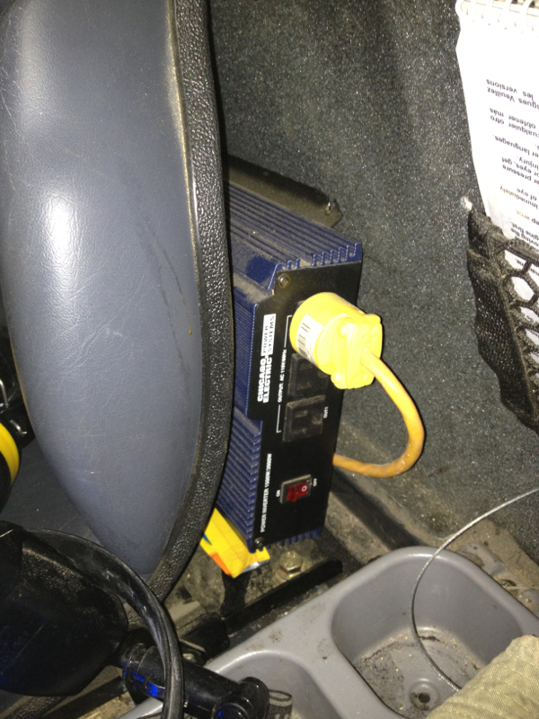

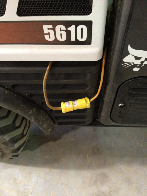

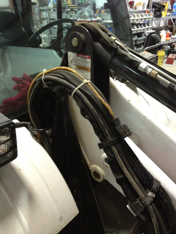

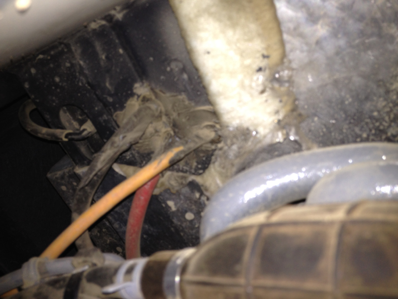

Pics of inverter. Inverter behind pass seat. Wires to inverter viewed from below. Plug in on side with wire to front of machine plugged in. Plug on front of machine.
Have 200 amp fuse in hot wire going to inverter to prevent badness should one of the big wires to inverter get shorted

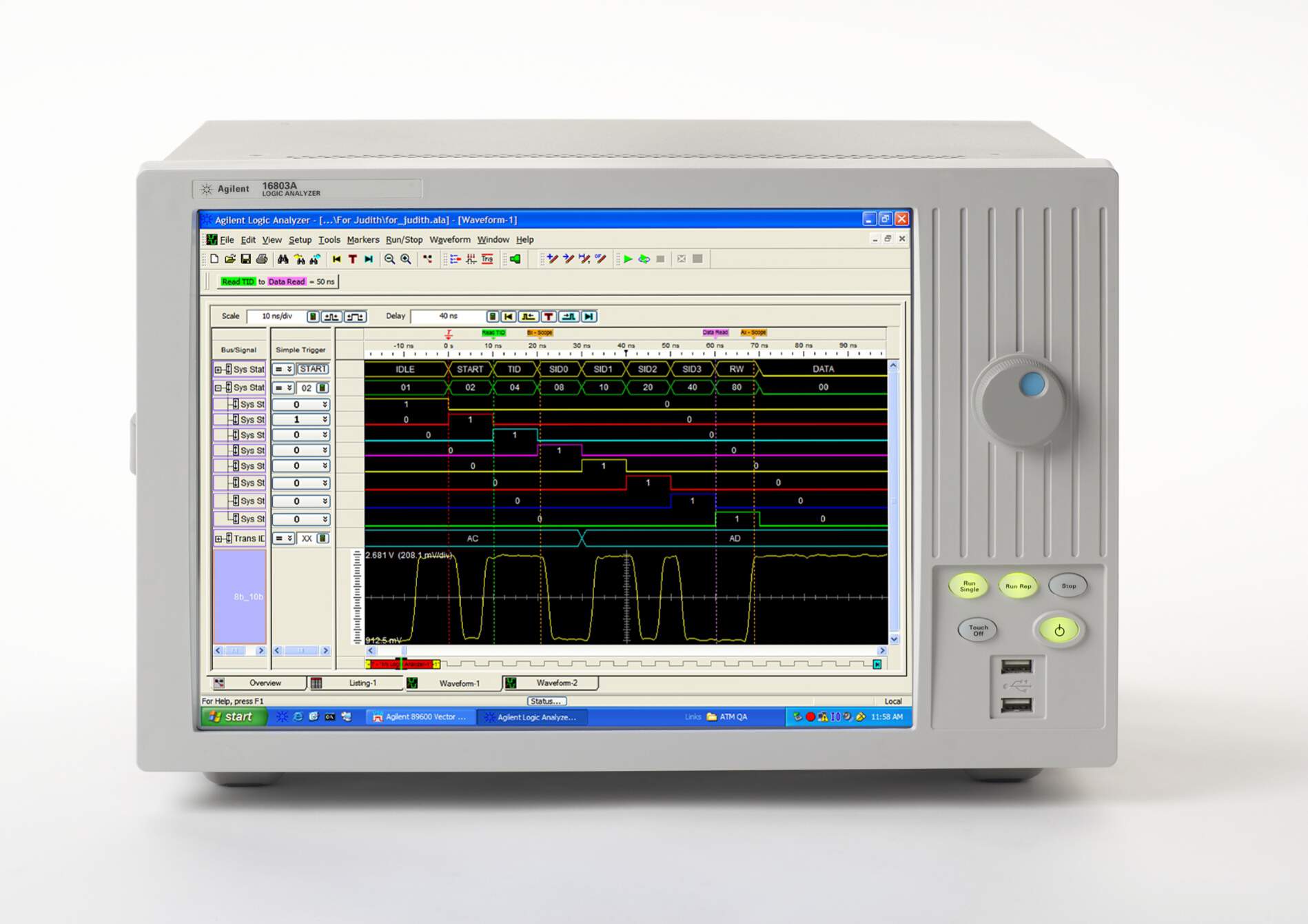

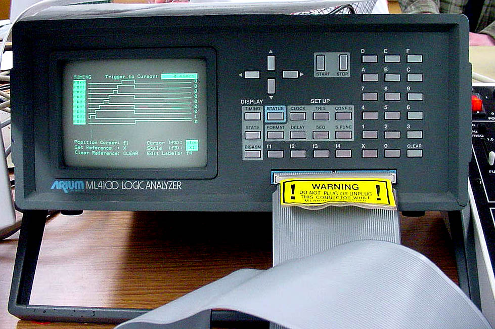

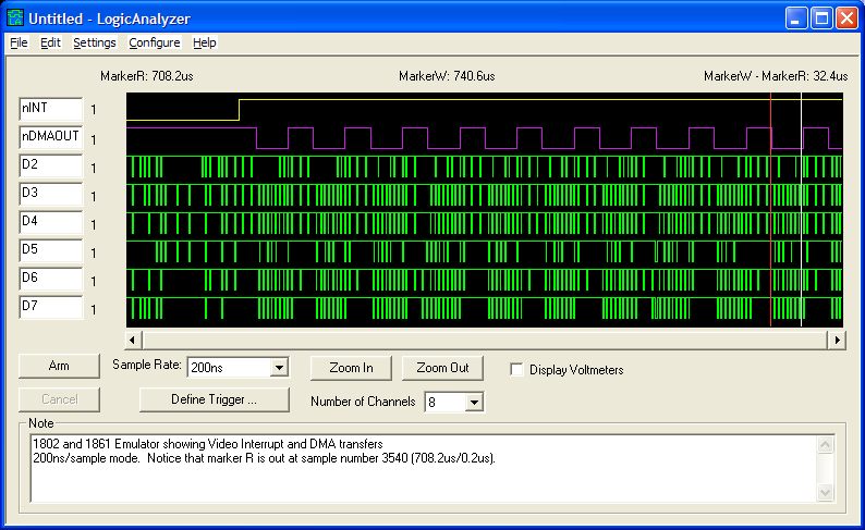

Too bad they don't know how to troubleshoot, throwing parts at it may not fix this one!
I was employed as an electronics technician for 34 years, working on computers and fax machines. Voltage spikes can be very hard to track down. The problem could be found with a logic analyzer, but I don't think they would have one or even know what it is.
Logic Analyzer pictures from Google Image Search:
logic_analyzer_wide.jpg LogicAnalyzer.jpg Agilent-16800-Series-Logic-Analyzers-Front_1.jpg
