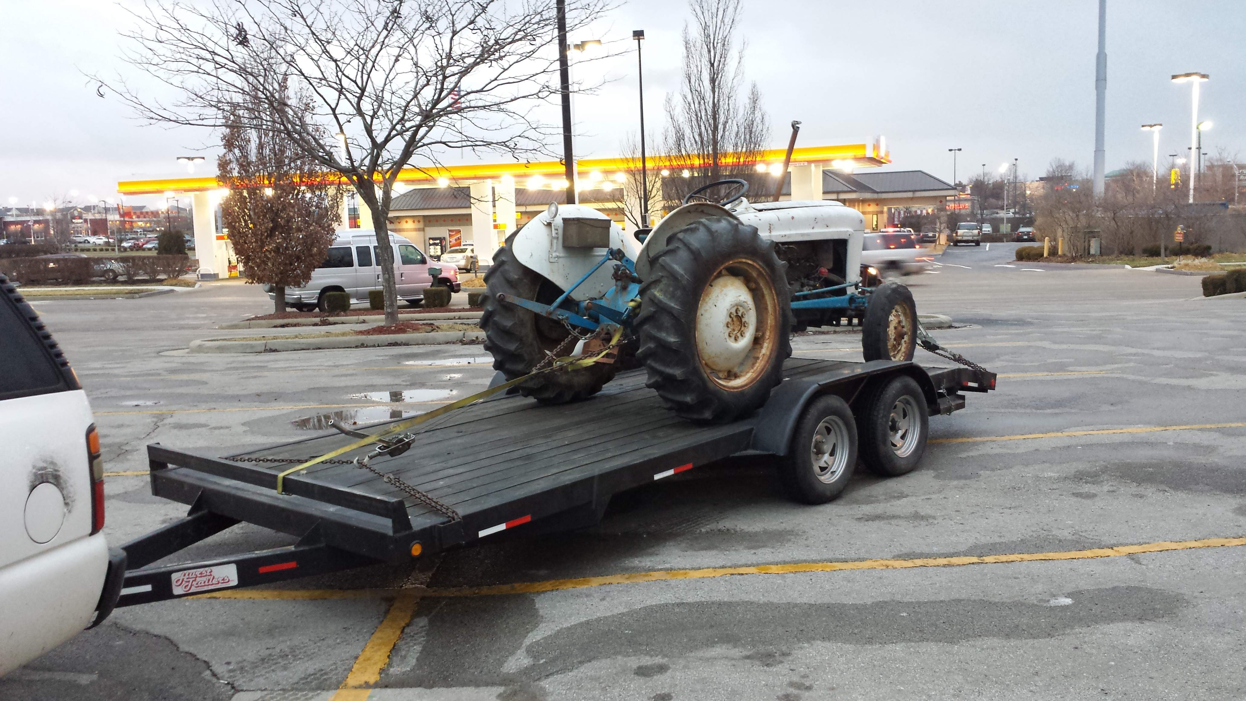

Hey all,
I just bought a 2000 series made in 63 according to the model number with a 62 serial #. It's got its original paint which is of course pretty weathered and rough. It has a white hood and fenders with a blue chassis. Most of the pics I can find are all blue. Did the early 2000's come white and blue only to have people paint them all blue later on?
It's a good runner and is going to be used in a garden and to pull a mower so I'm not going all out to restore it but want to spruce it up a bit.
Thanks

industrials could be buff cream.. but 2000's were blue hoods
   / Just bought a 62 2000 made in 63. Colors? #4
2000 would have a blue hood. 4000 would have the light gray hood. Both would have light gray fenders.
Kirk
   / Just bought a 62 2000 made in 63. Colors? #5
unless an industrial model.
all depends on who what where the tin came from too.,
I guess what I called white is light grey. The second number in the model number translates to "industrial or agrigultural made after on or after 1963".
   / Just bought a 62 2000 made in 63. Colors? #8
painted like a 4k
pretty common.
anything froma tin swap. to ignorant owner.. to deliberate attempt to misslead.
   / Just bought a 62 2000 made in 63. Colors? #9
Even has 2n/early 8n fenders. What are the engine #? who know what else was switched out. 601/2000 rear and Ag front axle.
Kirk
   / Just bought a 62 2000 made in 63. Colors? #10
yep. hard to tell. I have a 2000 that has parts of at least an 00 series and an 01 series on it.
hack job.
