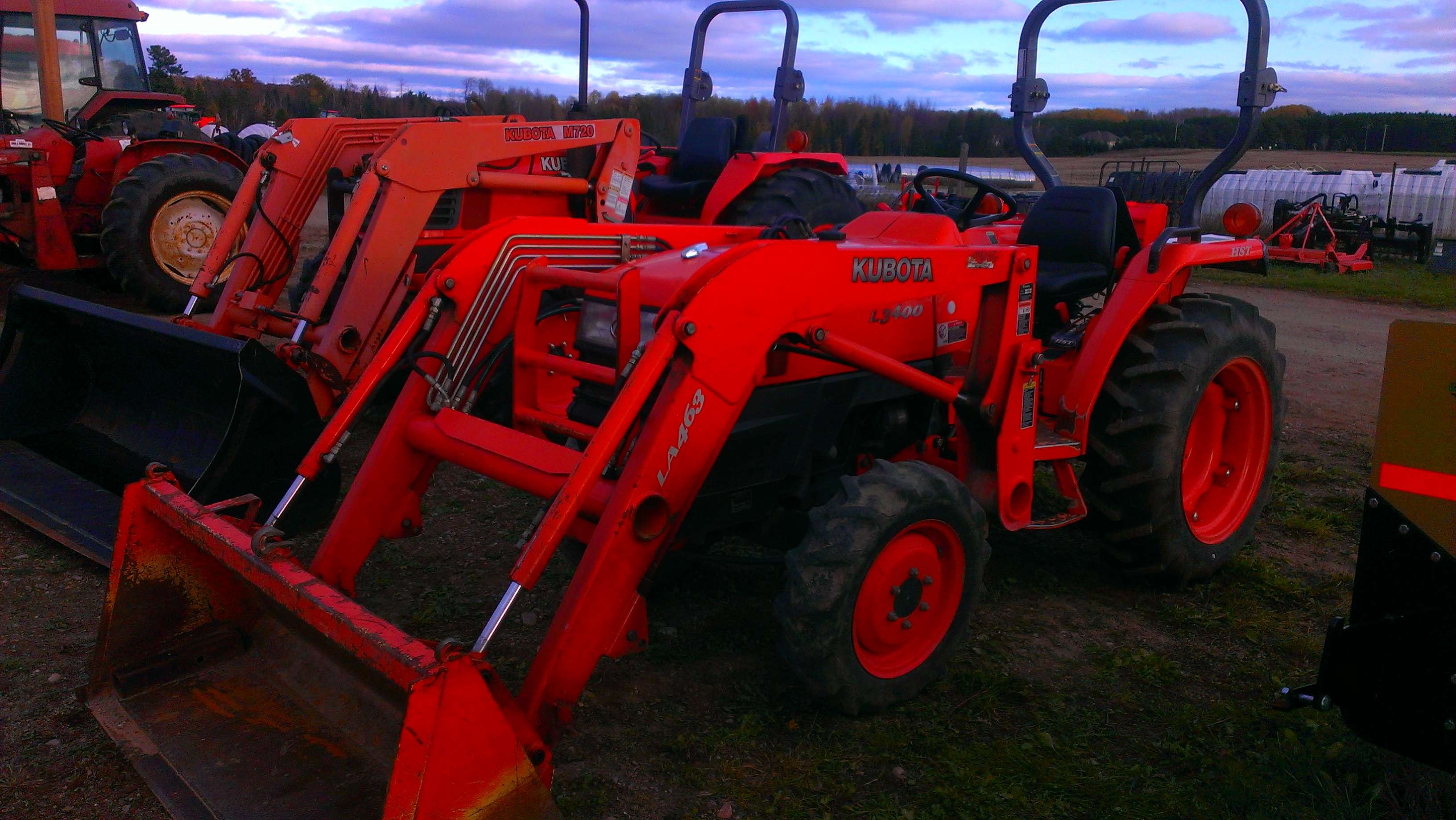

After a year long search, I just brought home a 2005 L3400.
We (the boss/wife/cfo/etc) had been looking for a tractor ever since we moved in to our 40 acre chunk of paradise. I'd been watching the classifieds and visiting the local tractor dealers, and it was really starting to look like new Mahindra 2538 was going to be the winner. But on a bit of a whim we stopped at the local Kubota dealer and they had a 2005 L3400 HST with LA463 loader, and 1800 hrs.
We went in a talked with he sales guy and found out it had lived its life at a trailer park, and never winter driven, and came with a full set of Turf tires!
One big thing that made us do a double take was because it was a trade in, the financing rate was almost as good as buying new!
I've put 2 hours on it moving dirt and chipping brush. My only complaint is the ROPS doesn't fit through my garage door by less then 2":thumbdown:

View attachment 487205[/QUOTE
Congrats on the new tractor... the one in the pic has folding ROPS are you saying it won't go in your garage with the ROPS Folded either?
