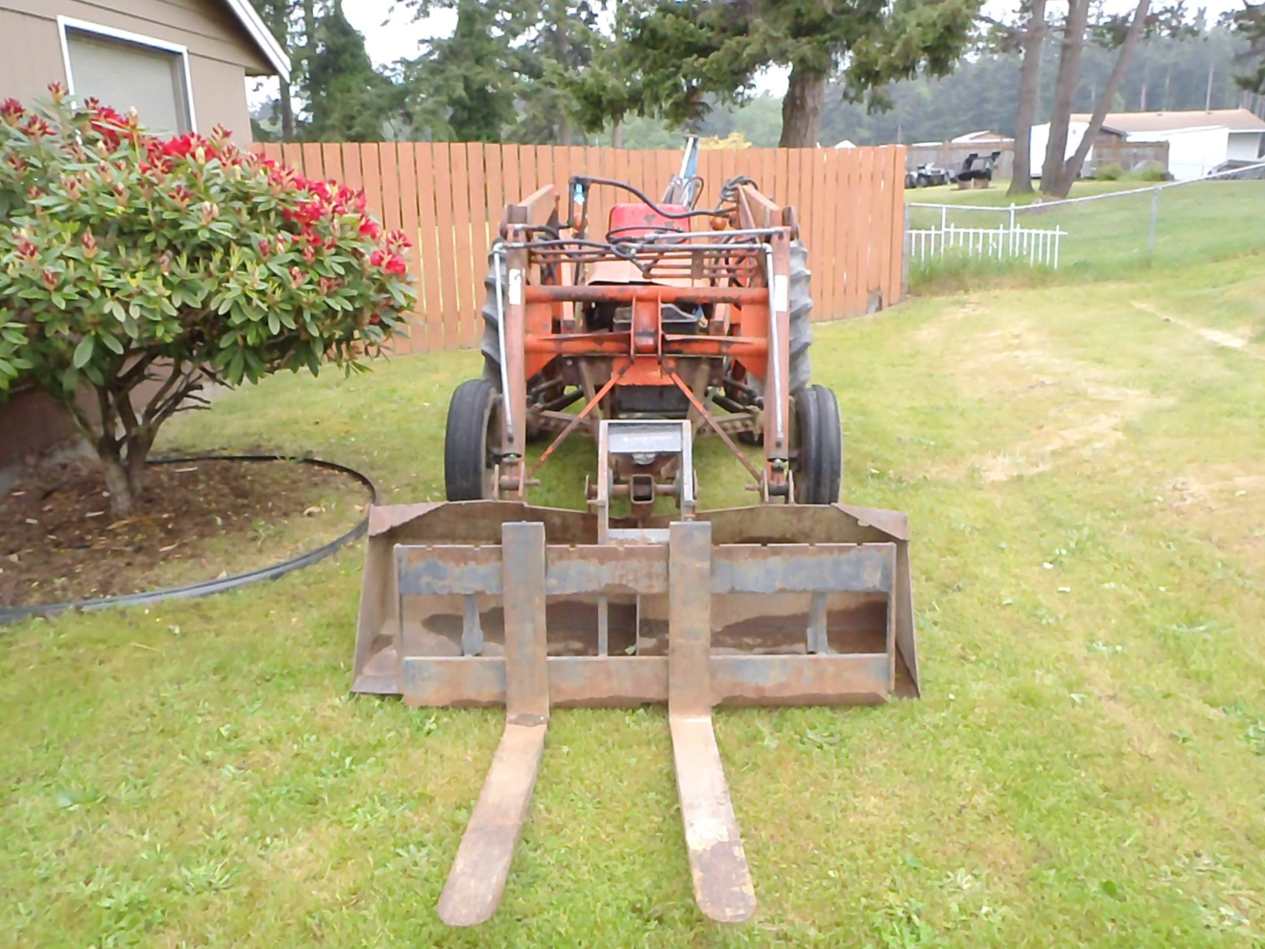

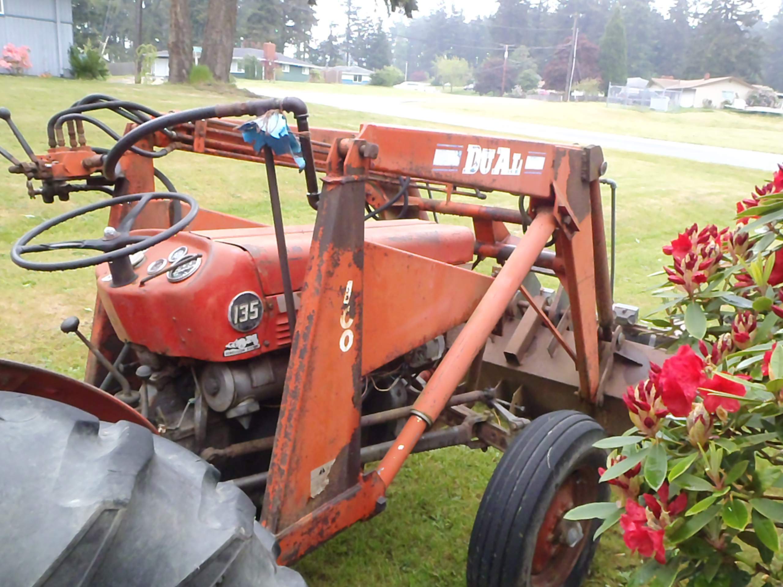

I was also wondering where a good place is to buy all the stuff I need for the 3 point. It is missing all the arms and linkage.

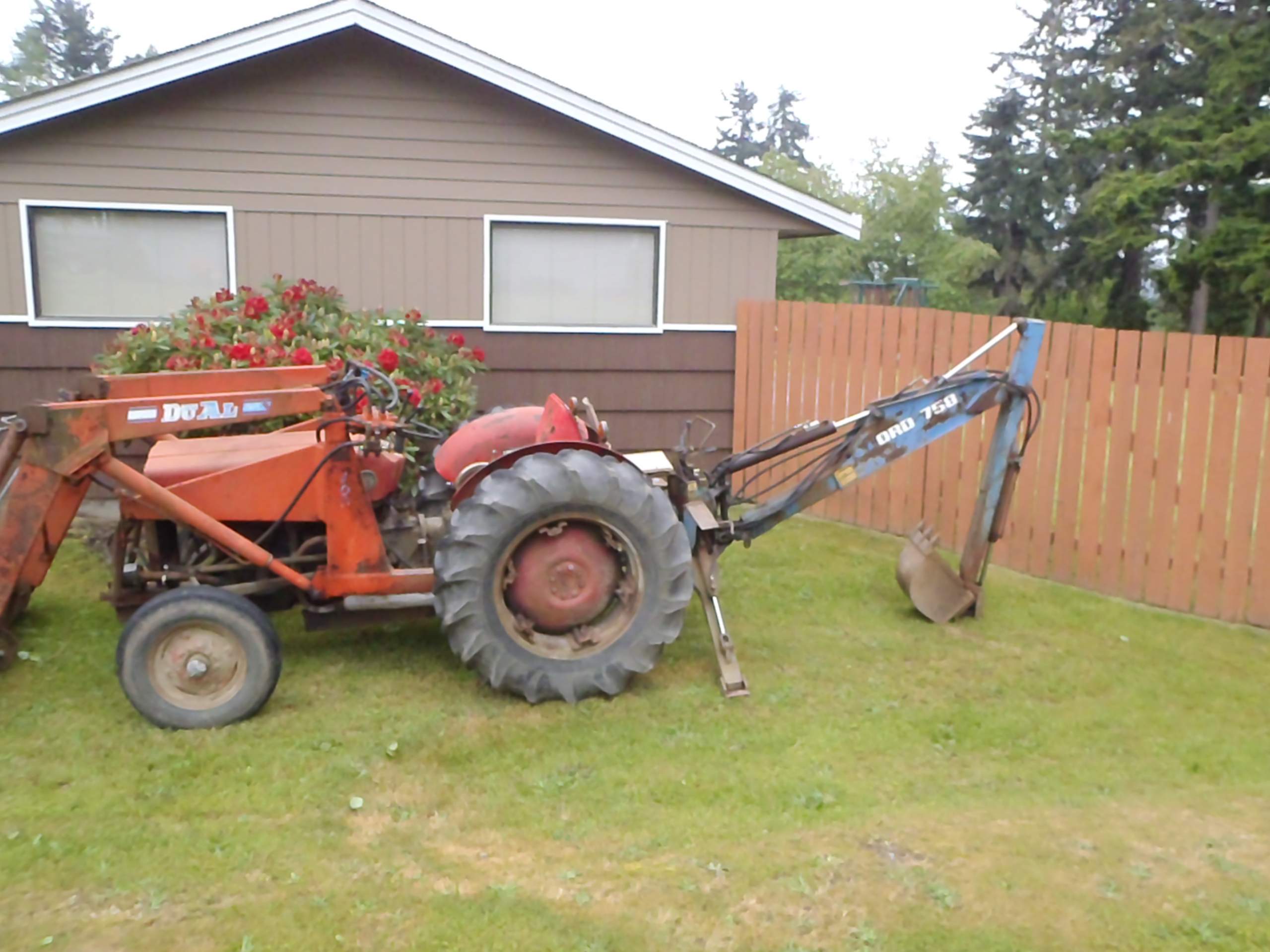

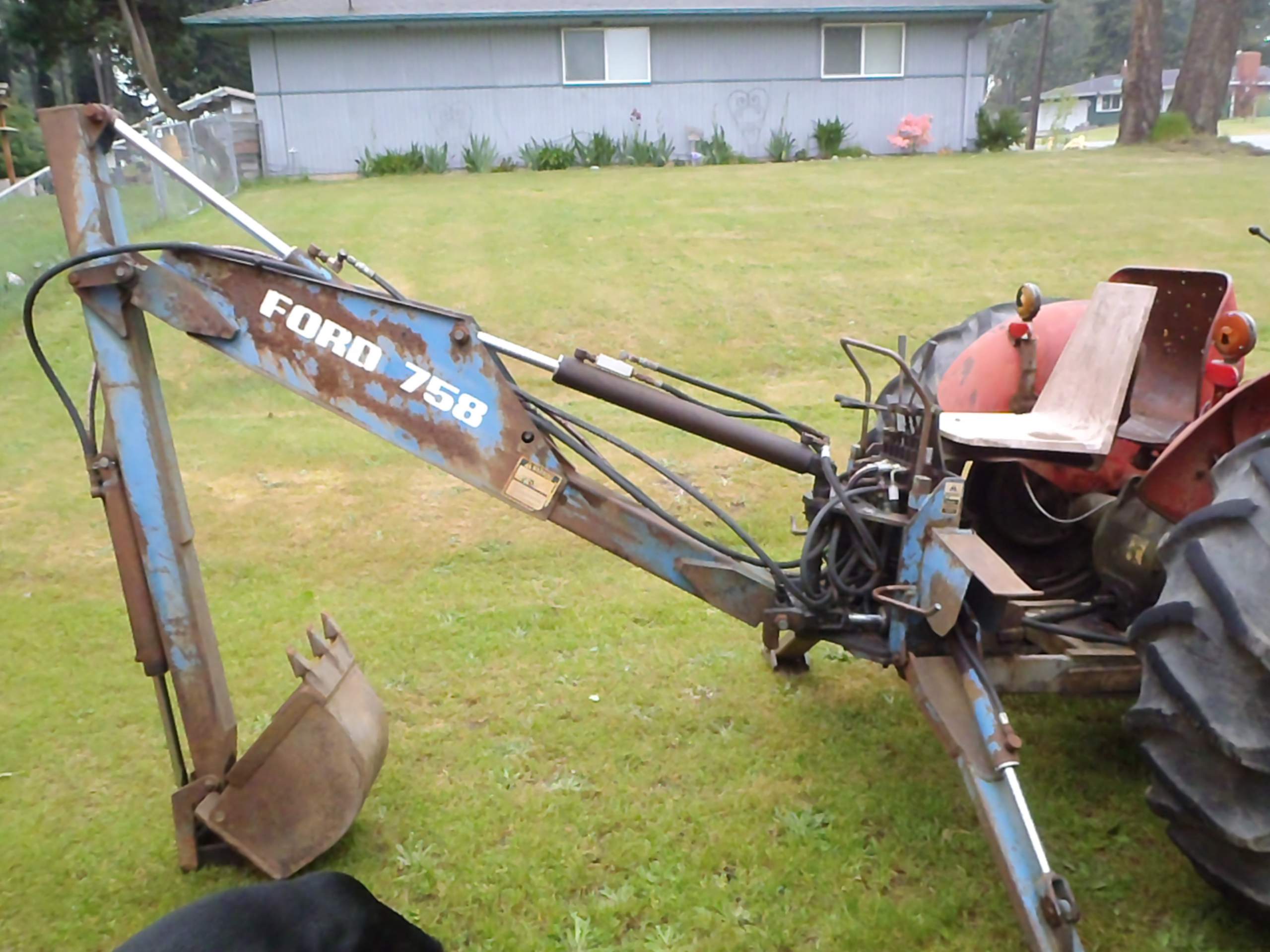

Someone removed all the links since it has a backhoe on it now

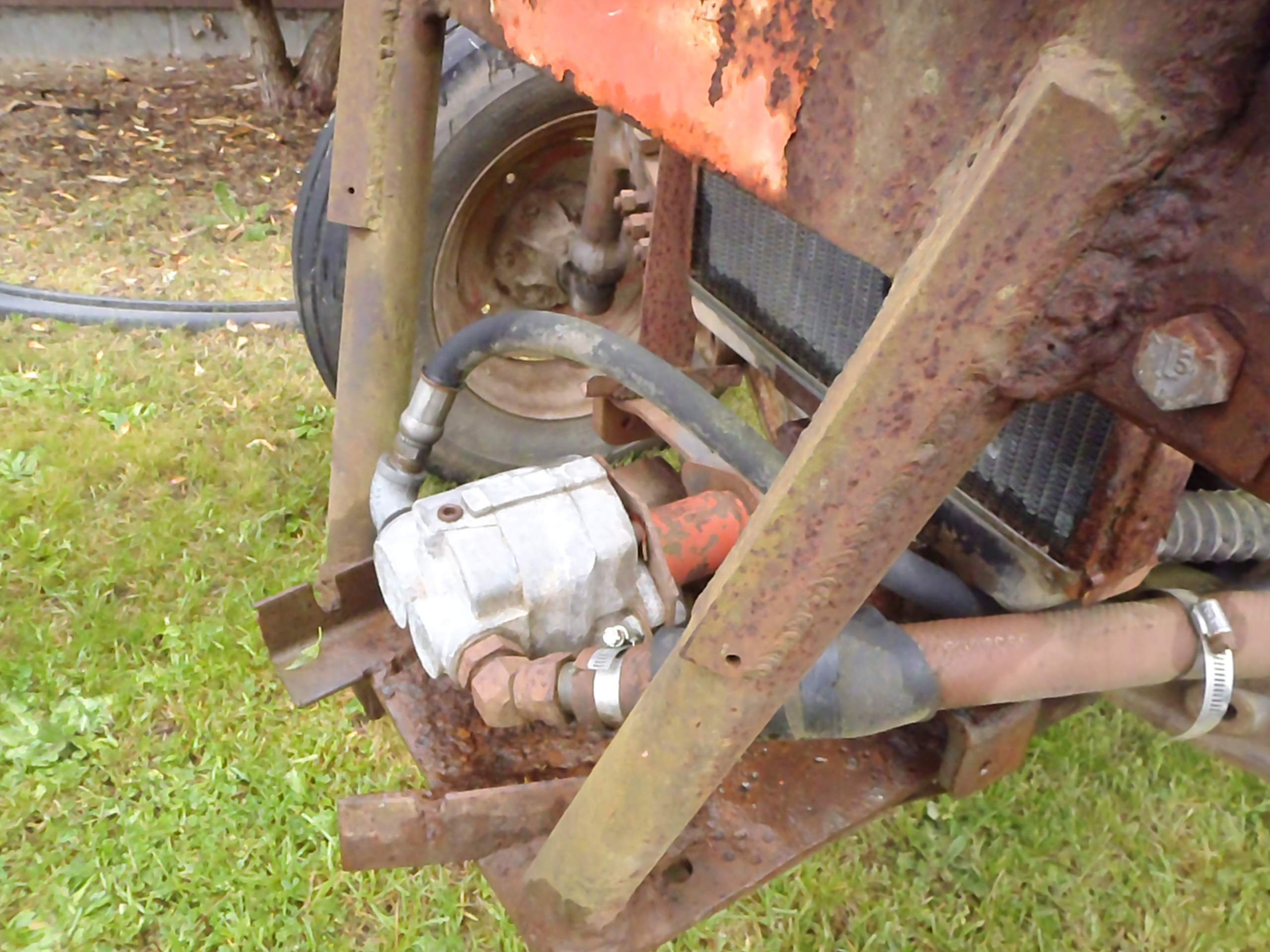

In Jul06 I bought a 1964 MF135 diesel Deluxe with MultiPower ($3600, 4600 hours). I'm the 3rd owner. The original owner had a bucket/hyd pump arranged like yours to run off the front of the engine. He sold it to the second owner at around 3000 hours who found out that the crankshaft had snapped at the point where the shaft goes through the front main bearing. Since the crankshaft was junk and had to be replaced, he installed the complete engine rebuild kit including valves/seats. Just a heads up--he told me he suspects the problem happened because of the hyd pump on the front of the engine.

Ran the old beast for about 4 hours today and used it to dig out a stump and did some vine clean up with it. It goes to the woods in the morning to start moving some small logs in the morning.
