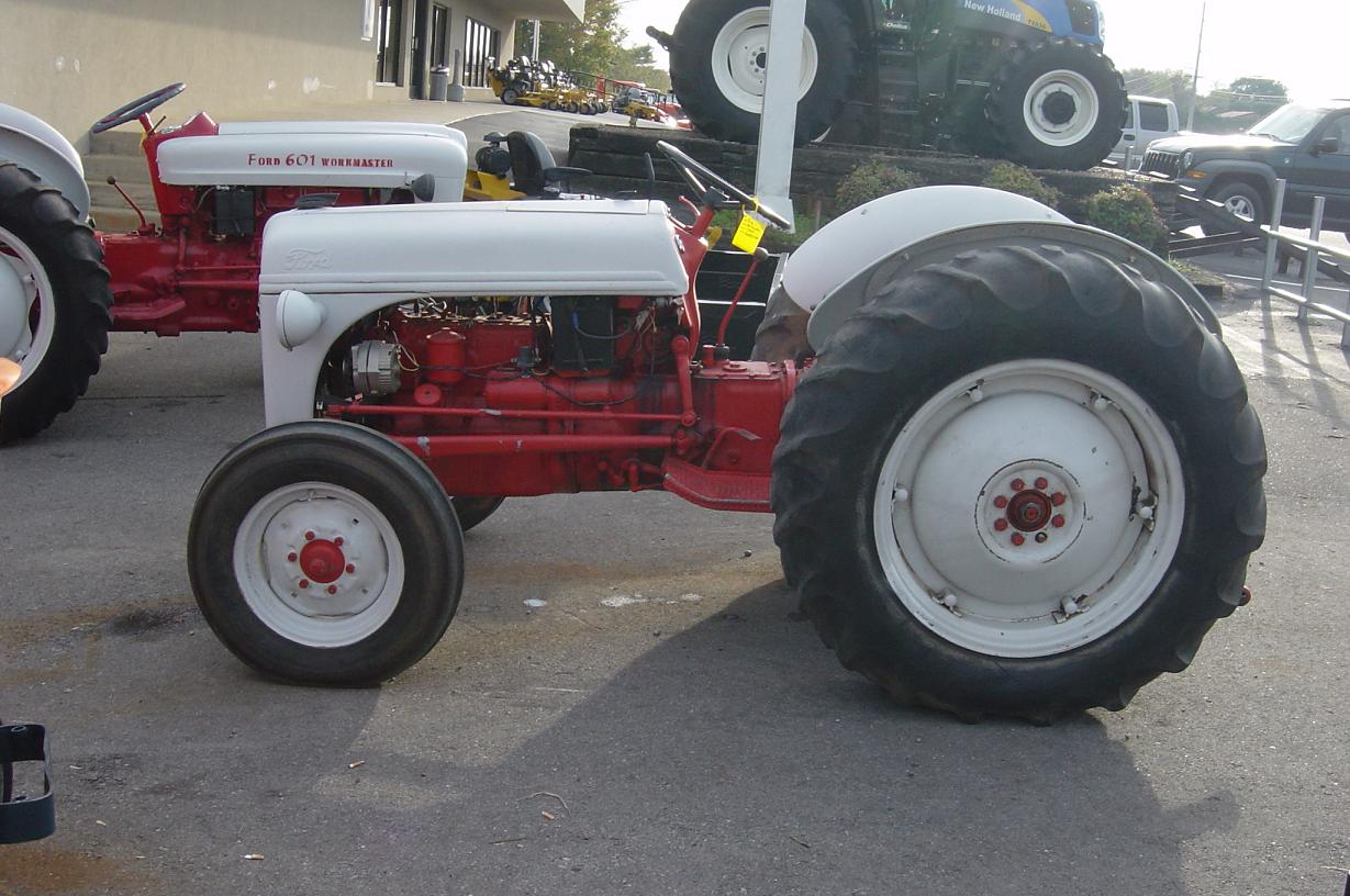

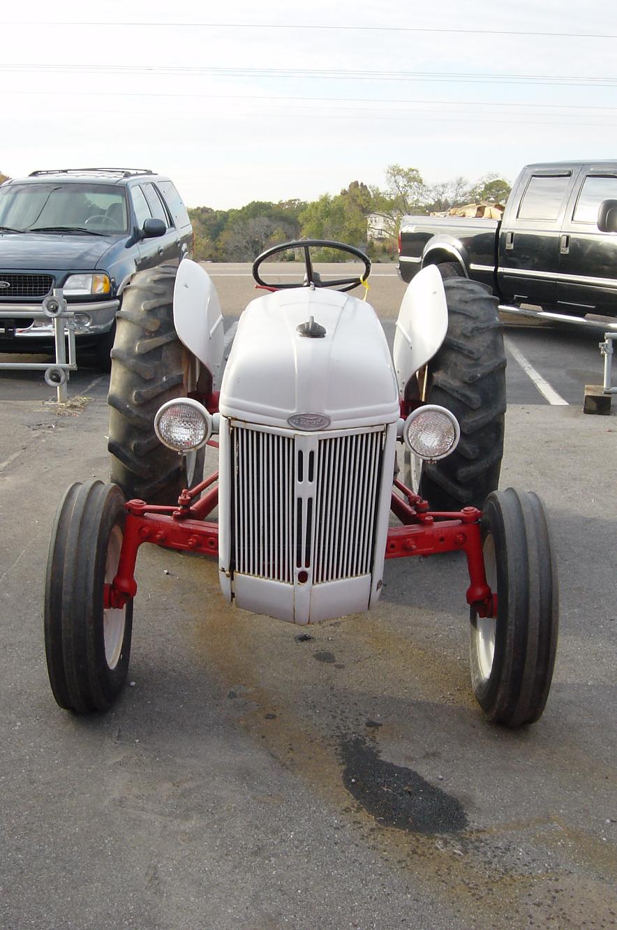

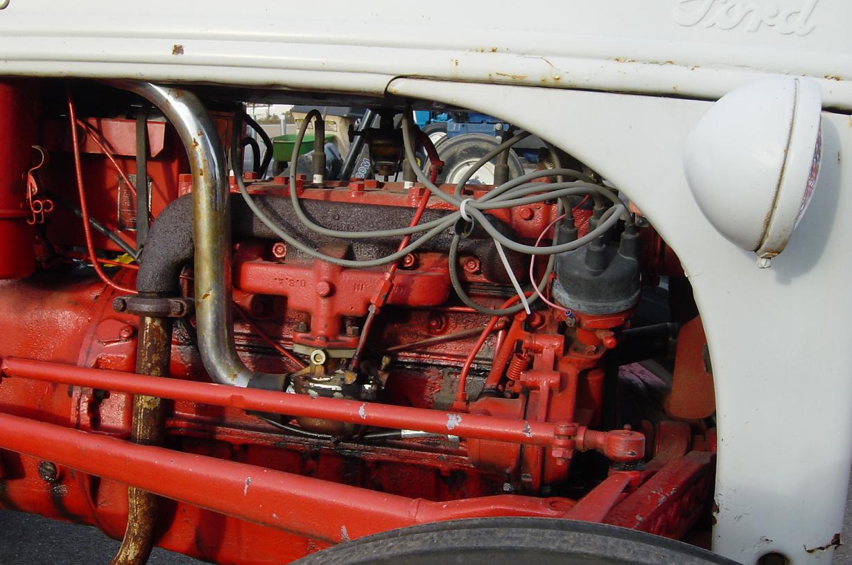

This is the first tractor I have ever owned...much less driven. I am fluent in manual tranmissions thankfully! Haha. My farmer buddy went and checked it all out and made sure that everything funtioned. Can somebody tell me what I need to look for and check on? It has a very very slight oil drip from the front main seal. It does not drip while running but will leave a 1" circle on the floor overnight.

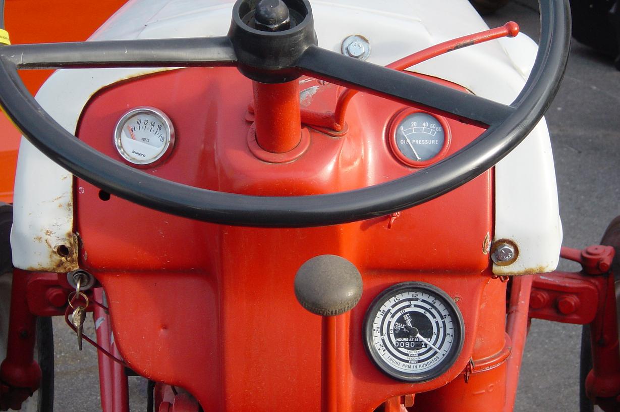

Also, can somebody help me read this tach? It's got a new distributor and tach including cable. The guy at the tractor place said to bush hog at 2600 rpms. Looking at the tach, that was way past the little "540" PTO line on the tach. When you idle it down to the "540 pto" mark on the tach, it's just a tic above idle. I can't see it bush hogging at that rpm. Can somebody shed some light? I am really digging this little tractor! Thanks, Keith

Looks like an older model of the 8N- yours has a side mount distributor, say a 1950-1952. If you Bush hog you NEED an over-riding clutch on the rear PTO, it will be a life saver- literally. The 8N is recommended to pull a 4' Bush hog, but 5' will cover the tire tracks and the tractor will pull it just fine (unless your cutting 4' tall heavy weeds). I would keep the throttle about 3/4 to full RPM, the govenor will limit the engine from running higher than its recommended.
Hope this helps.
by the way...sharp tractor!!

Ya got a decent looking later 8n.
It's got the late steering box, and is of course, a side mount distribuitor.
normally first thing i suggest is to get the owners manual, the I&T fo4 service manual, and master parts catalog.. but in your case.. I'll make that my 2nd recomendation. my first is to clean up that mess of spark plug wires and get them off the exhaust manifold.
You can buy metal core cut-to-fit sets at tractor supply for under 20 bucks.

Steering backlash can be adjusted by loosening the 2 locknuts on the sector studs and turning int he studs.. you can try this if you have backlash / play inthe steering.
I can tell you that your sector shaft seals leak. If you are not going to tear the box down to repalce them, then pull one o fthe 7/16 bolts on the upper right sid eo fthe box.. may go theru the battery box.. etc.. it is the fill hole... drill/tap the bolt for a grease zerk and pump in 1.8 tubes of JD cornhead grease.. or other 0# grease... that keeps the top thrust bearing lubed, and prevents you from having to tear the tractor down to rebuild the steering box...
looks like your left rear axle hub lekas a little.. looks kinda oily around the lugnuts.. that's a common problem.. leaky axle seals... the late 8n has an inner and outter seal. best way to prevent seals from leaking is to not overfill the common sump.

Card , if still the MS 241a/b/c it came with, and not a zenith replacement has 2 needles, idel and main. main needle is downpointing and towards the front of the tractor.. in to lean, out to enrich. idle needle is ont he side.. and is an air needle.. in to enrich.. out to lean.

538 rpm pto speed is at about 1500 engine rpm.. idle speed on that tractor is a slow 400-600 rpm..
The rings ont he tach read in mph for the gear listed.
oil filter ont he left side of the engine takes a napa 1010 gold cartridge, or a fram c3, or fram c3p.. or anything that crosses to those.

Here is the napa points, rotor, cap, and coil part numbers:
8N Side-Mount Distributor)
Points: NAPA HEAVY DUTY PIERCED (ventilated) #CS753 Standard Ignition #FD-8081 Standard Ignition Blue Streak #FD-8081X (Premium)
Condensor:
NAPA #FA66 Standard Ignition #FD-75 Standard Ignition Blue Streak #FD75X (Premium)
Rotor:
NAPA #FA67 Standard Ignition #FD-108
Distributor Cap:
NAPA #FA352 Standard Ignition #FD-128
Coil (6-Volt)
Coil (TRUE 12-Volt... No resistor needed)
NAPA #IC14SB
Fire order is 1-2-4-3 with #1 being at the radiator.

Crank case oil fill is that tube with a 'hat' breather cover ont he sid eof the engine near that ugly non-oem alternator.

Yes, with the original 6V generator system, but...
NOT ON THIS TRACTOR...
All 12V conversions using the Delco alternator MUST be Negative ground.
