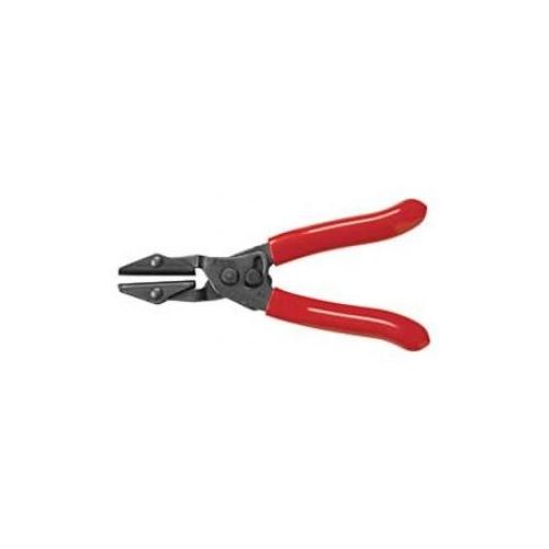

the hour meter is telling me it's time to do the fluid changes on by BX, I have a question, what did you use to clamp the fuel lines when you changed the 2 fuel filters? Just wondering, I'm not big on getting fuel all over me or the tractor.
I've got all the filters and fluid.
Thanks
   / Just finished 300hr service @ 150hr :)
I too hate getting fuel on me and everywhere else. Two good tips, buy fuel clamp pliers, there are cheap ones at AutoZone for like $10 ea or buy a nice pair from Craftsman which clamps a bit better and clamp on either side of the line.
Don't go crazy and clamp to close to the filter or you may break the neck of the filter.
BUT: When you remove the filter it will still spill what is has inside and whatever is in the little bit of line before the clamps. Have a little container ready and undo one side and let the fuel go into the container.
Take extra care to make sure that the filter is going in the right direction, arrow pointing towards the injection pump, or basically exactly the same way that you removed it.
Thanks
The below picture shows what I use to clamp the fuel lines. $21 at Sears.
   / Just finished 300hr service @ 150hr :) #8
Thanks, that answered my question! Also, the reminder on the fuel filter direction.
