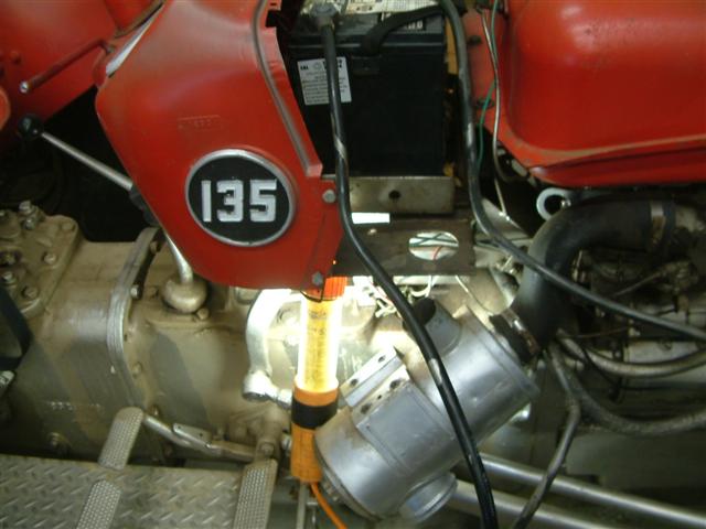

With that generator on your tractor, I doubt it's a 1971. MF went to alternators in 1969 for the 135.

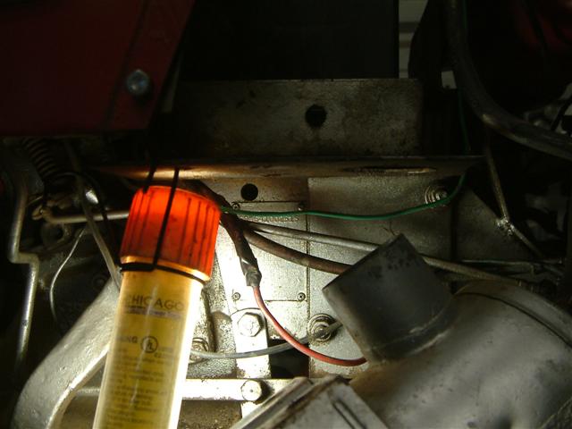

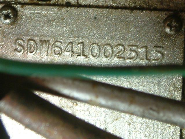

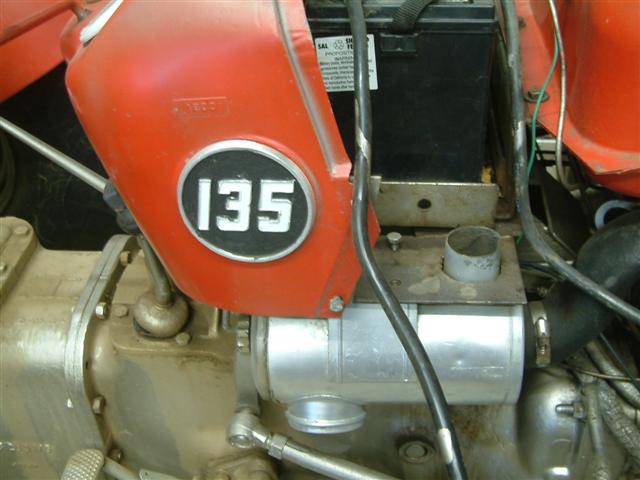

There might be an ID tag on the right side of the battery tray (that's where I found it on my 135). You need to remove the air filter assembly to see it.

Man flusher, they dont want you to find that serial number very easy do they? lol. I wonder if, even though I have a serial number tag on the dash, if there is also a tag under the battery like on yours. Guess I'll take a look seeing as I dont have an oem air filter assembly on the tractor it will be easy to spot. TB

Yep, you're right--it's really located in an inconvenient spot.
As you can see I inadvertently sprayed over the tag when I painted the tractor a few years ago. Dumb. But the important info, the s/n, is embossed on the tag so it's still easy to read.
   / Just got my first tractor: '71ish MF 135 Diesel #9
Flusher, I actually had some pictures of that area on mine when I had it apart. There is no tag there, its pretty rotted out, but no signs of there ever being a tag there. I guess they decided to move it by 1971. TB
