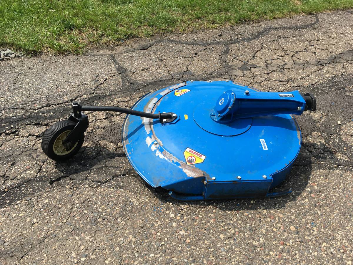

Be very careful with that rotary mower. It is the reason BCS redid their PTO. You can buy a breakaway blade kit if it still has the solid blade, and that will help. Otherwise it should not be used in any areas where there's a risk of hitting unmovable objects. It can twist, strip, and break your spline PTO.
If you want to expand that tiller to 26", PM me. I have several broken BCS tillers here and I could sell you some used extension hubs pretty cheap.
   / Just picked up a used BCS 737 how did i do? #13
Not only that, but I have seen several cases where the transmission housing has cracked, I think due to straight blade hitting something solid. The breakaway/hinged blade kit is a good option, unless you are only cutting pasture/grass/weeds without any rough stuff.

Thanks all for the info on the breakaway blades. I'll keep it in mind if I ever need to take the thing brush hogging. As it is I will probably use it to mulch up leftover crop residue to allow for tilling, and I assume the current blade is thinner than the breakaway and probably better suited for that task. Either way I won't be encountering any surface rocks in my vegetable beds. It'd be nice to have a flail, but of course those babies cost more than I paid for the bcs! So I'm farming old school, make do with what you have.
