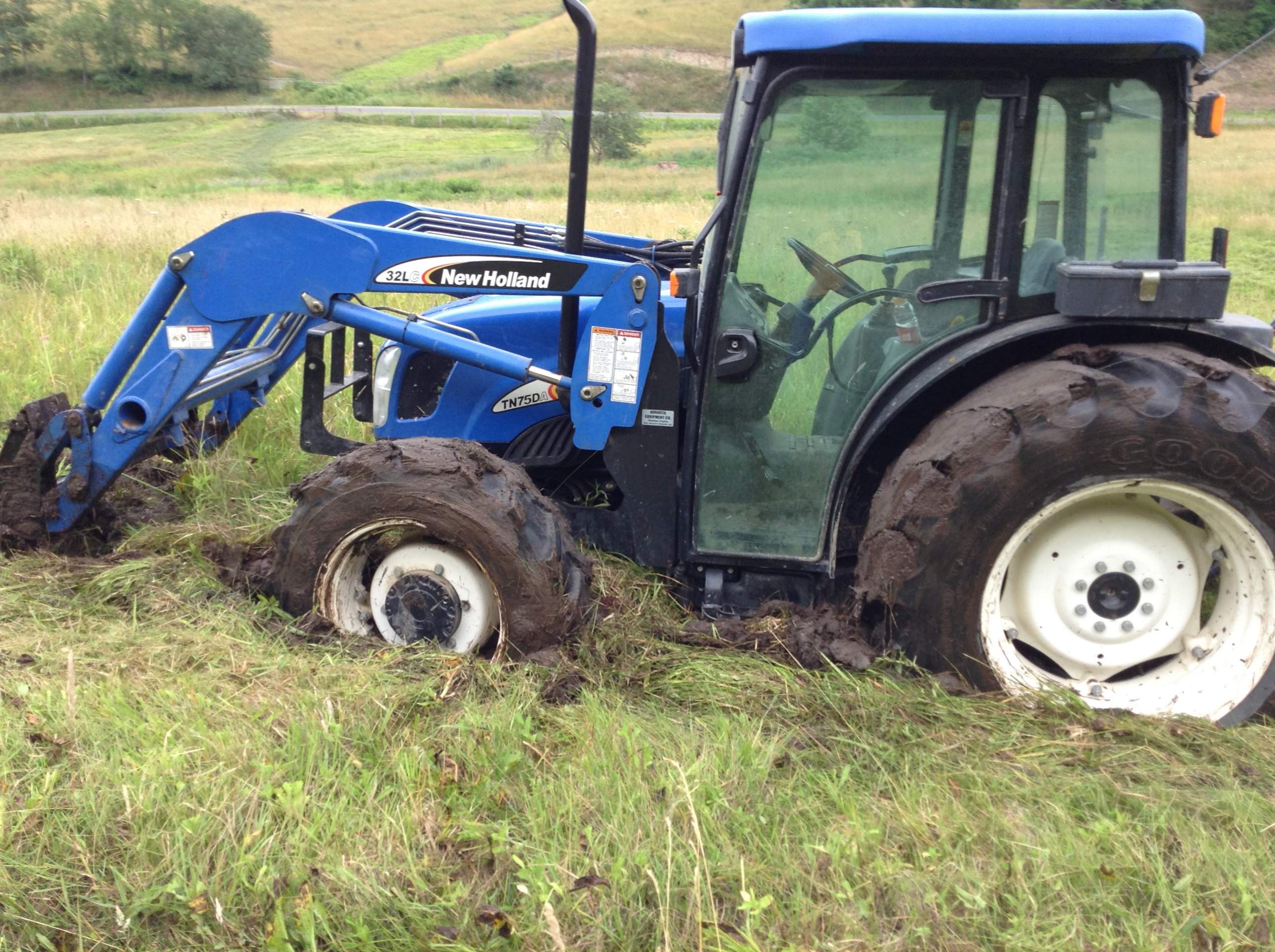

However, if you're mowing where the ground might be soft, and getting stuck is a possible concern... might be safer to keep the loader on in case you need to dig yourself out
