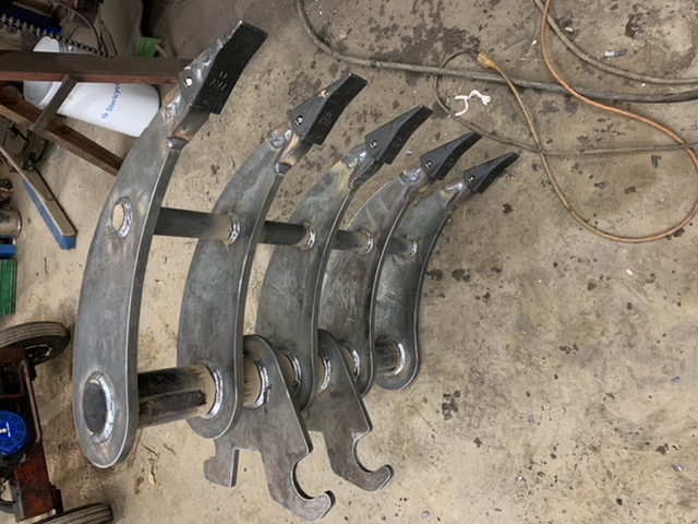

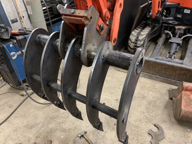

I have a Kubota KX91-3 I am building a root rake, a ripper tooth, 14 inch bucket and a trapezoidal bucket for drainage. Anyone else out there have plans for any other attachments? any ideas? Do痴 and do nots! I have also been thinking of a mower head. E90CE8BD-137E-43E6-80B9-F859AA116571.jpeg0FFE1911-3231-411B-81DB-2E04AE21A0F1.jpeg

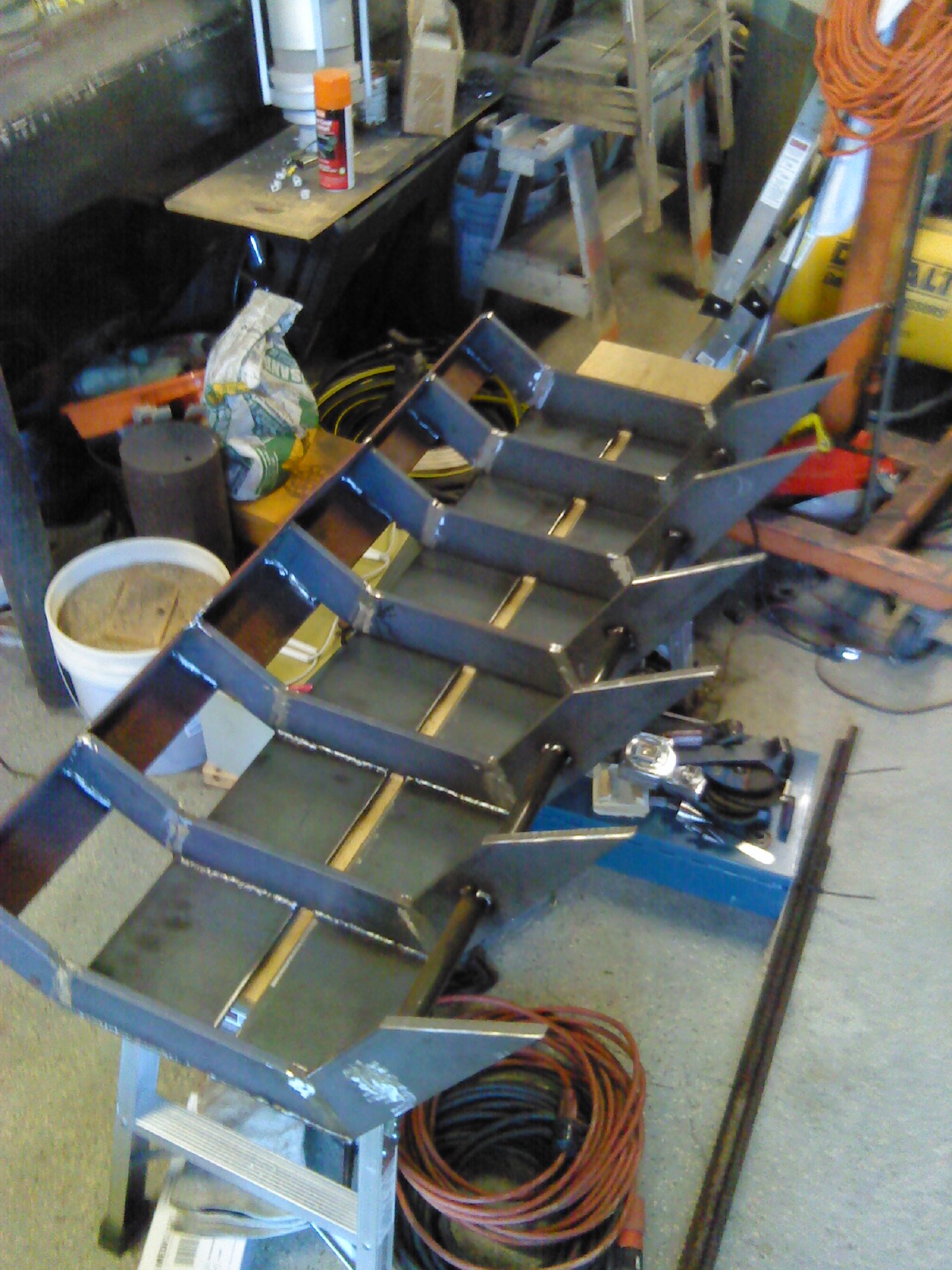

About 7 years ago I built a root rake type bucket thing. I did not take into account the total weight of the metal. And the fact that my little Kubota B7100 has a lift of only 500 lbs.

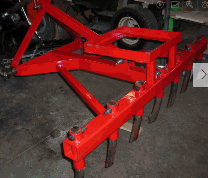

Made this 4-5 years ago when I had my Jinma, it would pull some nasty roots. The tines are removable in case I came up against something I couldn't moverake.gif

Nice work!!! Looking forward to anything else you build. Quality fabrication!!!!

I have a Kubota KX91-3 I am building a root rake, a ripper tooth, 14 inch bucket and a trapezoidal bucket for drainage. Anyone else out there have plans for any other attachments? any ideas? Doç—´ and do nots! I have also been thinking of a mower head. View attachment 642165View attachment 642166
Looks great! How did you cut these, CNC plasma? Care to share the CAD drawings of the quick attach bucket mounts? A DWG or IGES file works.
   / Just wondering if anyone is building attachments and would like to share plans?
Yes for sure I will share the files, cnc plasma cut the plates just for repeatability,
Started with a cardboard trace of the QA drew it in SW had local metal shop cut them out, made the ripper tooth yesterday
Hopefully I’ll finish welding it this morning and post a few pictures, thanks guys.
