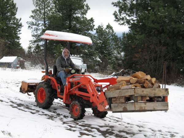

Back surgery earlier this year became the justification for getting my Kubota. Attached is my answer for getting the firewood from the shed to the house - instead of the garden cart that I used before. And then all the other projects started poping up. Seat time is so enticing. /forums/images/graemlins/laugh.gif After reading all about the flipping and rolling I now keep the load a lot lower to the ground. The first time I loaded up I did not have the tiller on and I was able to lift a back wheel off the ground. /forums/images/graemlins/shocked.gif Adrenaline Rush! When they delivered the tiller they also moved the back wheels wider, which helped also. Thanks to all the TBN folks for the ideas, warnings, fun stories and good humor! /forums/images/graemlins/wink.gif

</font><font color="blue" class="small">( After reading all about the flipping and rolling I now keep the load a lot lower to the ground. The first time I loaded up I did not have the tiller on and I was able to lift a back wheel off the ground. )</font>
The loader looks pretty high in the picture. Are you carrying it lower now or is that your new lower height?
I'd travel with it right down at ground level....just high enough to clear any bumps. If there is an obstacle in the way, raise the loader to clear the obstacle and then lower it back down again.

You'll be more stable and get more seat time if you just leave the crate off. The bucket works fine, just with smaller loads. I take two or three trips to fill the wood box at my place. I could use the carry-all, but more trips = more seat time. /forums/images/graemlins/laugh.gif

I carry it lower now - and with my hand on the stick.
