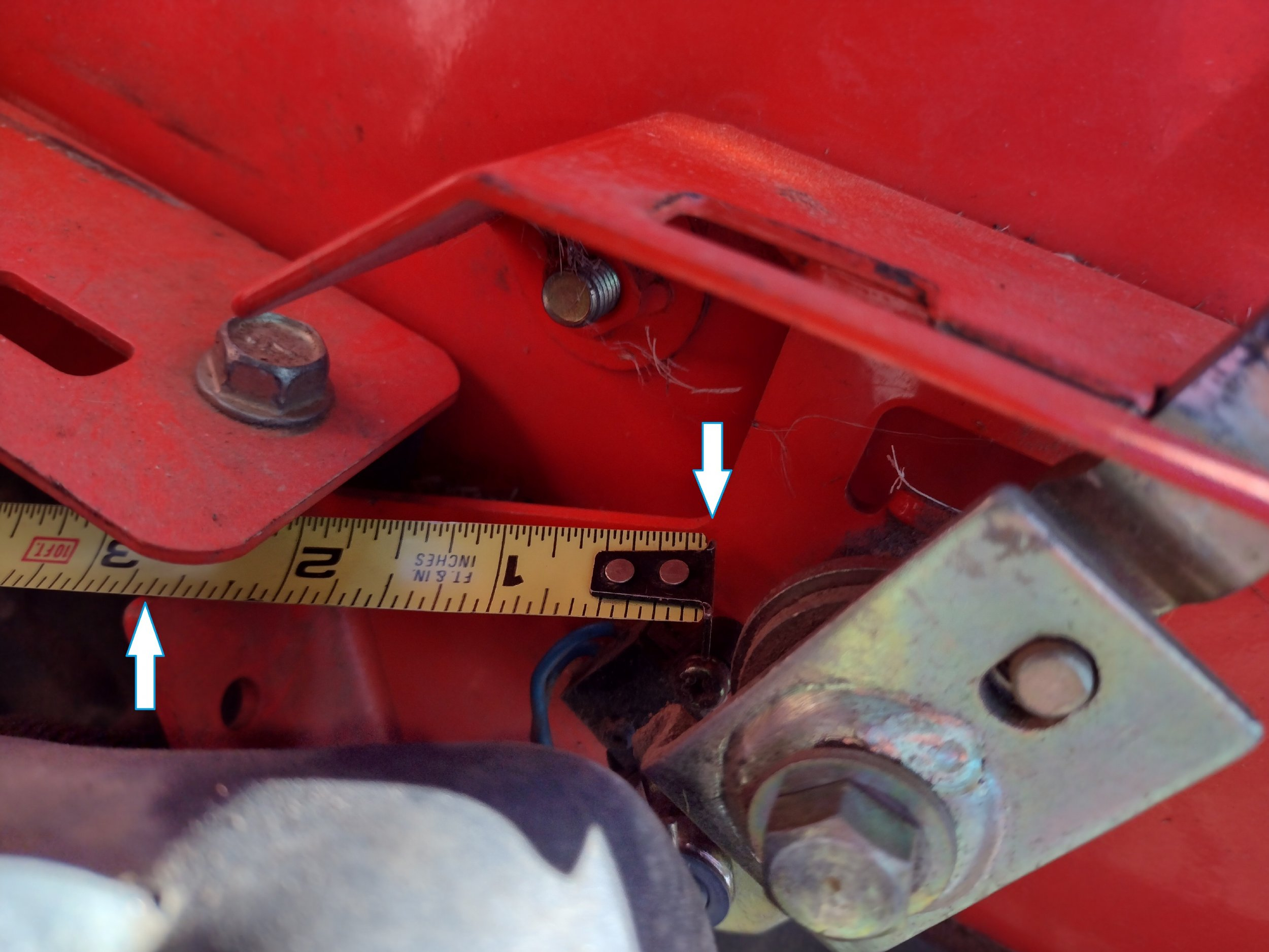

Anyone has a solution for this cable I will have changed twice when the dealer receive it next week. Not very fun, I was working in the wood, tried to engage the pto to winch some fir logs, nothig …

Is your cable breaking? Where? tractor side or the lever side? You should have the correct pto lever with the L3800... earlier versions of the L3400 were too short and would bend / kink / break the cable.
Once I replace the pto lever to the longer version, I have not had any more problems (12+ years)

If I understand your point, I’d say it breaks lever side. How to know if I have the correct version ?
   / K L3800 PTO poor pto cable #5
I can measure them in the morning for you... really, this was an earlier problem that was fixed on the model just before the L3800...
Only other thing, is you need to lube the cable (inside) and lube up the spring that is on the outside of the transmission (?) (tractor body)... photos in the morning...

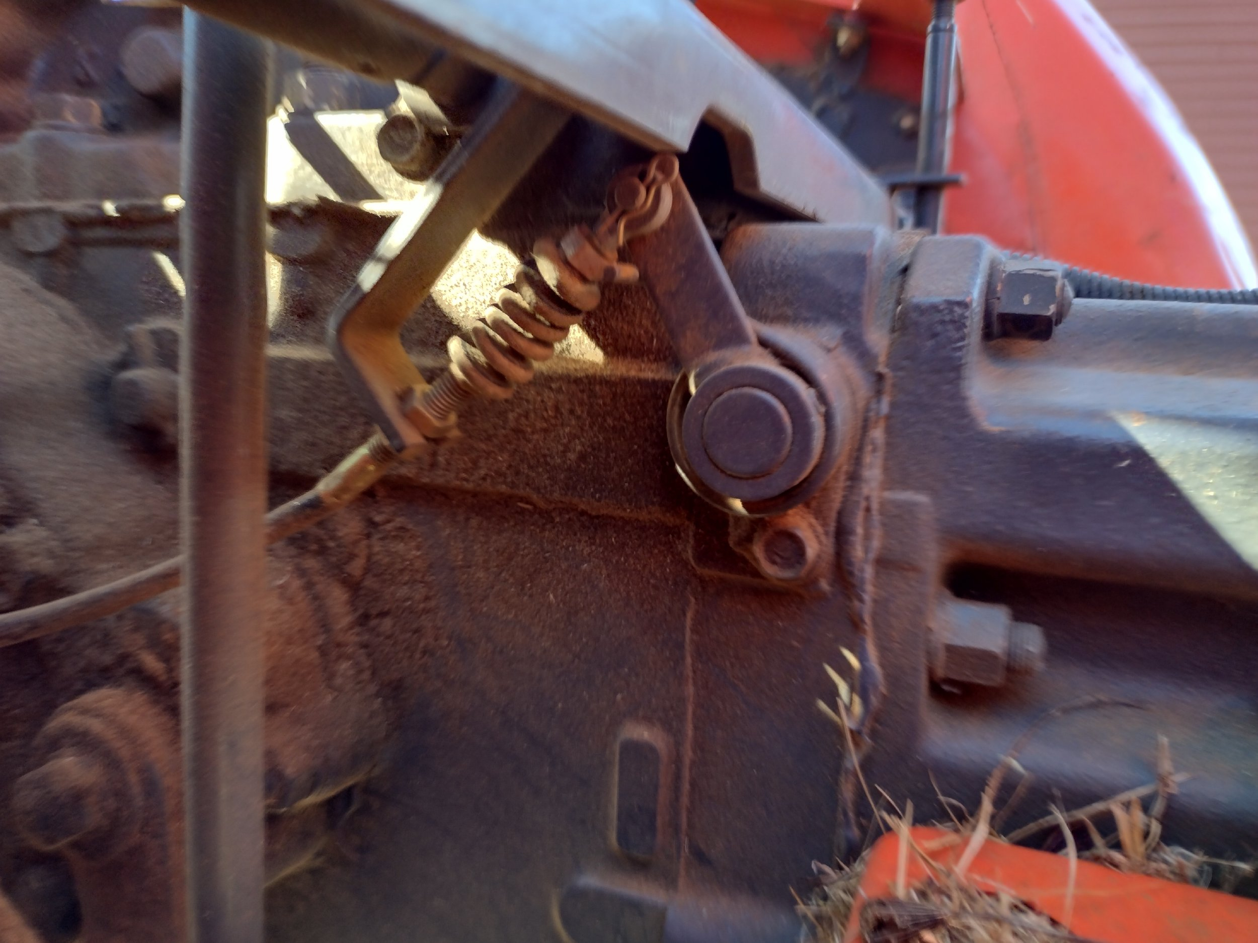

The lever at top shouldn't be the problem. The lower spring, if it doesn't move freely can kink the cable. It's behind a shield and hard to blow off. My shield was only on the tractor for a month before I removed it...
Thank you very much, I appreciate a lot.
