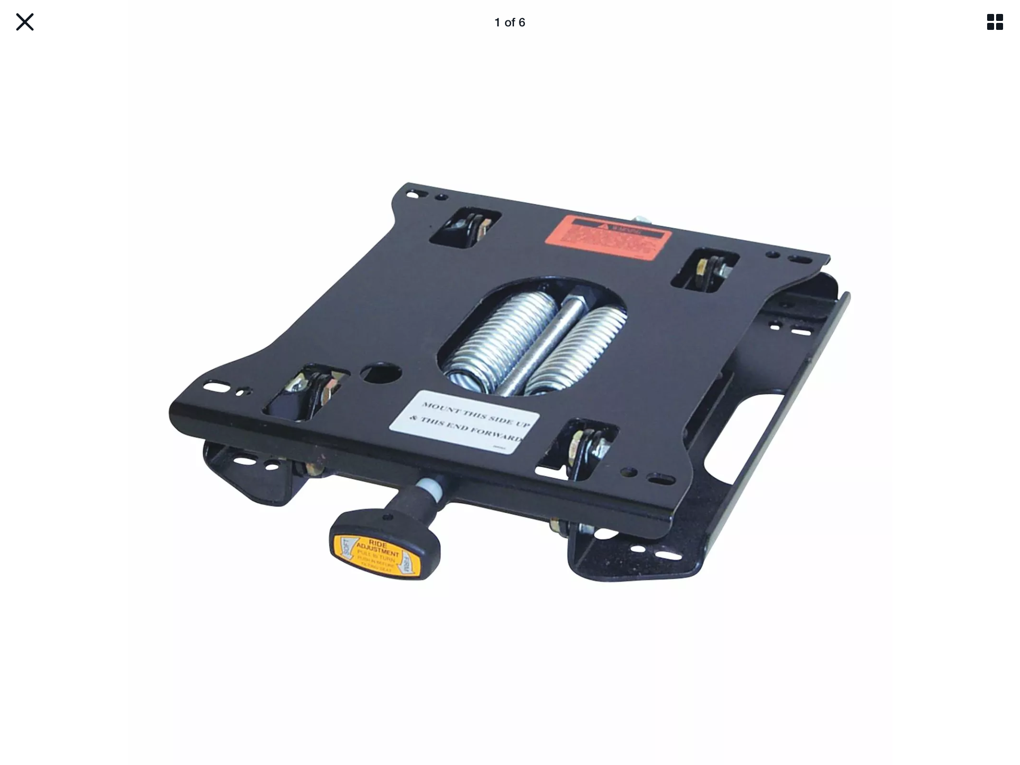

Just installed a K & M Low- Profile Mechanical Seat Suspension Model# 6081 from Northern Tool.
It works great on the PT425. Makes the seat a few inches higher but it rides much better.
Added high is not a problem.
I can still lower it by drilling two new holes in the diagonal support 1 down and remounting.
I had to install it upside down to make it fit better but it still worked fine.
MUCH nicer driving around without feeling like my kidneys are under attack.
I was surprised!

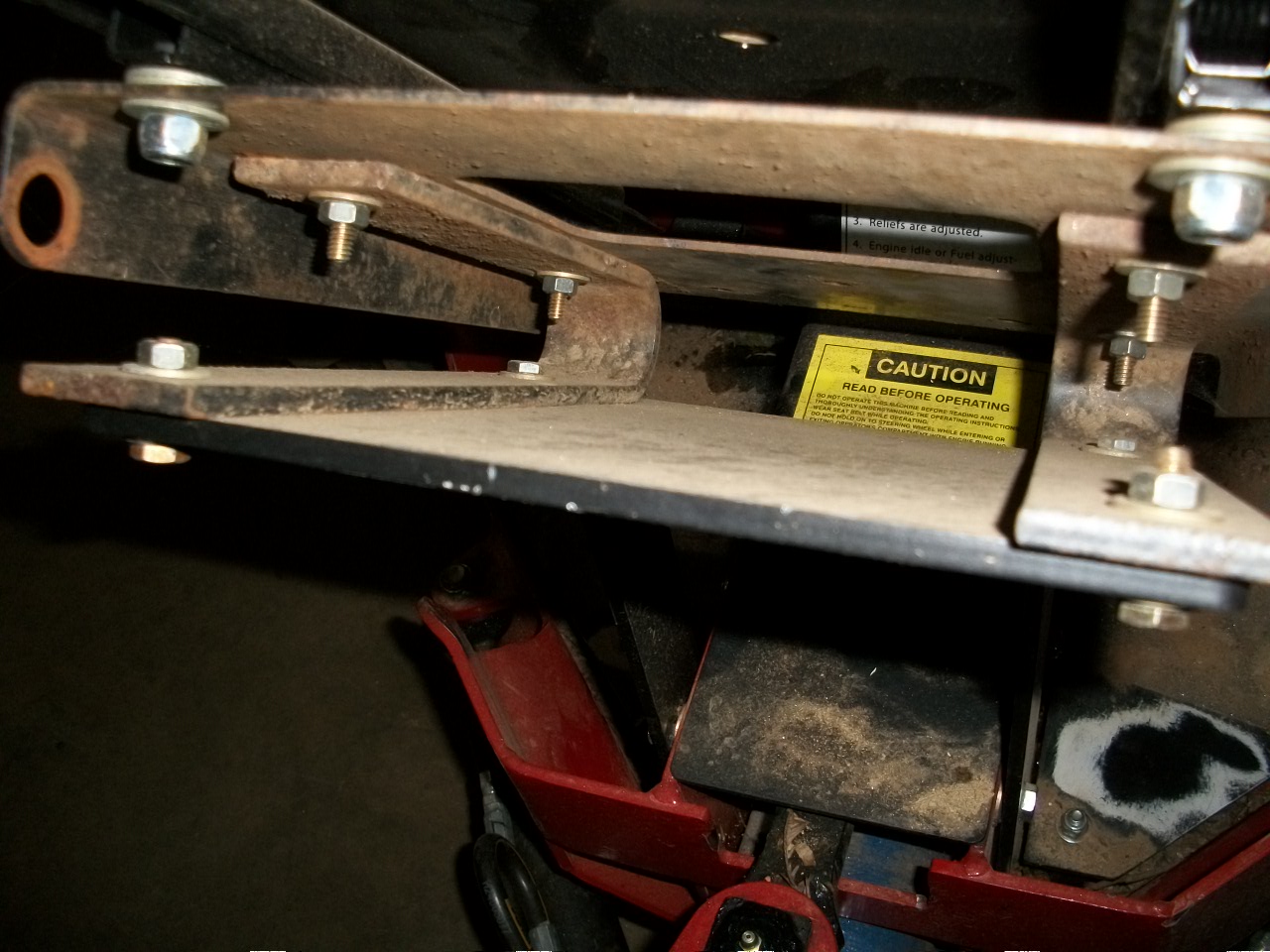

I built one out of old garden tractor parts.
