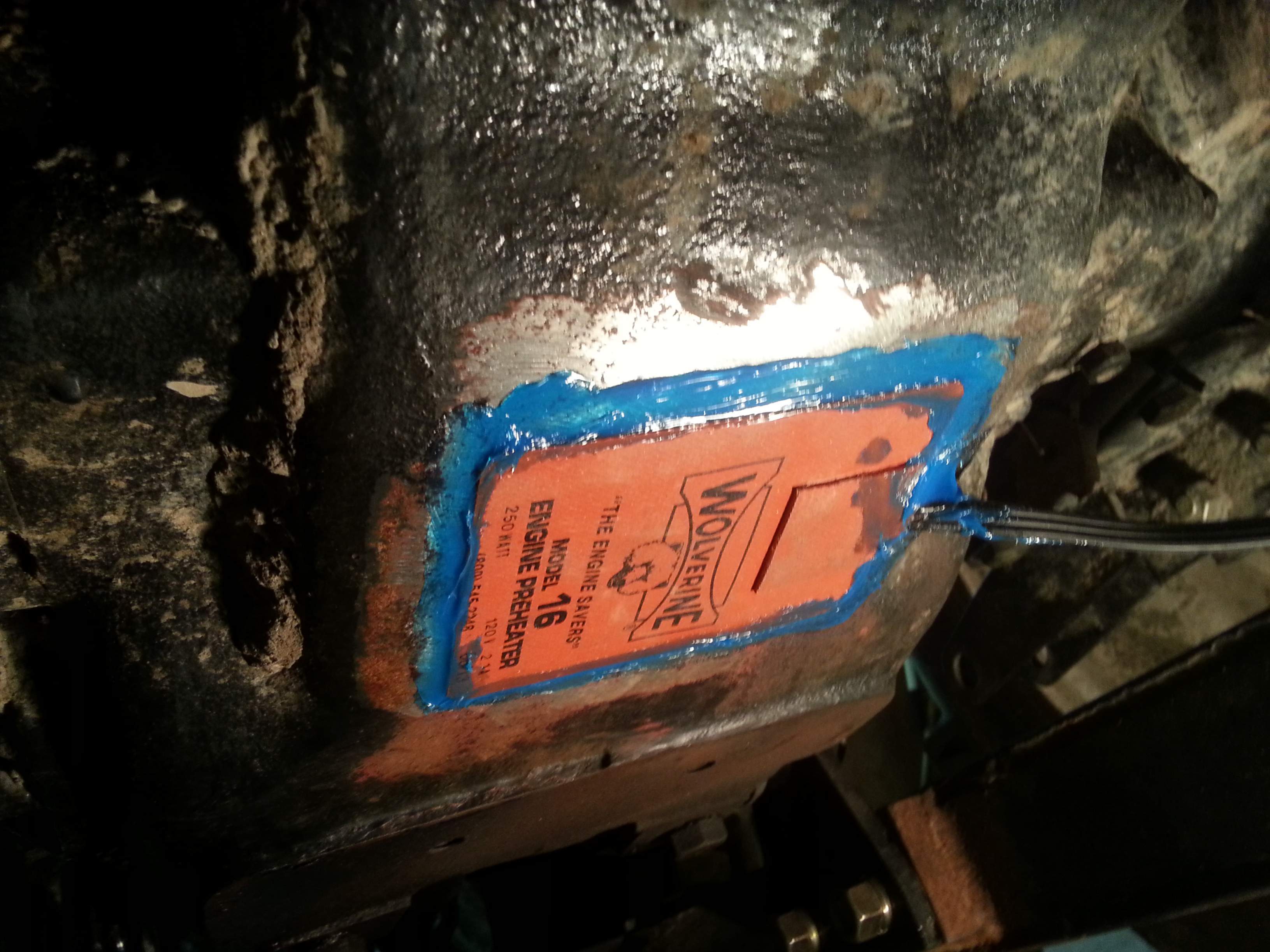

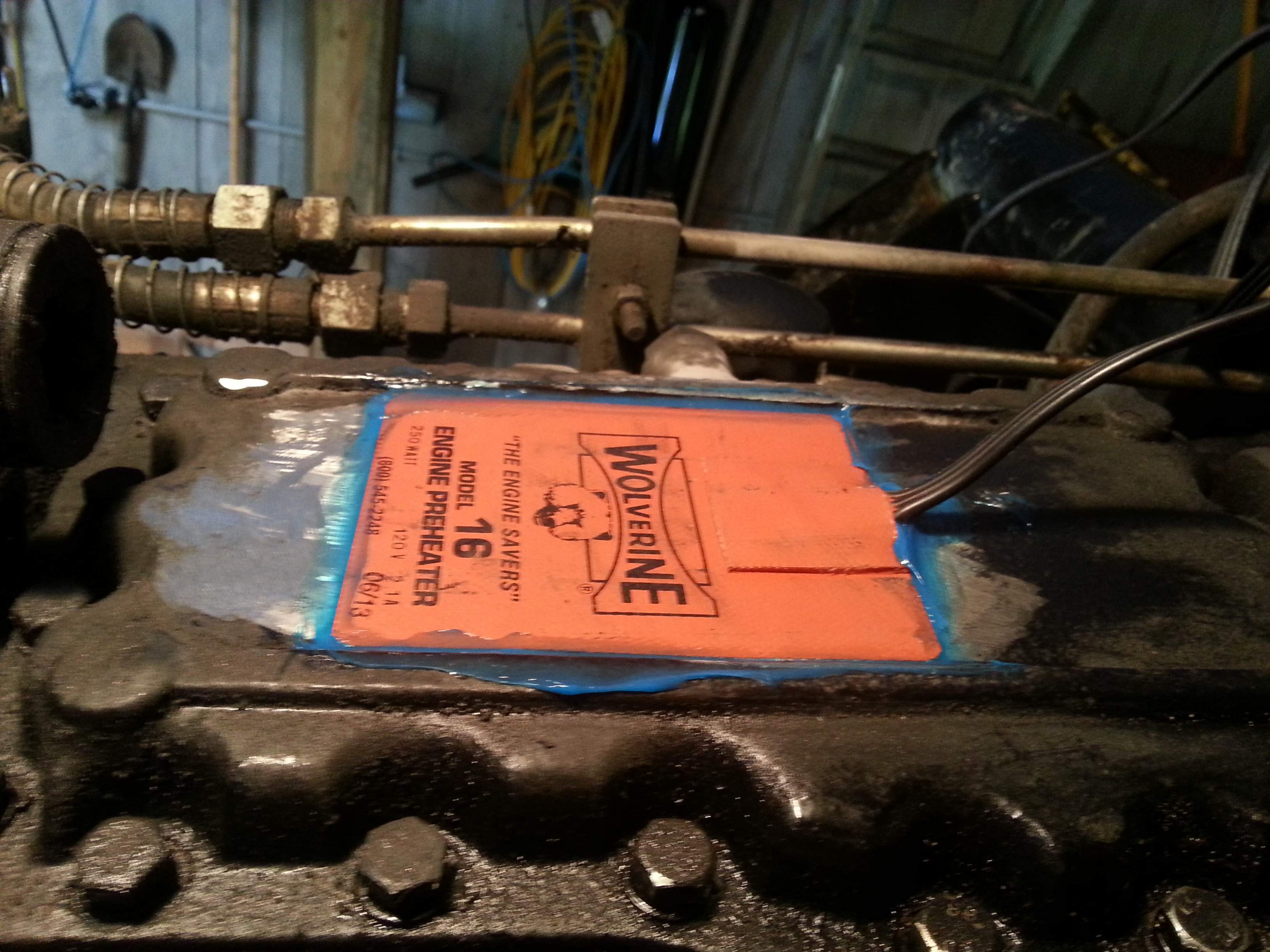

I don't have a KAMA and have not used freeze plugs but my experience might be helpful (Jinma 284). I used KATs lower radiator hose heaters for years with good luck. Someone on this forum recommended Wolverine heating pads for years and I think it was either Greg or Bob Rooks.
I took the plunge this summer and installed two of these heaters: One is on the cast iron oil pan and the other is under the rear transmission, close to the hydraulic sump. This is my first winter so my experience is limited; however, it makes sense to heat the bottom of the oil pan and let the heat rise. Now I don't have to wait for the three point to lift up my 64" snow blower. With the oil and hydraulic fluid pre-heated, everything is off to a better start.
